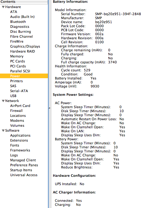

here's what the battery info says:
**sharp intake of breath**
well theres your problem...

From that I believe it's most likely a faulty/worn out battery.
Charger is OK as it's powers the machine. Other than that it's the the power circuitry on the main logic board.
Can you get someone else to test the battery?
Different battery, same charger.
Would have to be a plastic Macbook of similar age. Maybe ask at the Apple Store?

The same happened to my macbook with a fairly good condition battery. Unfortunately the only solution is a new battery.

It is a defective battery. Dont try anything else because it wont work.
