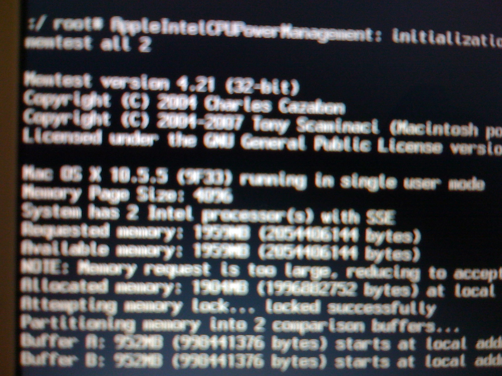

As far as the memory test goes. Are there any specific ways i can do this? google-ing around, i came across this:
http://www.command-tab.com/2008/01/11/how-to-test-ram-under-mac-os-x/
Should i go ahead and try this?

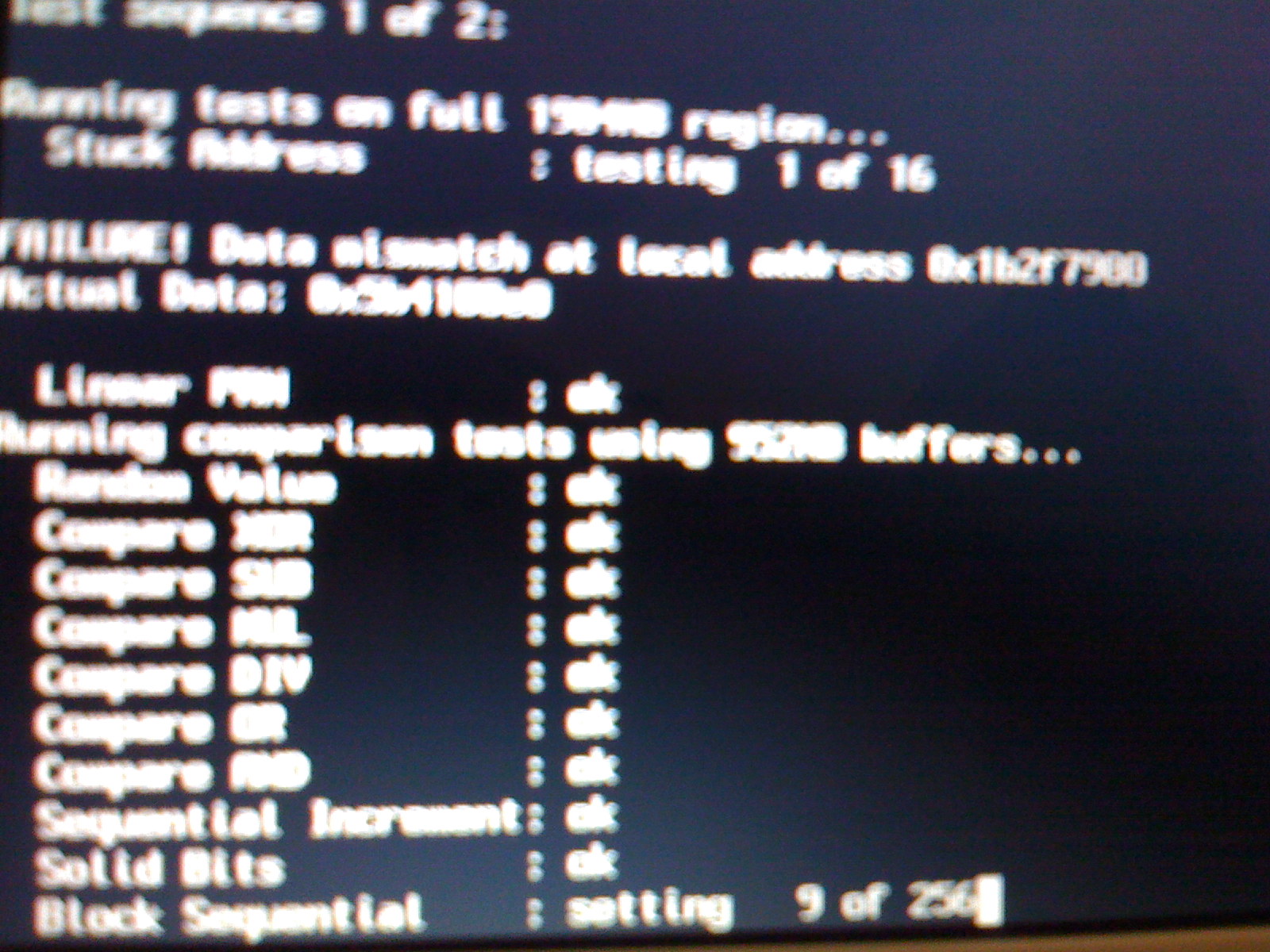

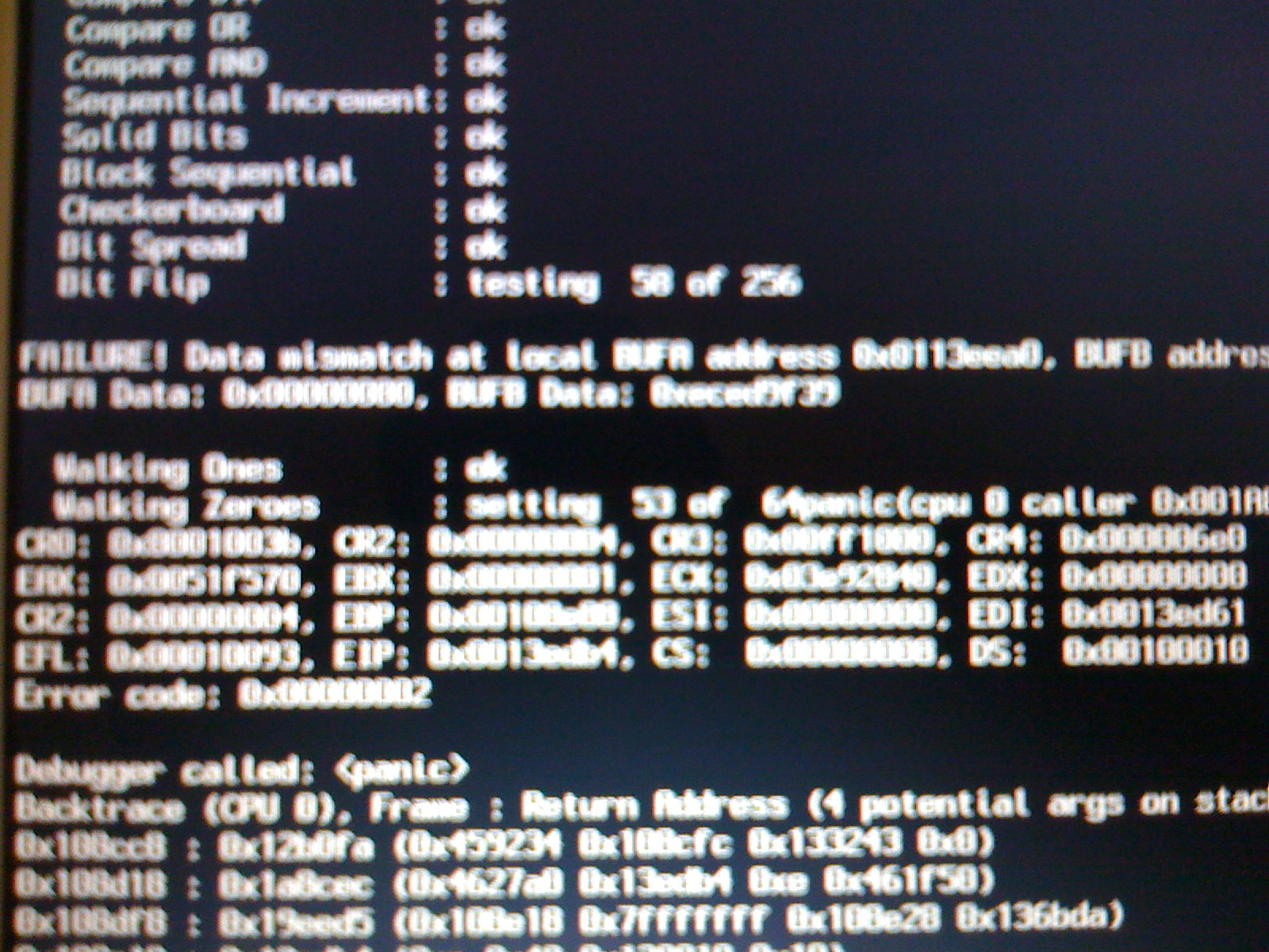

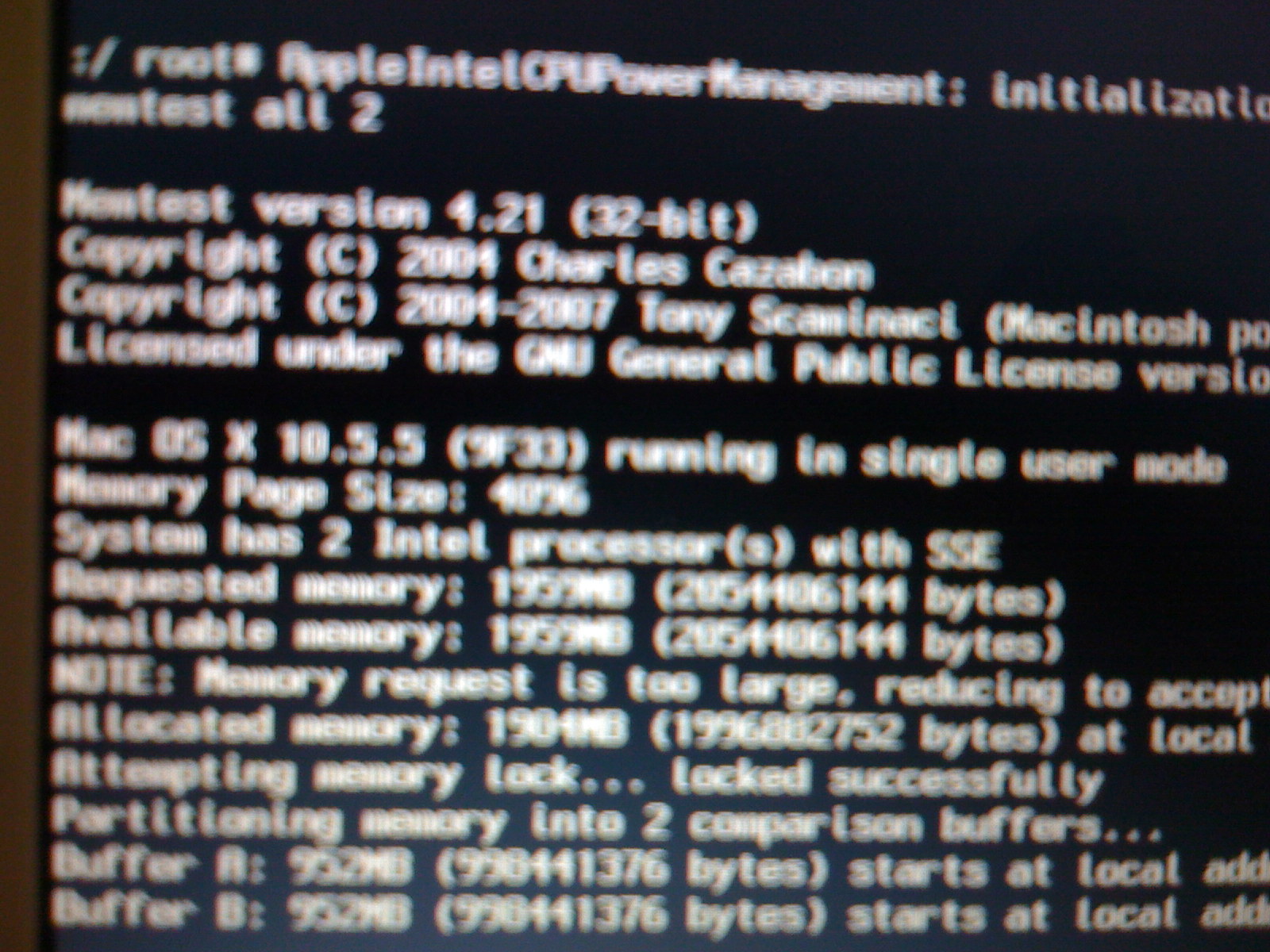

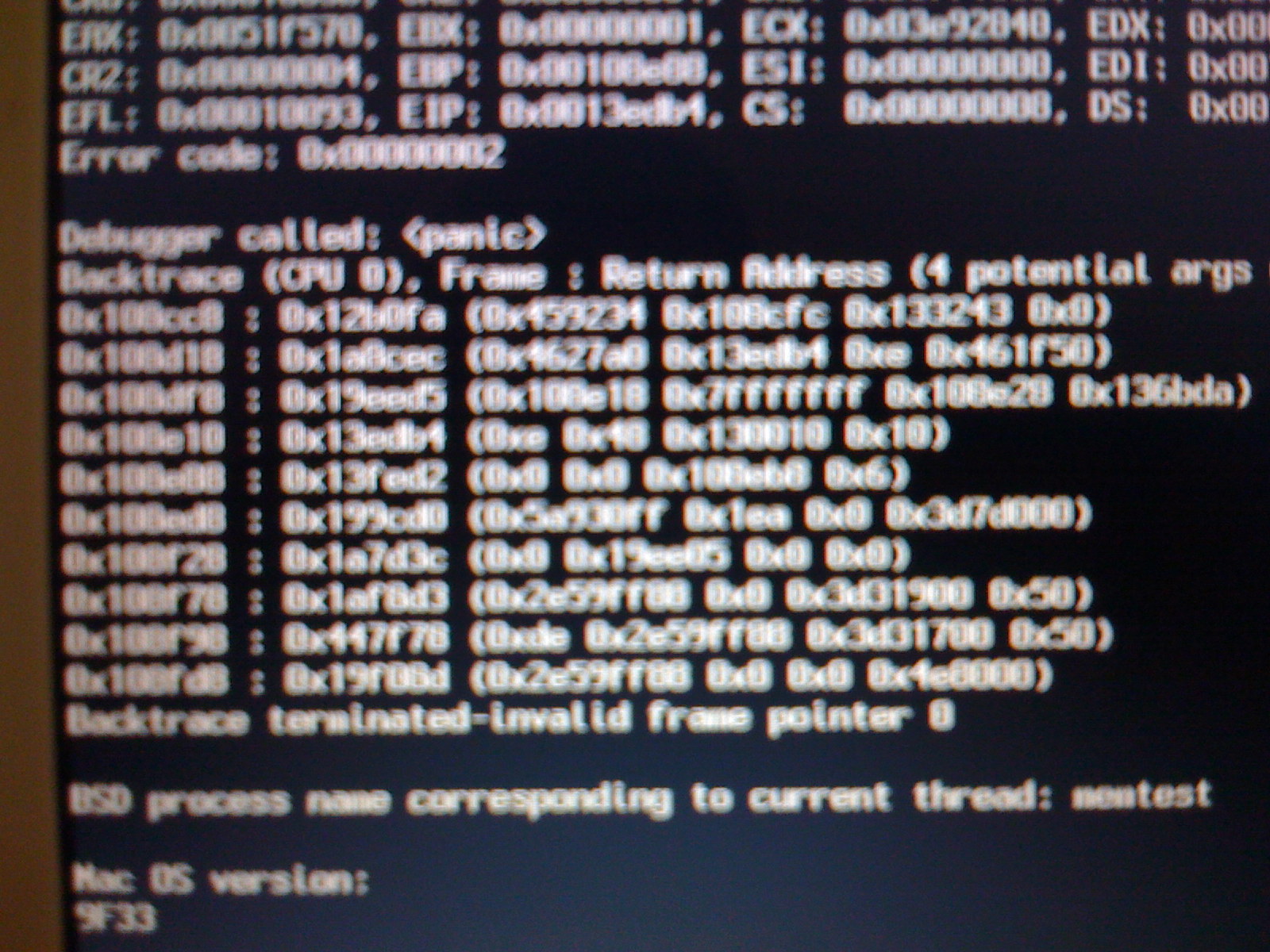

hey guys,
so i ran the memtest, and here are the results. (i took some pics with my phone...so they arent the greatest. But i'm hoping you guys can make something out....)
After the last screen, it just seems to just freeze. i cant type anything and i have to press and hold the power key to shut down/and restart...

Seems like a Kernel Panic in the last screen and that explains why you had to shutdown the computer.
I the other screens I see mismatches, that means Memtest wrote something in the RAM and found a difference when it verified the data.
It's still possible that there is some other hardware problem (motherboard?) but surely you should check the RAM first (the cheaper thing to replace). Did you upgrade it with third party RAM? If you have the old sticks put them back in and try the test again. If you don't get any error try the following: remove one of the current sticks (if you currently have 2) and test that one. Then change the slot and retest. At that point do the same with the other stick.
