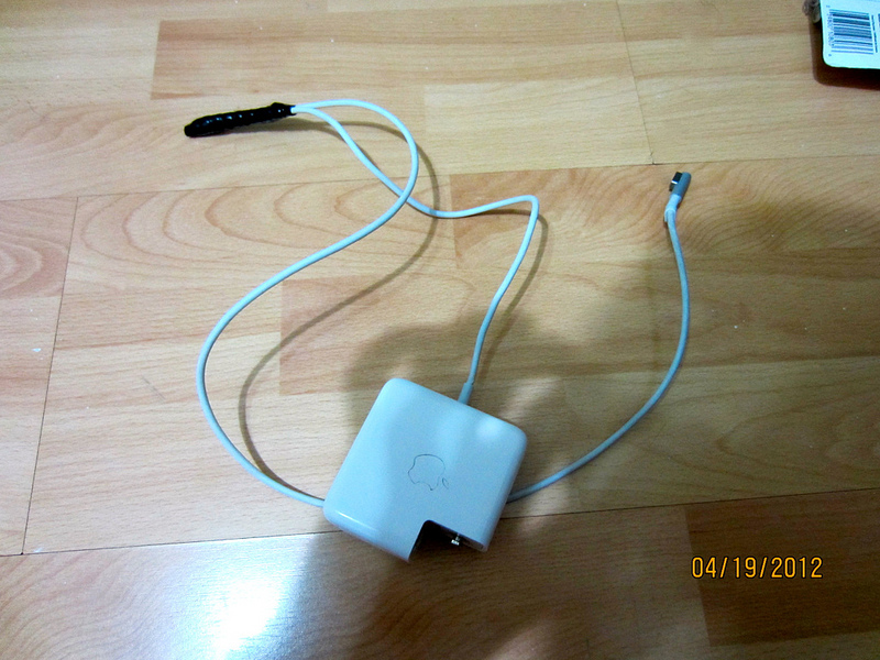

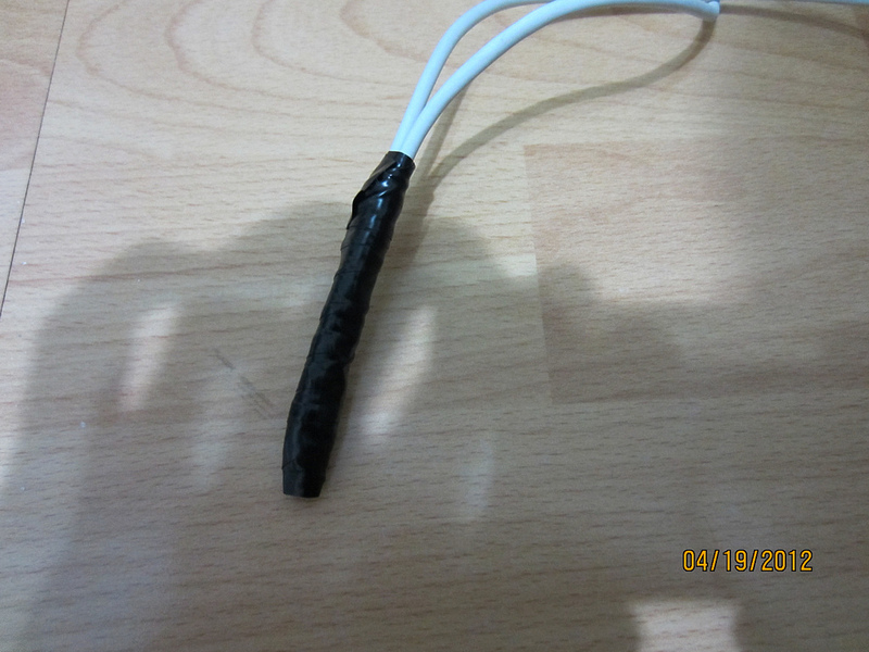

So a few days ago my girlfriend's dwarf bunny went trough my cable. First thought was to get a new cable, but then during free time, with just a cutter and some electrical tape I got to repair it without issues.

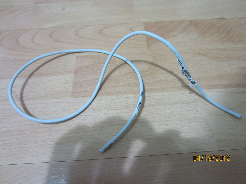

I followed romindstorm advice. I've got the 60W L connector that came with my early 2011 MBP. Only difference with her connector is that the inner treads were all silver. I made a trident with the inner cables, intercalated those and then twist em. I was going to take some pics of the process but I got so much into it that I absolutely forgot about it. It took me some 15 quality minutes.
Its been working perfectly fine and safe for a week now. Here are some pics of the piece of cord I scrapped and of the finished work.
