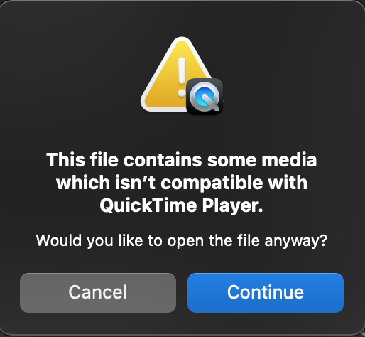

I've just installed Sonoma 14.6.1 and 14.7 on two MacBook Pro 11,3's and then installed Avid Media Composer on both. Media Composer does run properly on both of them however they both have an issue with Quicktime and the DNX Codecs. Avid automatically installs these codecs and there are no issues on my systems that run Sonoma natively. Here's the message that pops up when I try to open any DNX video file. I've even installed the DNX LE Codec pack from Avid and that didn't work either.
Any suggestions or work arounds would be very much appreciated.

If I click continue I only get audio, no video.
I could us VLC but it turns out there’s even more of an issue. Avid greys out most of these codecs and I’m unable to use them for AMA linking, Exporting or Capturing. If I try to AMA link these file it imports them instead of just linking them, which takes forever and essentially doubles the required storage.
