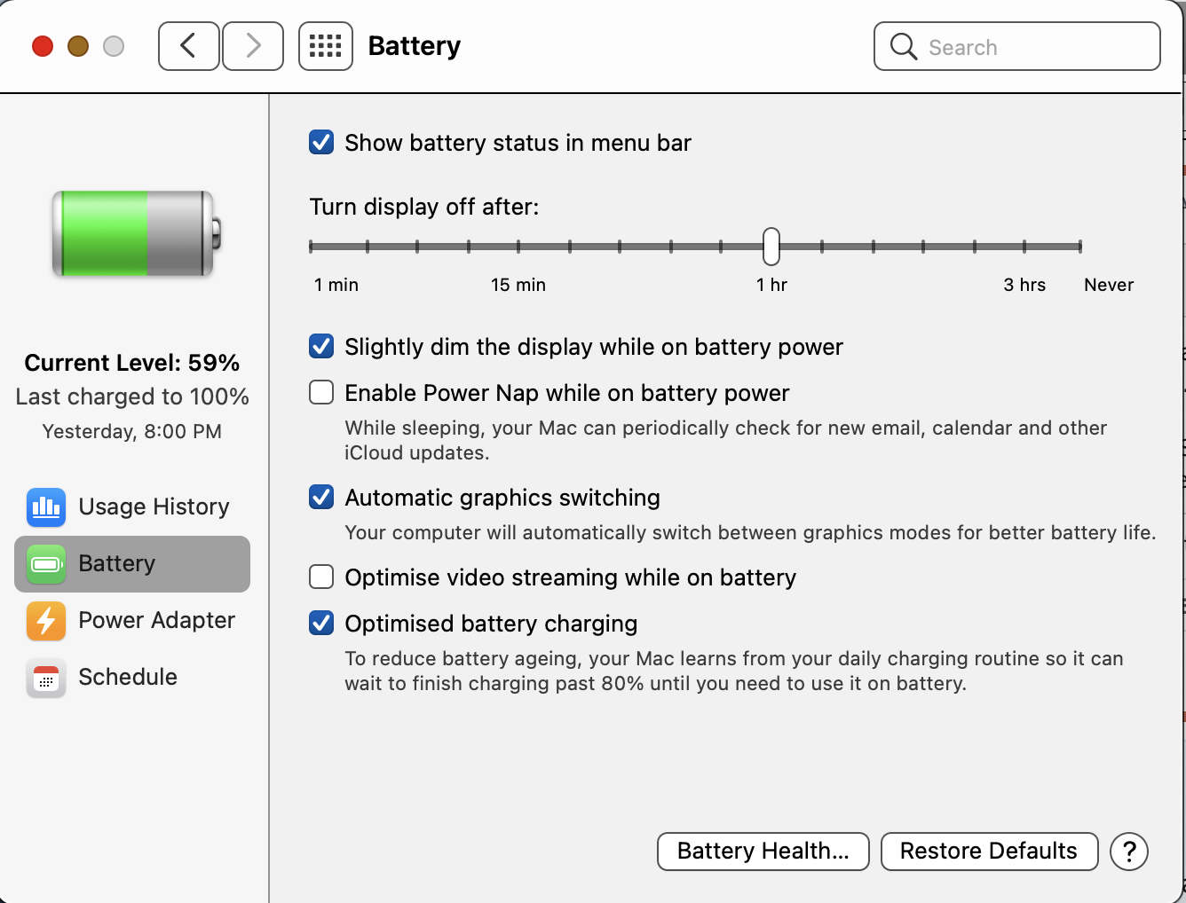

Same here but with MBP 2019 16". Cycle count: 62, Condition: Normal, Full Charge Capacity: 7629.
Update: Last night I did not shut down. Instead I put lid down so it sleeps. Battery status was 91%. This morning when I opened lid, battery status was 61%. Previous night when I shut down it was 100% and when I powered on next morning, it was 1%. This is bewildering because I would expect opposite to happen, i.e. more drainage when powered on. Have attached screenshot of Battery settings in Sys Prefs.
