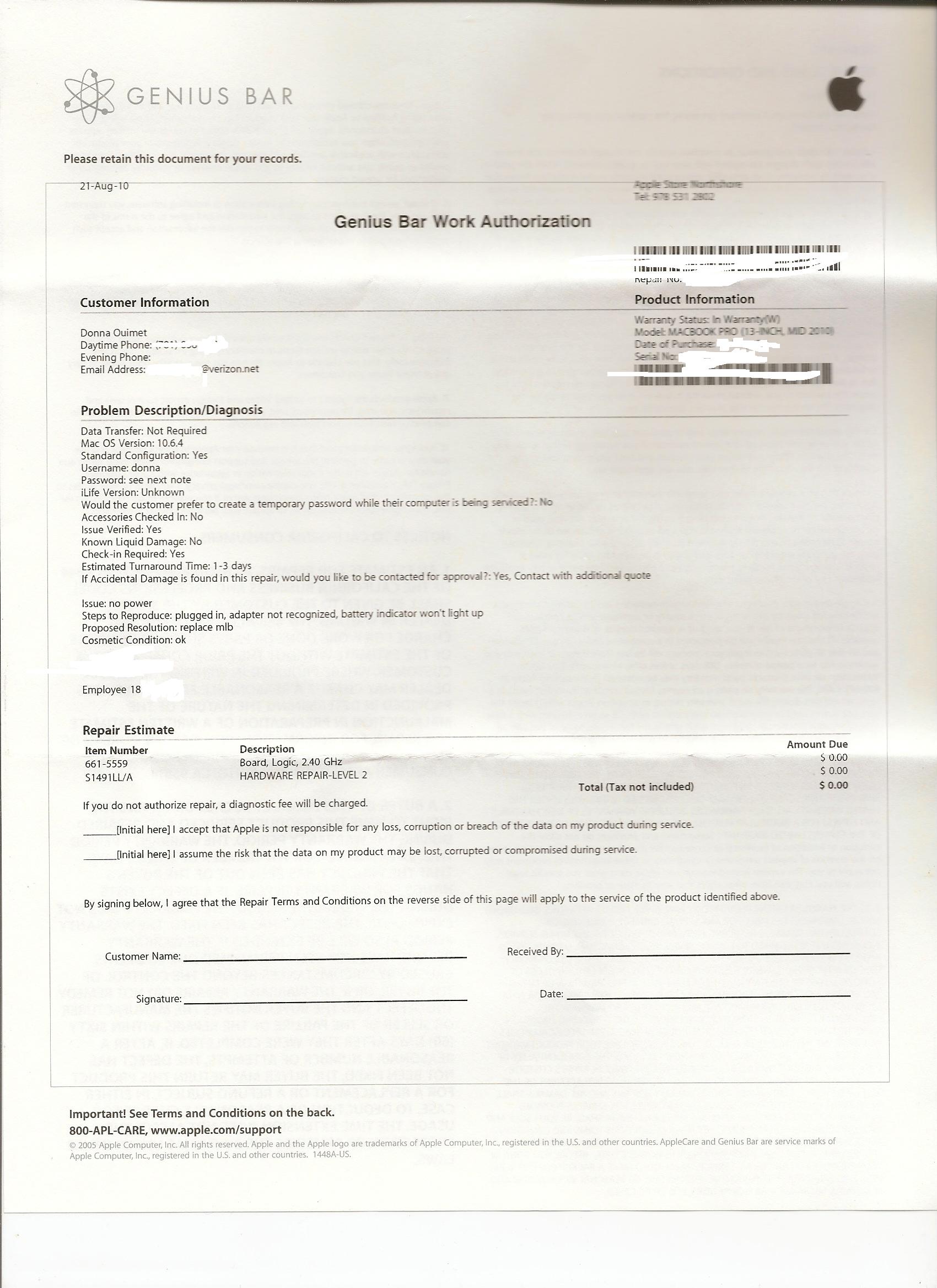

Dead logic board. Brought it to Apple for repair. They have it now. Will take about a week. Good thing this is my mom's computer and not mine. I don't know if i could go a week with out my MacBook Pro. I hope my logic board doesn't fail 4 months down the road like hers did. I will keep you posted on this repair.
