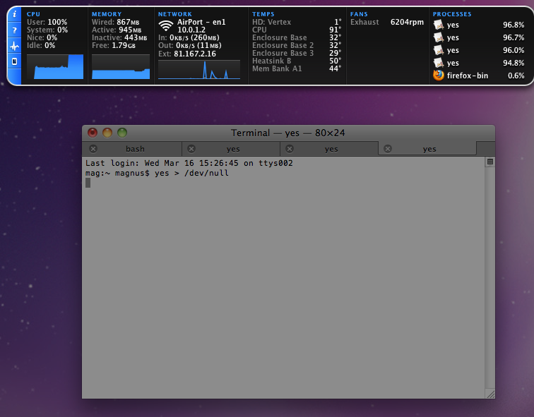

If I run 4 terminal processes with
Code:
yes > /dev/null
i get the fan to go to 6200rpm and the temp stabilizes at 91-92 degrees:
I tried with only 2 terminal processes (using 50% cpu) and still get around 91 degrees.
Can someone post their stats to compare if my machine is running hotter than normal under full load?
