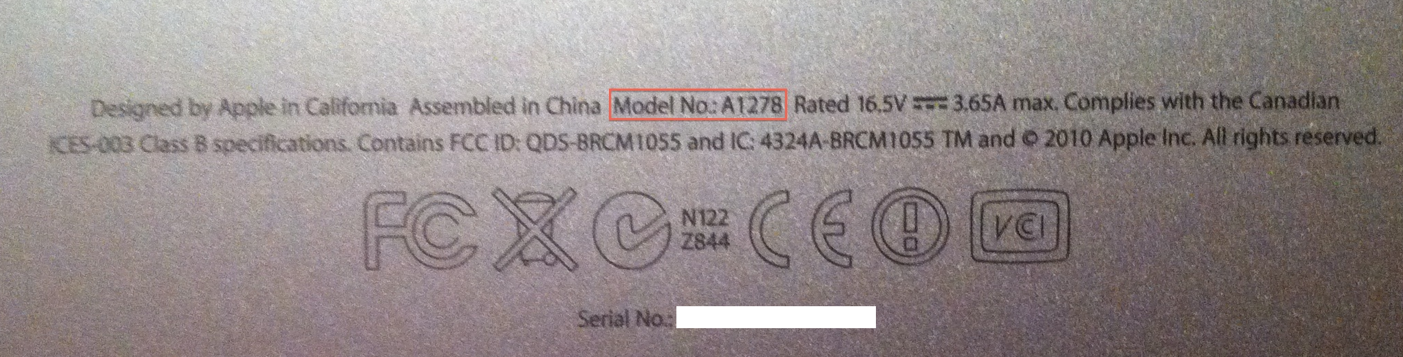

Thanks buddy. Do you or anyone else in here know what the difference between the a1278 and the a1384? I can't seem to tie either one of those model numbers to my serial and I removed the LCD earlier today (really not that hard if anyone is thinking about performing this replacement), but the LCD does not have either of those numbers written on it anywhere. My macbook pro is a 13 inch mid 2009 just to reiterate. So...a1278 or a1384???
It should be on the bottom of your laptop (see attached photo).
