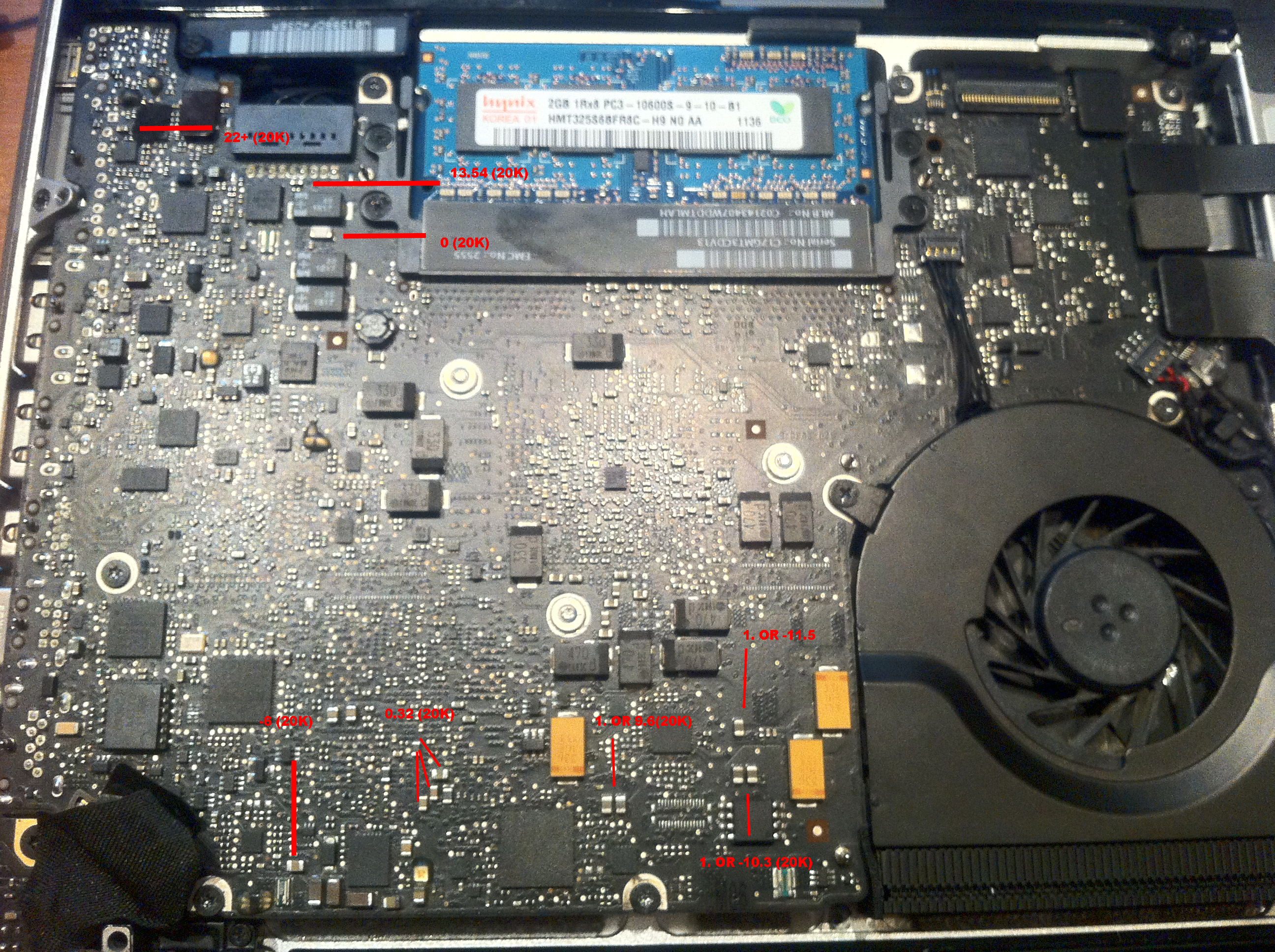

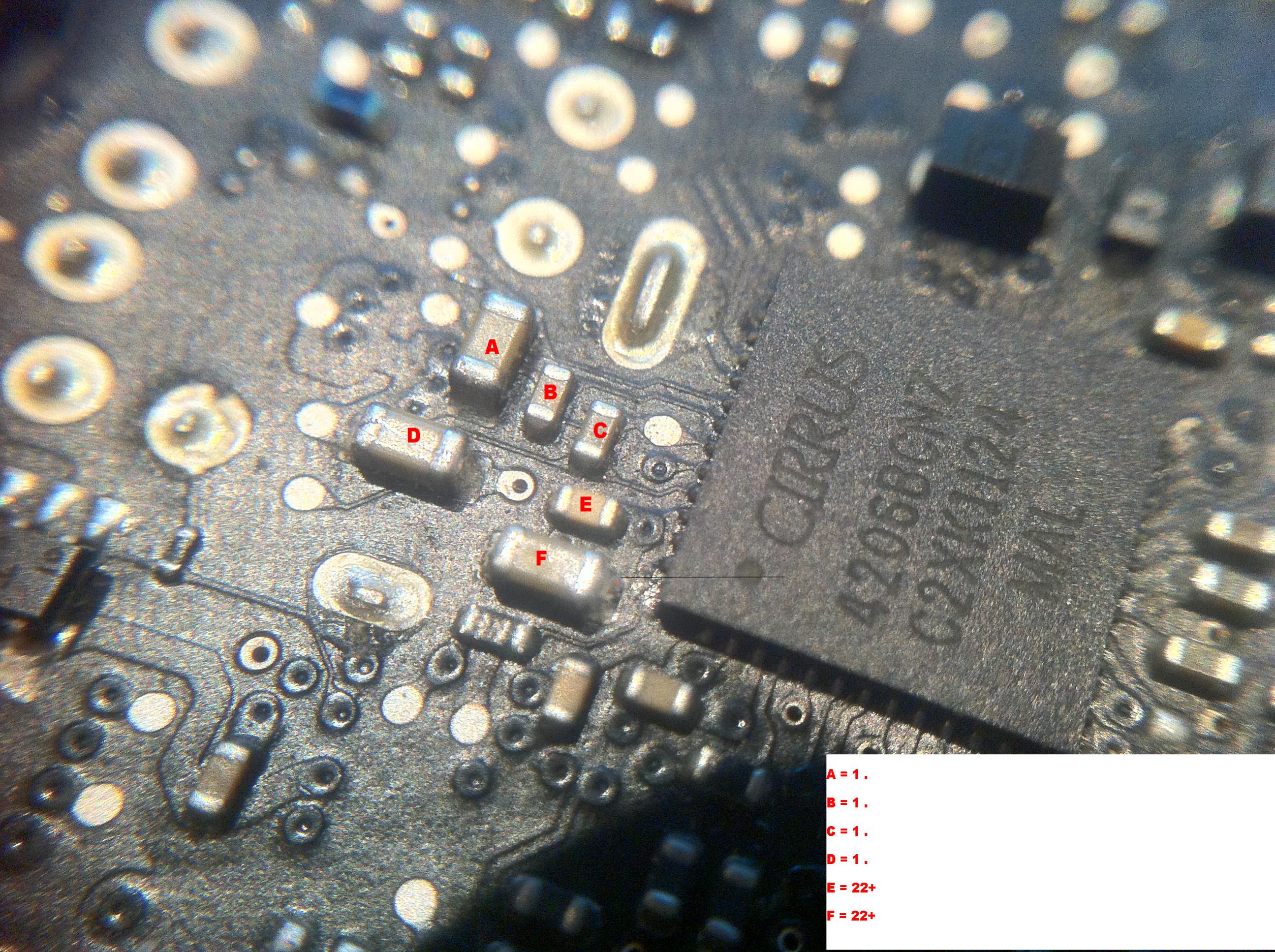

Update
i just tried to turn it on with bypassing the smc ..
it works ok as far as i think even with battery connected..
but fans a driving crazy!
also i used my multimeter when mb was connected with battery and i got the numbers in the image shown above..
i think some fuse is bad ..
*where it says 22+ it just going up and up the multimeter..
* where it says - its just coz if i change the polarity i get 1.
i'm not an electronic engineer 🙂
please help!

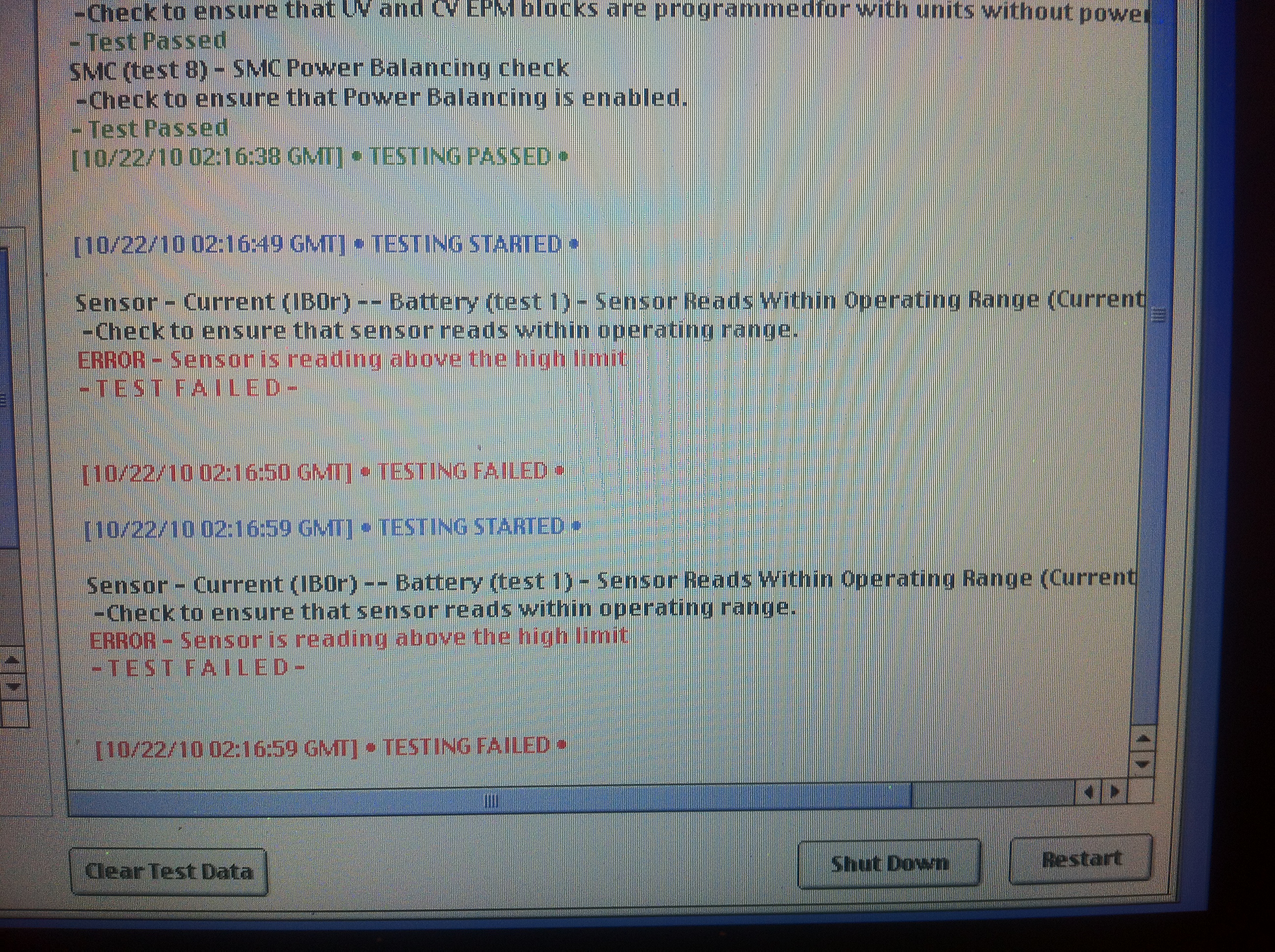

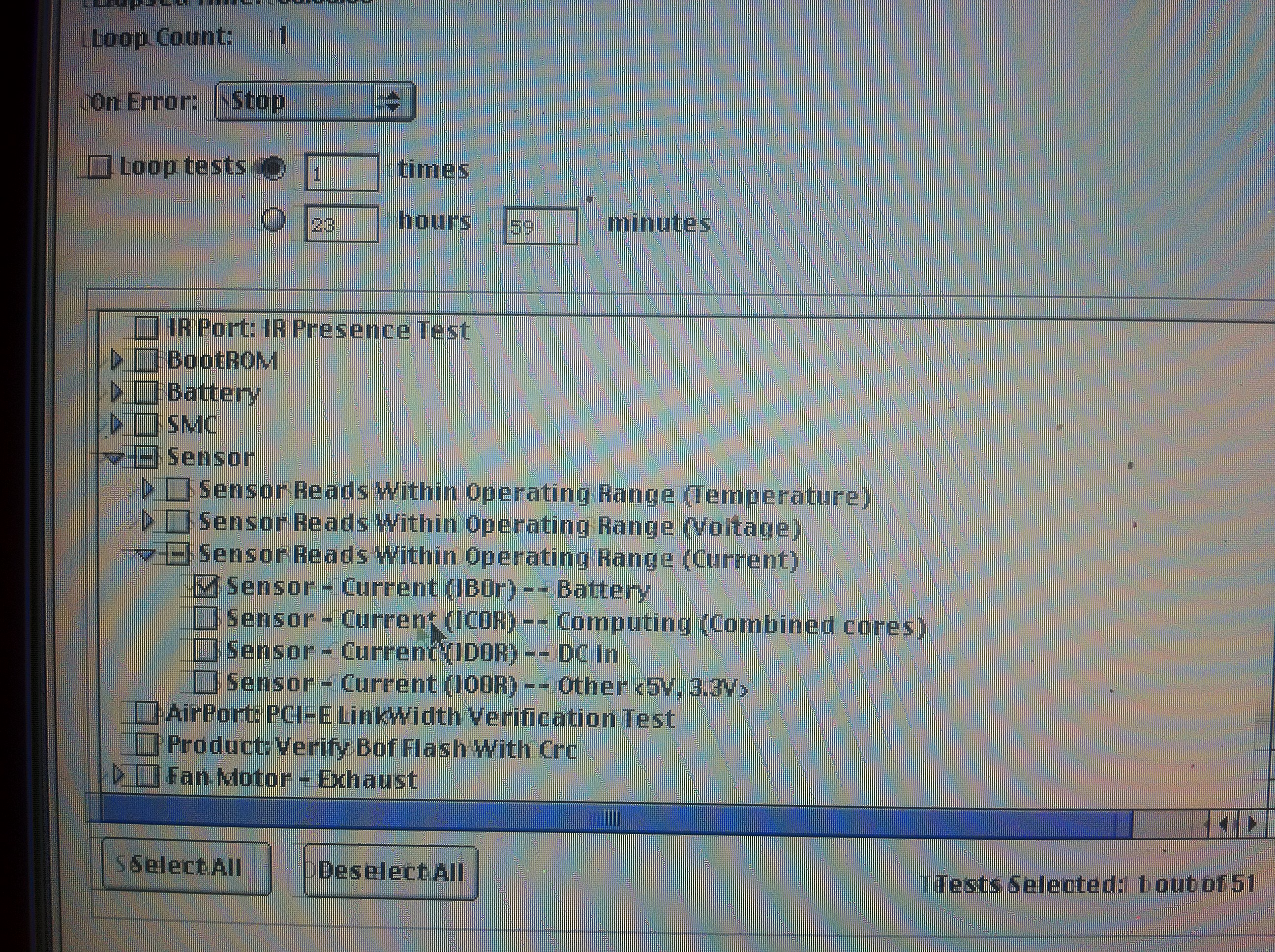

also i did the efi test and i'm getting this error at :sensors/sensor reads withing operating range (current)
ERROR - SENSOR IS READING ABOVE THE HIGH LIMIT
-TEST FAILED-
-TEST FAILED-[/QUOTE]
-TEST FAILED-

My guess is that water shorted out a connection or line to the battery. You can try changing out the battery, but you're probably going to need a new logic board.
My guess is that water shorted out a connection or line to the battery. You can try changing out the battery, but you're probably going to need a new logic board.[/QUOTE]
i tried already a different battery skitzogreg..
i'm sure its something wrong with the logic board just trying to find whats is wrong and fix it.. it might be a fuse or any other part that can be replaced..
in case of replacing logic board i would buy a new one and just keep this for parts... doesnt worth 850usd just for a logic board :🙂
also i forgot to say that battery is charging and acting normally..
