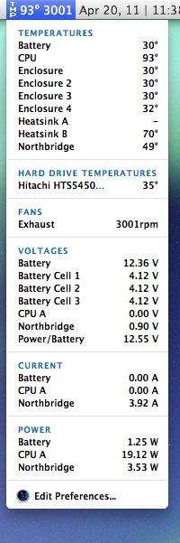

A week ago, my MBP's fan stopped working. My MBP doesn't have AppleCare so I bought a new fan and replaced it. The new fan has been working like a charm but then I notice that my new fan doesn't kick in when the temperature goes up. It always stays at the mininum speed (set by smcFanControl - 3000 rpm) even when the temperature reaches more than 90 degree Celsius, although I can force it to spin at 6200 rpm by using smcFanControl.
I tried to reset the SMC & PRAM and performed an extended Apple Hardware Test but found no error. Please help! Is it possibly a software-related problem?

I tried to uninstall smcFanControl and all its plist files, reset the SMC, and reboot in Safe Mode. The fan speed was reset to 2000 rpm. This time the fan automatically, albeit slowly kicked in around 3400 rpm when the CPU's temp reached ~85 degree and stayed at that speed for minutes. I think there maybe a problem with thermal paste or sensors =/
What were you doing when it hit 85? That is not an unusually high temp for the mid 2009 C2D's at all...even with relatively moderate load work. What did the speed max at?
I was doing some HandBrake encoding. The speed stayed around 3400 rpm.
