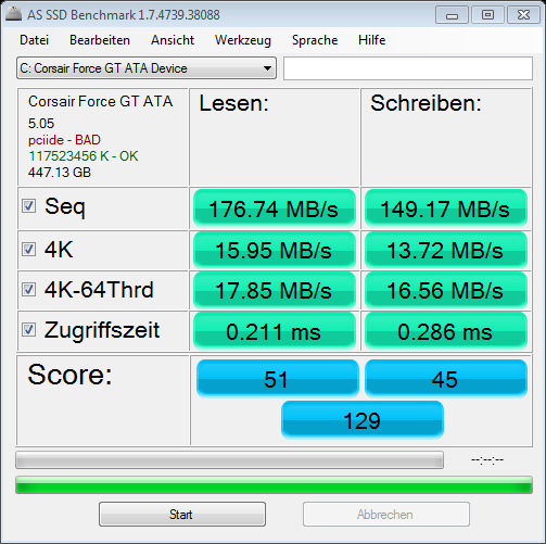

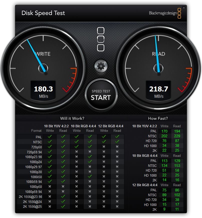

This is the SSD Performance I get under OSX 10.8.5

Voila, here it is. same system, same benchmark, OSX Sata II AHCI vs W7 Sata II IDE.
First screenshot ( already posted above ) is OSX. Second screenshot is Bootcamp W7. Quite a penalty for missing W7 AHCI Drivers, IMO.
