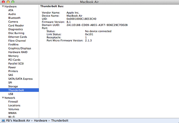

In System Information, Thunderbolt hardware is present but it says "no device connected" although it's connected to the display.

The screenshot says you have a MacBook Air. Is that an error?
In any case, the Thunderbolt 1/2 ports on Macs put out either a DisplayPort or Thunderbolt signal depending on the device that's connected. If you don't have a Thunderbolt device, it won't show up in the Thunderbolt pane in your screenshot. Neither of your monitors are Thunderbolt monitors. You should instead look at the Graphics/Displays pane to see if it shows up there. Have you looked in System Preferences to see if the external displays show up there? Connecting the monitors you have should be straightforward and it's hard to believe that two sets of adapters/cables aren't working - if they're not appearing in the two places I suggested, you may want to make an appointment at an Apple Genius Bar to see what's going on with your computer.
That's a screenshot I got from the internet. But mine looks exactly the same. Both displays don't show up in Graphics/Displays pane and/or System Preferences.
