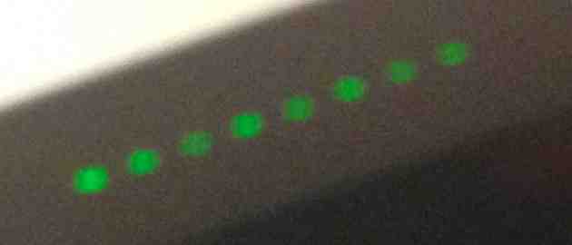

It's not clear from your descriptions if this is hardware or software. It launches from off, tries to boot and then goes dark? Is the battery now fully recharged (100% green lights)? If you put it in target disk mode, does it hold/run stable? If you do a pram reset 3 times (keep holding down the keys), do all 3 work in succession?
I am a complete beginner at this. Please can you explain what this means (target disk mode, pram reset, etc)? The battery appears to be charged (eight lights showing - see the photo, attached).

Parameter ram: hold down the command-option-p-r keys, turn on the power and don't release those four keys until you hear 3 chimes and see 3 reboots. On a functioning machine, you then let go and settings like mouse speed and screen brightness reset to default. On a bad machine, it's a way to see if the hardware is still happy.
TDM: http://support.apple.com/kb/HT1661
As above, if it's working, it shows you that hardware may be fine and that the issue is software. If you have a 2nd Mac, it also gives you the ability to test the hard drive, doing things like disk utility scans and file recovery.
