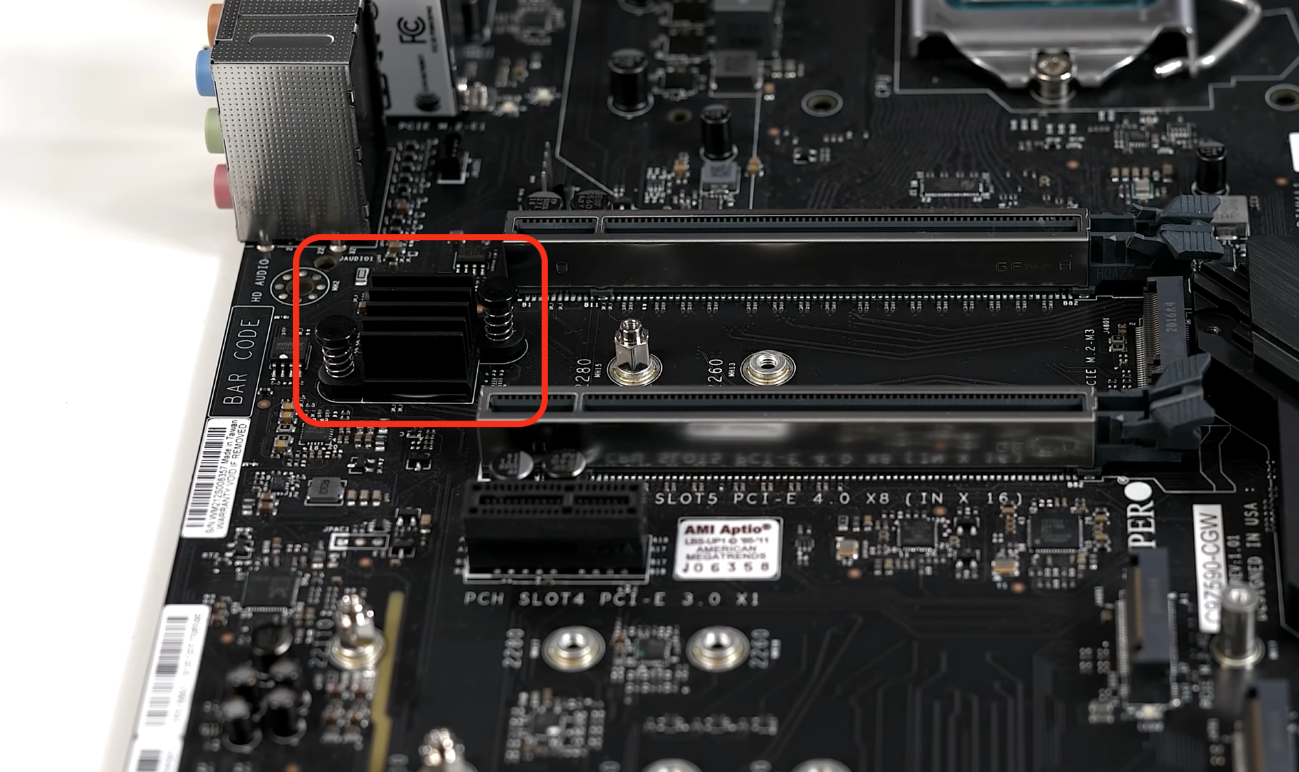

It's a single chip from Marvell, which uses 8-10W. This is well within what the MacBook Pro can handle. The "massive" heatsink you see is because those adapters are designed to be passively cooled.
You’d want it to be passively cooled in the MacBook though otherwise you’re adding to the noise floor, more fans more noise and more heat to dissipate. Personally I’m fine with a dongle for 10gbe
Isn't 8-10w a huge number for a laptop?
It is equal to ~10% of M1 Max package power under stress test benchmarks.
The 8-10W is a likely a gross overestimate of the actual power. It's based on various Thunderbolt 3 to 10GbE adapters. Those adapters have two chips: MAC controller + TB3. Apple wouldn't need a TB3 bridge chip since they connect 10GbE direct to PCIe.
Apple uses the Marvell AQC113 chip in the M1 Mac mini for 10GbE. We see this Marvell chip used in many server and workstation boards. And the heatsink is small - I'd say 5W or less just based on the size.
