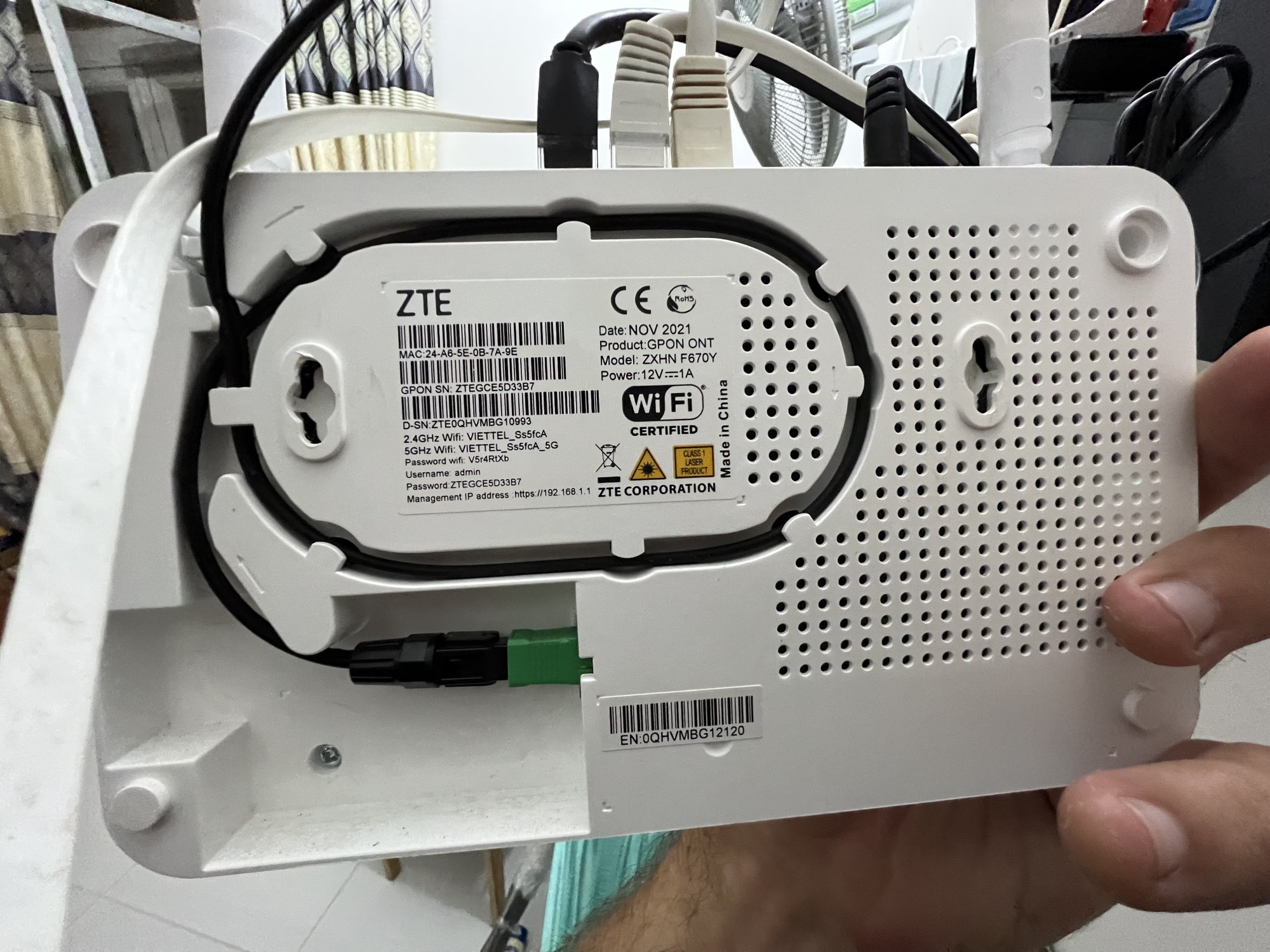

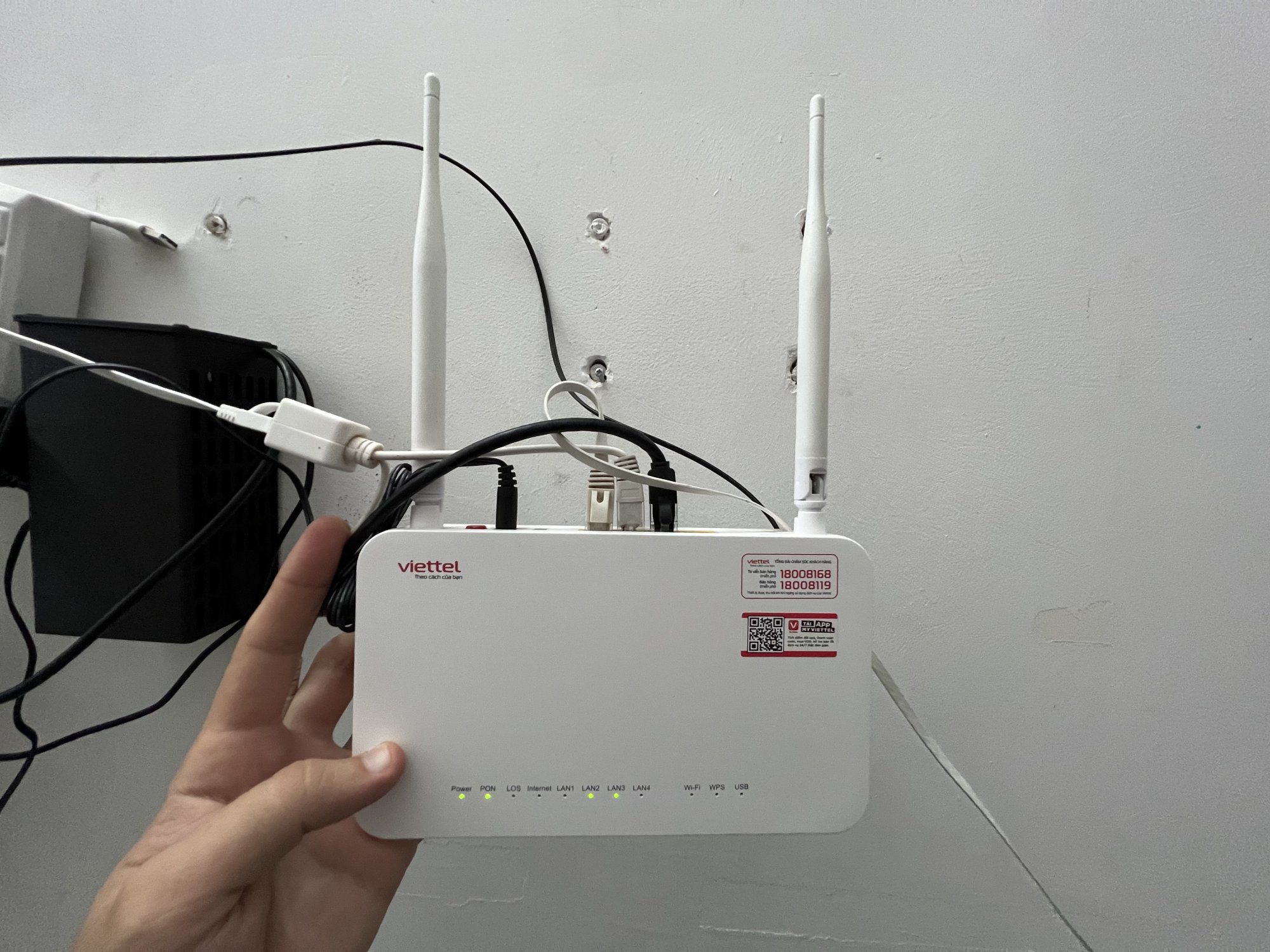

After I connected another router using ethernet cable and used wifi from the new router, macbook pro 14 doesn't drop wifi connection anymore. I'll not send updates anymore until I start seeing drops with the new router. So if somebody reads this thread and see I didn't tell that the new router has same issue - it means everything works fine for me. Otherwise, after the first drop I'll send another comment in this thread to inform about it.
Just for info, the ISP router is ZTE ZXHN F670Y. ISP is Viettel. You can see photos below, just in case somebody face same issue:
I hope you've changed the default SSIDs, and the admin username and password, because you just posted them on the internet, FYI.
@xraydoc yes, I changed it right after first connection to the router. But actually I don't mind if somebody connects to my router because they need at least wifi password or arrive to my house to connect ethernet cable, I'll not let them go inside :)
Wifi passwords are very easy to hack if you know how. Just FYI.
I’m lucky I didn't post a photo of the floor in the house in thread about wifi drops, because there might be dust :) but thank you for care anyway as I believe you have positive intentions
