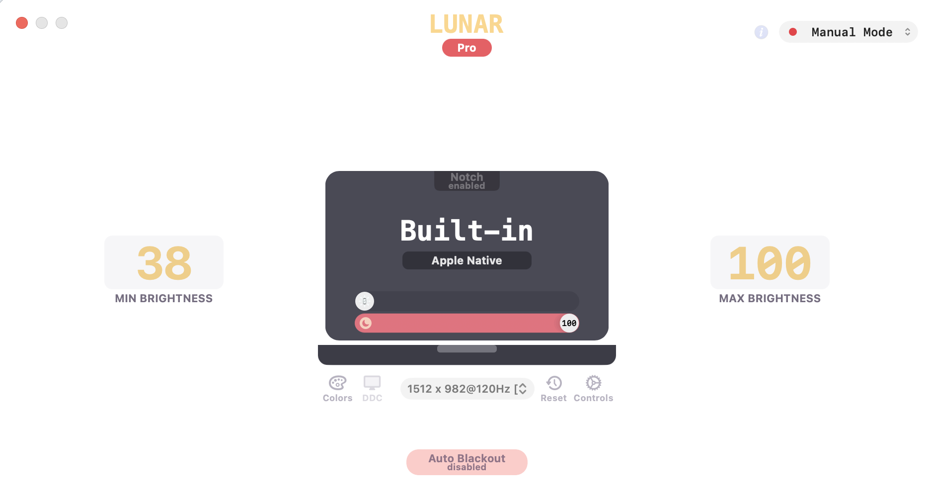

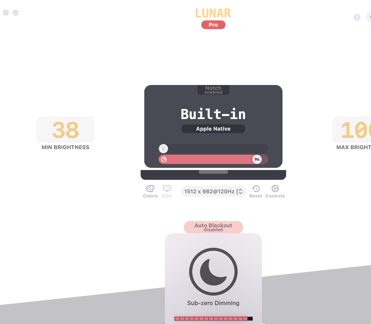

Instead of Quick Shade or Gamma Dimmer the Lunar application may be used
Launch the app.
Using the Adobe Lightroom's camera on smartphone in PRO mode with Shutter Speed 1/4000, 1/5000 or lower press Option-Shift-BrightnessKeys to fine adjust the brightness and find the brightness value below which PWM becomes noticeable. Set it as MIN BRIGHTNESS.
In my case it is 38.
Configuring a MIN BRIGHTNESS limit makes the hardware brightness stop there, and below that Lunar applies Sub-zero dimming which is what Gamma Dimmer does. You can keep using the same brightness keys for both the software and hardware adjustment.
In such way the hardware brightness levels with PWM are skipped and don't hurt your eyes.
