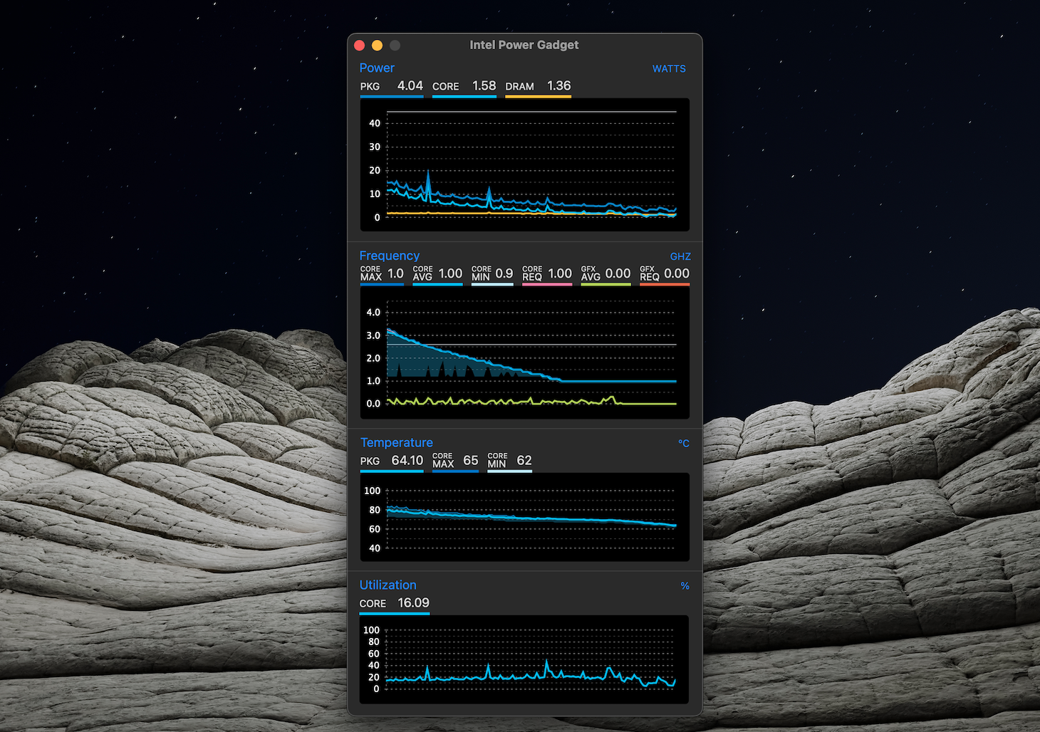

I am monitoring the clock speed via an intel app called Intel Power Gadget.
You can see under the Frequency chat it slowly drifts down the 1Ghz, this happens regardless of what I'm doing.
I'm willing to try suggestions.
The odds of this happening to both at the same time surely, must be quite high?

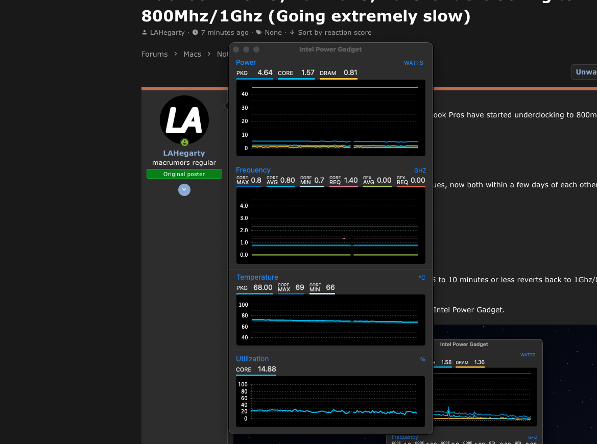

Now doing the same on MacBook Pro 15" 2019 i9

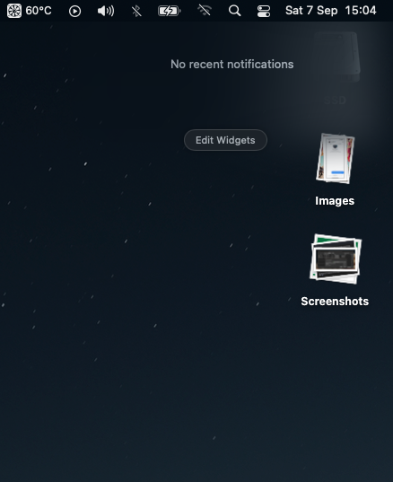

1. Remove all Widgets from the side bar.

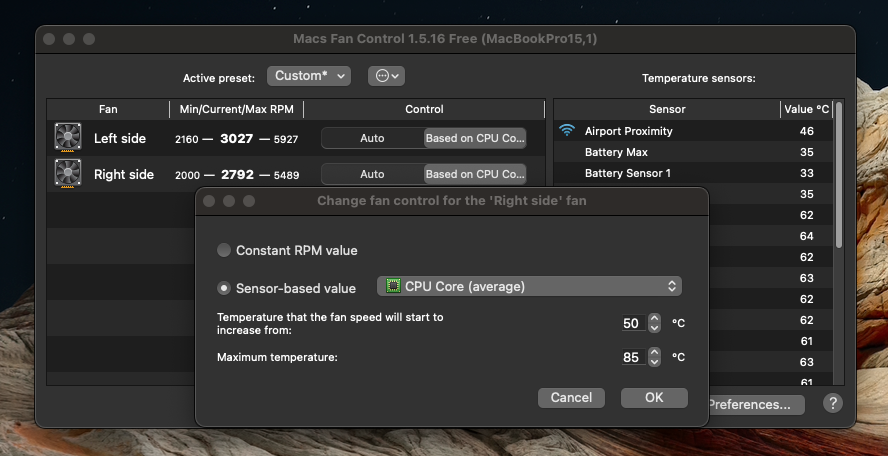

2. Set fan from 50-85 (Average core temp) in Macs Fan Control.

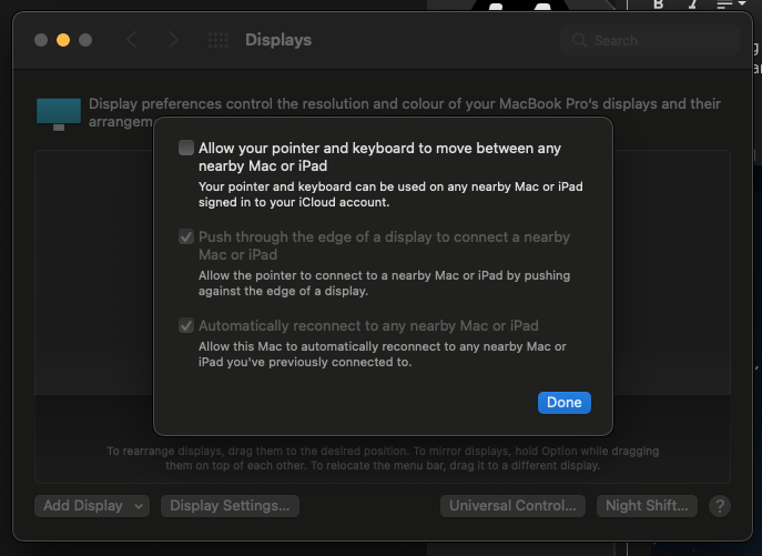

3. Turn off universal control. (I don't know why but this helped massively)
