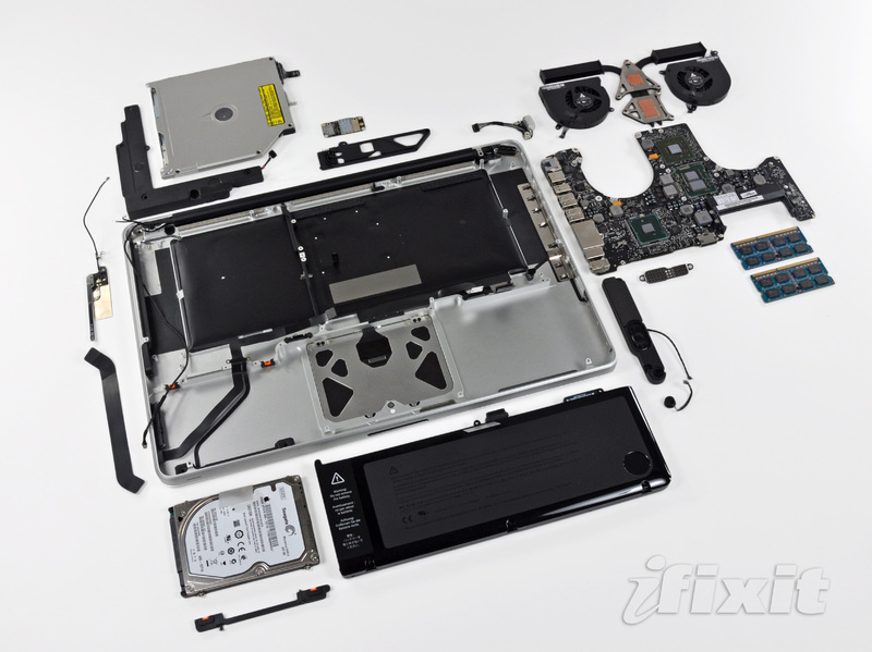

KKnqqjFfc3gsqgiD.large
Image above is from iFixit's MacBook Pro 15" Unibody Core i5 Teardown, the black L-shaped piece that's sitting between the optical drive and the case is the right speaker and sub-woofer (upper left of picture), the black narrow piece sitting below the logic board and next to the case is the left speaker (bottom right of picture), ergo since the right speaker and the sub-woofer are virtually in the same place the sound on the right will be louder. 🙂
