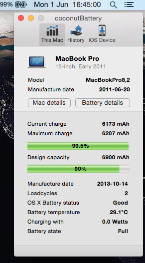

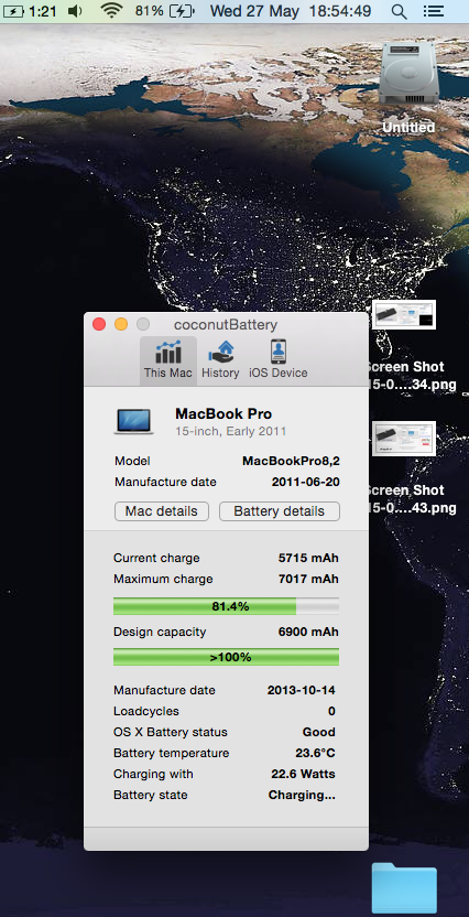

  • I recently purchased a used Macbook Pro 15 (early 2011) for a very nice price, but the catch was that the battery needed replacing. The battery which was in the laptop when I purchased it was 100% dead, so even under AC power it ran very slow. Everything else about the computer seemed to be excellent.
  • My first upgrade was of course a new battery, so I hunted for a good deal on an A1382 (77.5Wh). Unfortunately, I was screwed around by my first fleabay supplier who incorrectly sent me an A1321 (73Wh), which I didn't realise as it fit perfectly and oddly the 'dead' battery I removed was also an A1321. Anyway after another failed attempt, I got lucky on the third time and purchased what is claimed to be a genuine Apple A1382 battery.
  • I installed the new battery and when fully charged showed a full charge of 7017mAh, which I thought was great given that the "Design Capacity" is only 6900mAh. Unfortunately though, after a week of use (largely AC) and only 2 recorded "loadcycles" (to run the battery in), it now shows a maximum charge of only 6207mAh which is 90% of the design capacity.
So, I would like to know from the in-house experts what may be going on here? Is this normal, a case of operator error, or am I missing something completely here??
FWIW, on the 2 loadcycles so far, I drained the battery until it switched its self off the first time, and almost for the second time. In the first case it was only just under 10% and not 1 or 2% which I thought was strange, and the second time I plugged it in as soon as I got the OS low-battery warning.
Thank you very much in advance for assisting a newbie!
MM

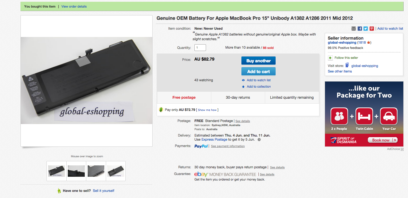

Ahh, thanks for the quick replies.
I will certainly contact the seller now. The first battery I received was not genuine and I knew I was taking a risk there, however the final one I purchased was sold as a "Genuine OEM battery", (see the pic) - although it was clearly not purchased from Apple.....my bad and my learning I guess.
Now that the damage has been done, can anyone shed any light on the following:
1. Do you think the battery I purchased was fake?
2. Do you expect that the battery will continue to lose its charging ability this fast, or do the 'fake/aftermarket' batteries simply lose a large initial percentage and then behave 'normally'?
I am obviously in the learning phase here and open to your feedback both good and bad!
Realistically, my purchasing of a 4-year old laptop was just a cheap solution after my trusty 7-year old MacBookPro4,1's battery finally exploded, until the Skylake models come out hopefully in 12 - 18mths. So would you guys throw more cash at replacing this battery again, or just deal with it?
FWIW - I only Paid US$420 for the laptop (Early 2011 15 2.2GHz/8GB/750GB/HD 3000 512MB) here in Oz, so hopefully that deal wasn't too bad.
I will obviously be contacting the seller to see what they have to say - but as already mentioned I am most definitely learning the hard way!
Thanks again for your time helping out a newb. 🙂
PS: Is there any likelihood that this battery error could be caused by anything other than the battery its self, ie. faulty charger or something else?
1. Yes - or it is VERY faulty
2. Who knows, it may simply be undersized or it could have cheap/faulty/failing cells. It could stay as it is, decline further or swell overnight, no-one can tell.

My ebay seller has agreed to accept the return, so I will probably go ahead with the OWC NuPower 78Wh battery form Macfixit. Thanks again for the input, really helped!
Here is the battery information according to coconutBattery - from what I have quickly googled, it seems that SMP was the Apple supplier for that gen. of Macbook Pros.
You can buy "reset chips" for certain toner cartridges to enable printing beyond the manufacturer-supplied page count limit. The fake batteries need some sort of chip in them to get the Mac to recognise and use them at all, I'd be amazed if they hadn't cloned a genuine chip which would also give the batt manufacturer details by now...
Interesting - sounds so simple that I can't believe I was naive enough to just believe the fleabay listing.
The first seller had sold over 30 of the same units, and the second seller had sold just under 90, so I am a bit surprised that I haven't read more online about these suspicious replacement batteries.
I hadn't found any other examples of similar situations online.
To the credit of the second seller (shown earlier in the thread) they are accepting my return no questions asked - very unlike the first battery seller I dealt with.

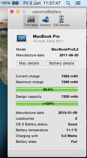

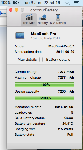

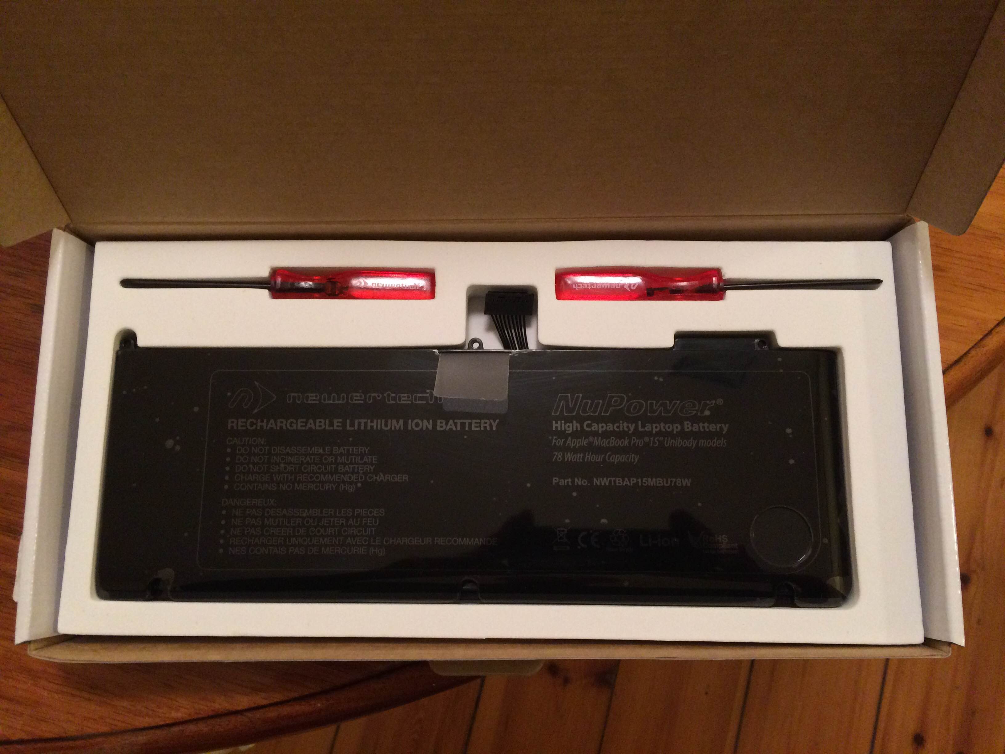

Ok, a bit of an update here:
1. Received and installed the new Newer Tech NuPower 78-Watt Hour battery
2. Used it right out of the box (had 52%), then once down to 5% powered down and let it charge for 12 hours
3. After 4 cycles it showed a max charging capacity of 7292 mAh
4. Then after inadvertently letting it run down to 0%, it now shows 7277 mAh which I can live with.

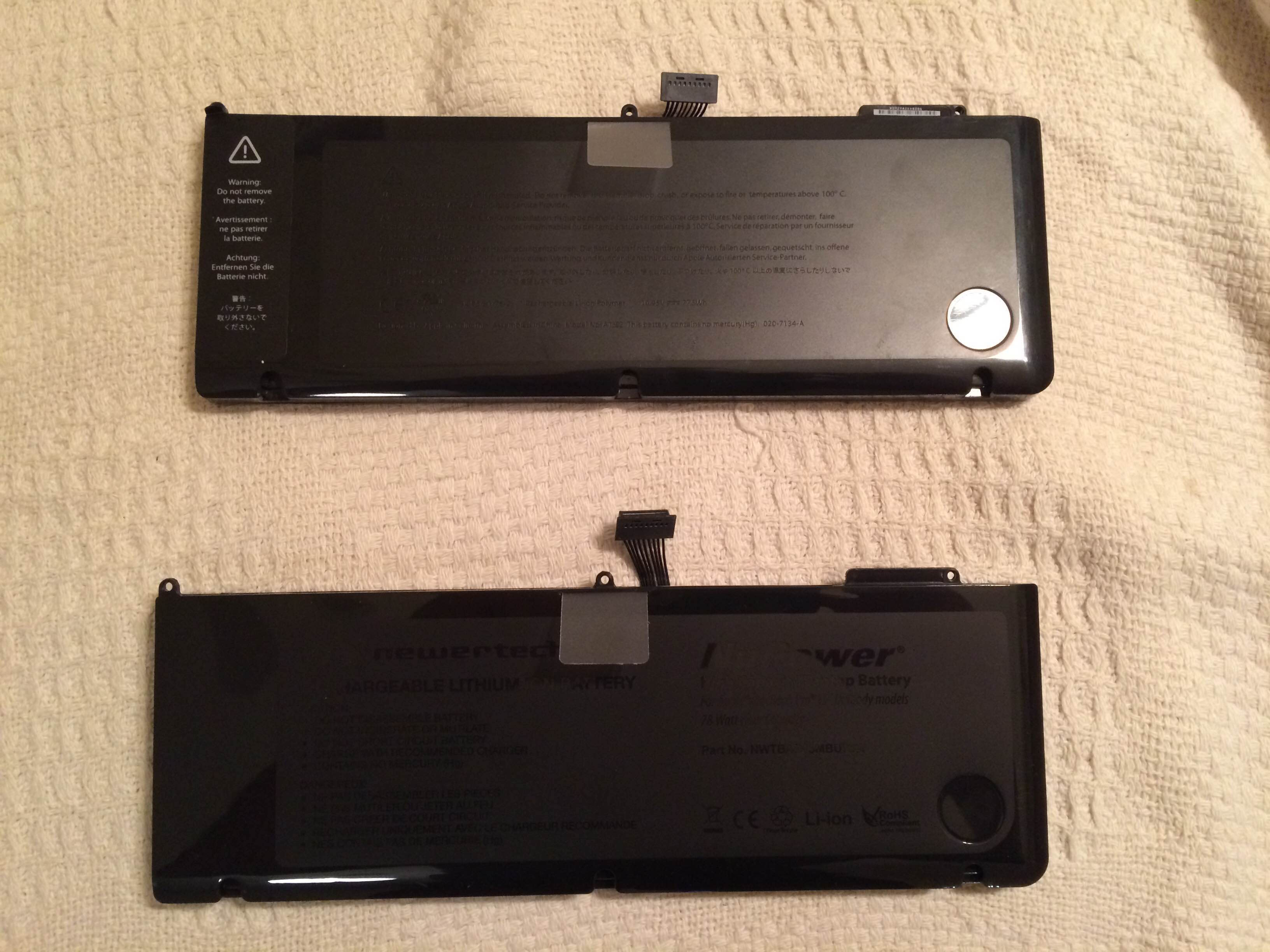

Thanks again for the help, some lessons learnt:
1. The cheaper (non Apple / OWC) batteries were not worth the effort for me (although if my 2nd battery had 'stayed' at a max charge of 90% it may be somewhat acceptable).

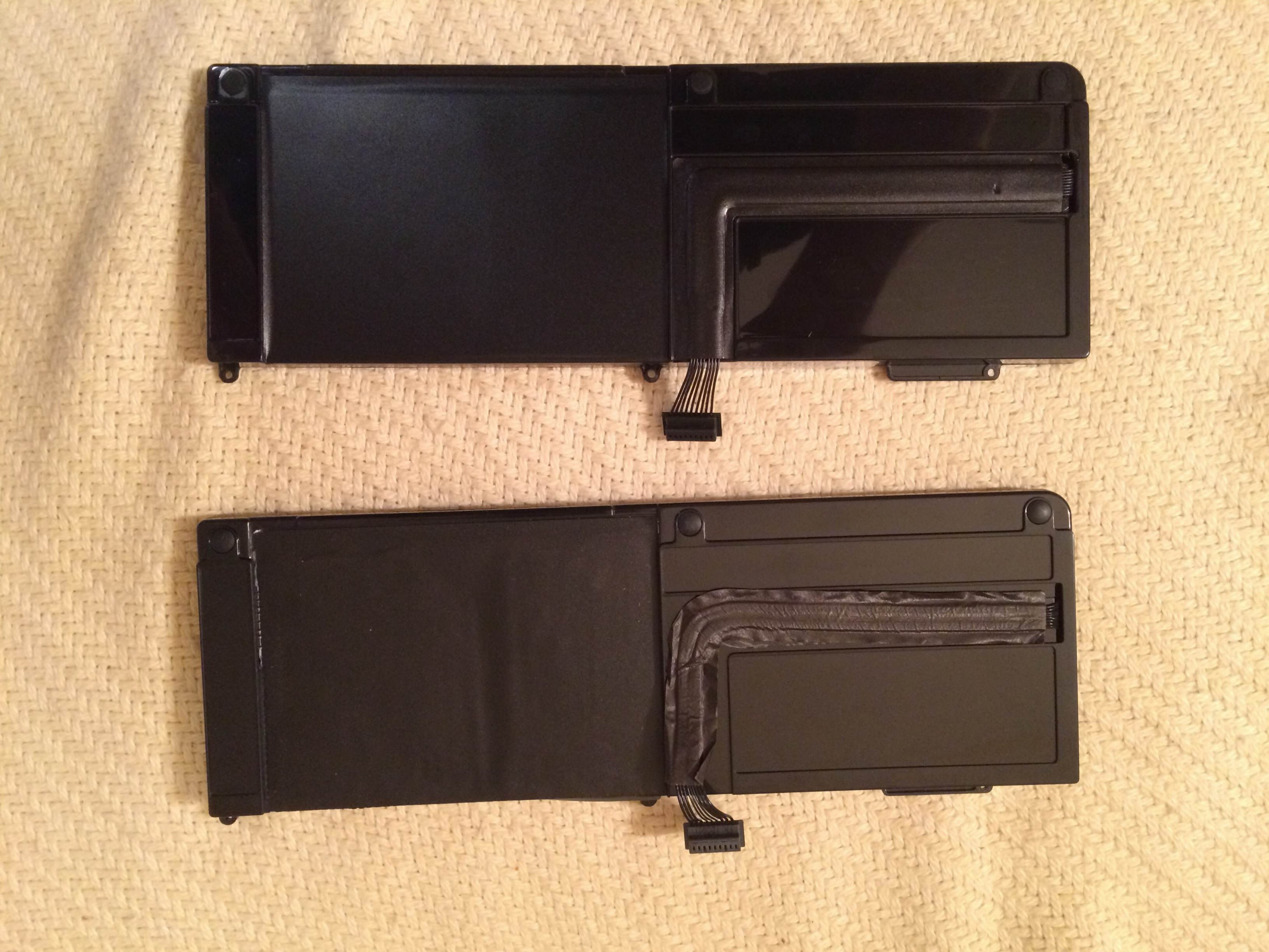

2. The cheaper batteries may be fake / used / something else, but mine showed a lower build quality in terms of the cable gluing on the rear.
3. Nice to buy a battery that comes with the tools.
4. Evidently the 'soft' battery info can be reprogrammed so not always reliable
Here are some pics:

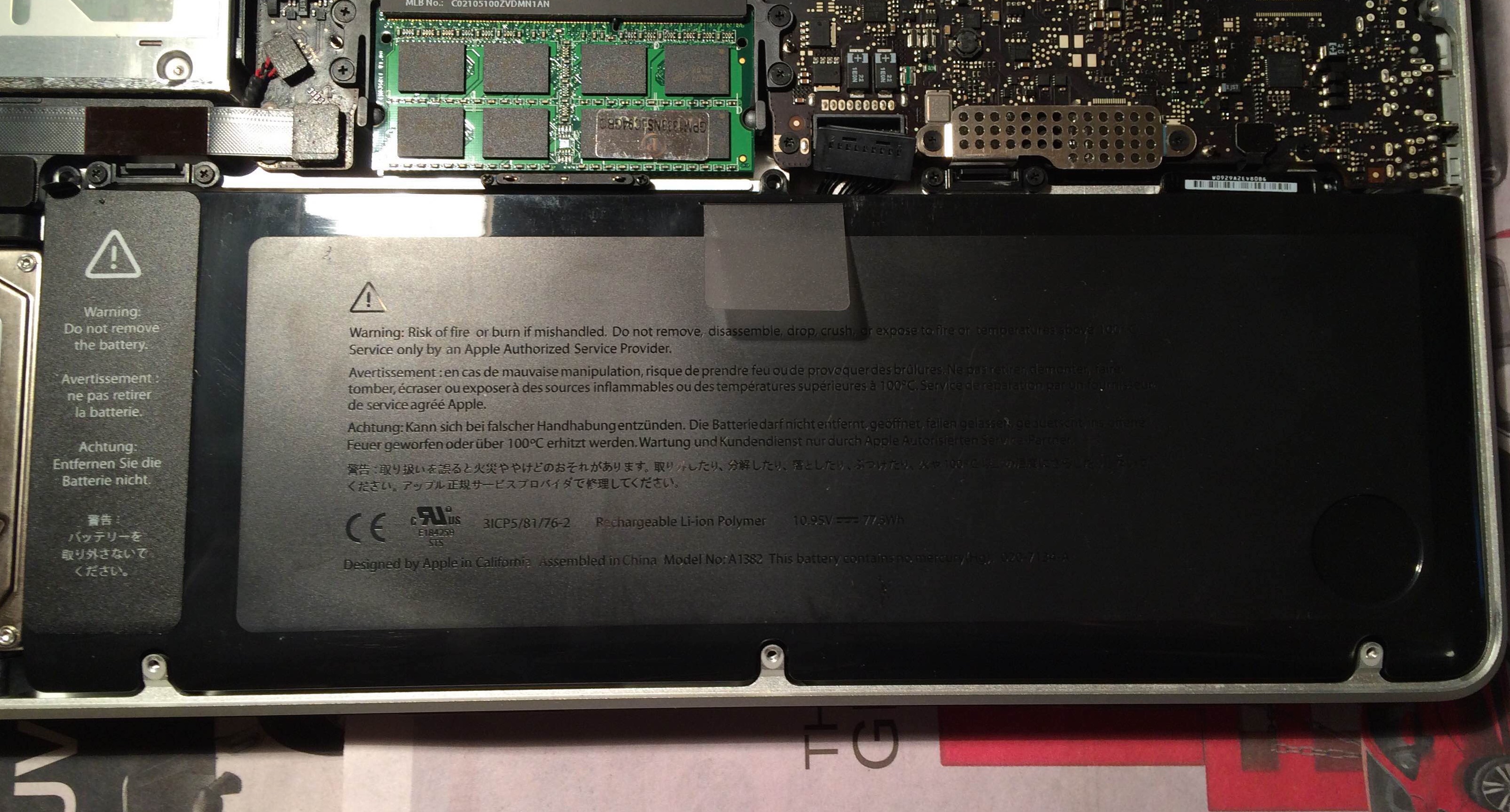

* EDIT - just realised I forgot to take a pic of the new battery installed! So that pic is of the one I swapped out for the NuPower one.

This is the battery I got for my mid 2011 MacBook Pro (first upgrade I made) Mine says the design capacity is 7200 but I get 7275.
