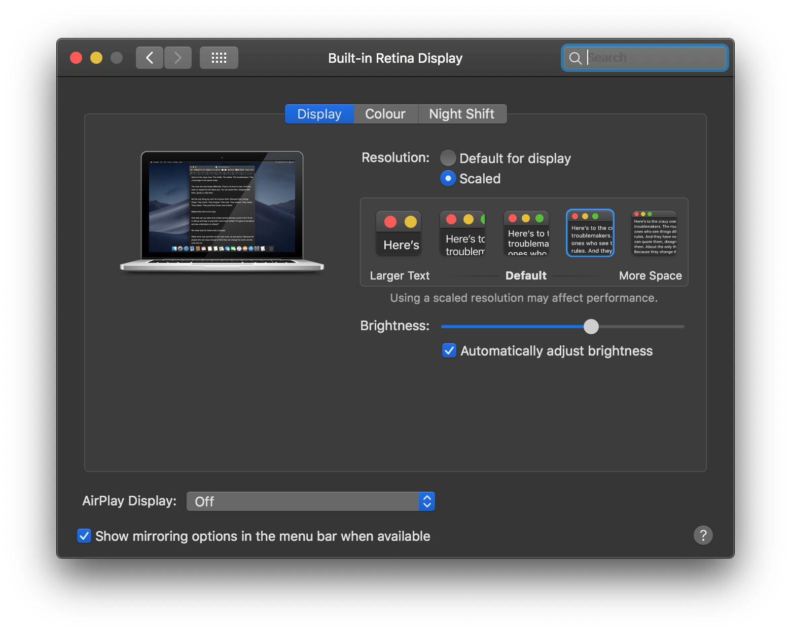

I have started to use custom display scaling
And when I have enabled it - I began facing with it again. But while I have been using default scaling for my Macbook Pro 15" 2015, I wasn't facing with it.
Pretty strange stuff. I'm concerning that a lot of people should face with it, but just do not all realize what's really facing with it 😵
Just interesting, are you using custom scaling as well?
I have switched back to Default. Will see...
(But, surely, I would prefer to use not 2x, but at least 1.5x scaling... I like to see a lot of content on the screen).

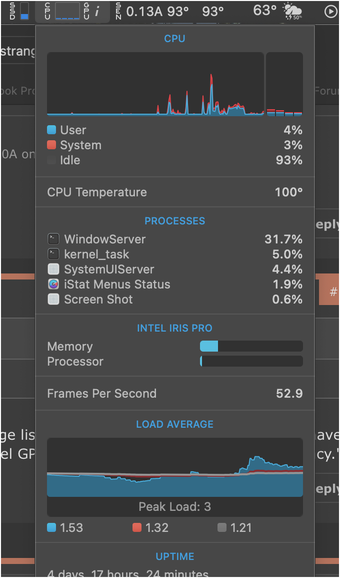

How do you see that in iStatmenus?.. been trying to figure it out for a while here.. I have the mid 2015 15" MBP. When I look in iStat I only see the Iris showing me anything..but I know it has the AMD R9 M370X
How do I see what in iStatMenus? I'm looking at the integrated GPU (Iris) frequency. It does show that for me. I cannot see the dedicated GPU frequency.
I don't see a frequency anywhere listed.. how do you see it?
I tap on my chosen "sensors" shown in my menu bar and that pops out a huge list of all the sensors. Perhaps you don't have "Sensors" enabled in the app config to show in your menu bar? It shows "Intel GPU Frequency" right below "CPU Frequency."
Yeah I have several up there.. I'm not seeing a Frequency item anywhere.. am I missing something?
I seem to recall one having to install Intel's Power Gadget (discontinued now) to work alongside iStat, it's shown here from Bjango's page. The Intel site leads you to some other alternative links now, but as my old C2D never had that support I can't say for sure this is the issue.
Yeah I saw that on their website, but I didn't think it would be related to that item.. no one else has said you needed it to see that. maybe you do?
It definitely is and there were one or two threads about it on this forum. Perhaps email Django directly about it, they are quite good with their replies and support in general.
Tbh I was all ready to download from the Intel site but back then only the Intel "I" chips were supported (i3, i5, i7 etc onwards), not my C2D, so this feature I could never get.
I suggest you maybe link to that Intel page your email to Django and inquire what option there is?
Edit: Perhaps some suggestion from this MR thread gets you further.
