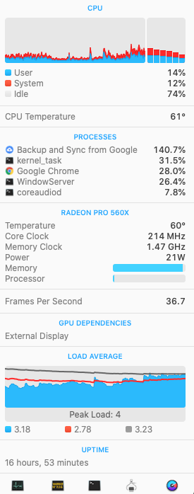

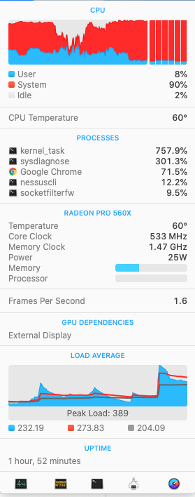

When there is a unexplained Kernel_Task - CPU 60 degrees
Right now - CPU 61 Degrees - No Kernel_Task
During Today's Kernel_Task Spike - Initiated a Download of a JPG from a Logo Designing Website, suddenly Kernel_Task spike

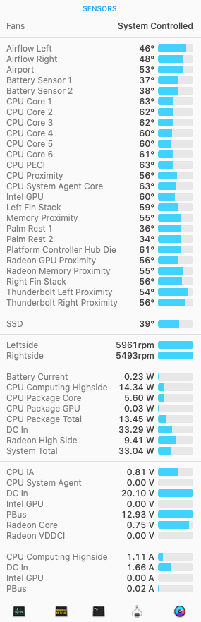

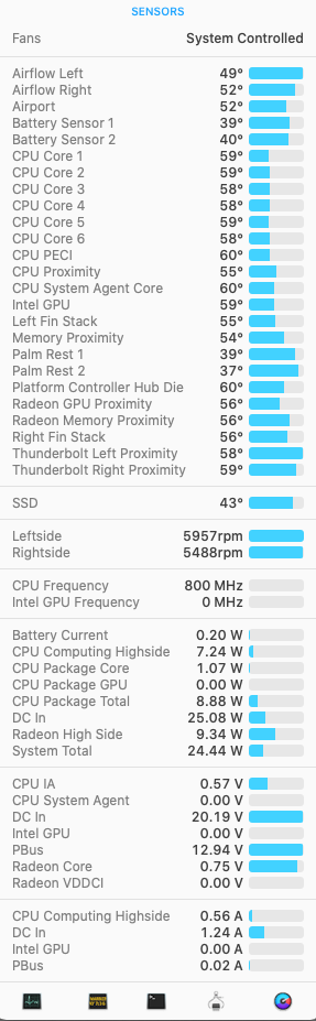

So, an update from this morning.
Monitoring the temperatures during standard chrome usage - 3 browser windows, one open on each monitor plus one minimized. I noticed that the fans have a direct correlation to the palm rest sensors
Palm Rest 1 - 34 Degrees Celcius = 3800 > 4800 RPM
Then
Palm Rest 1 - 36 Degrees Celcius = 4800 > 5800 RPM
Now since the Palm Rest never drops below that again in Clamshell mode, the fans stay at a constant full speed of 5800RPM
Video: https://www.dropbox.com/s/k10q9djbe5p9053/Temps.mp4?dl=0
