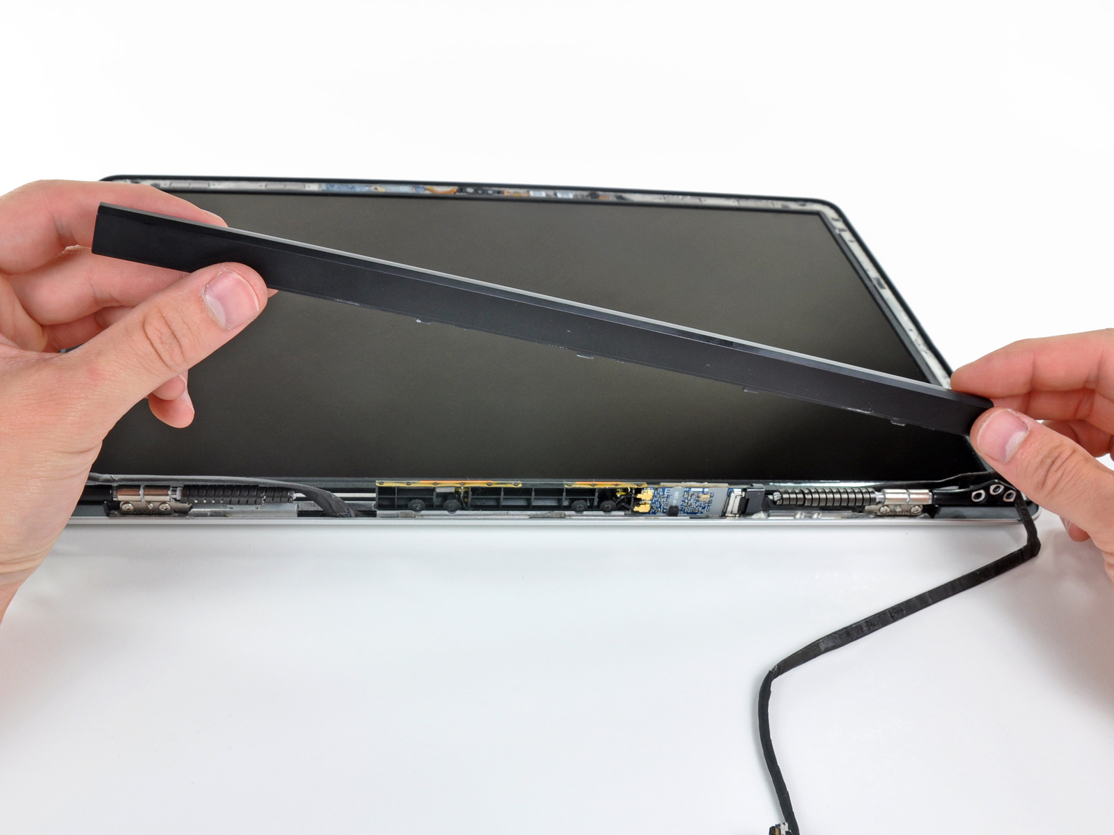

Just curious that chip on the bottom mid-right side, could that be a inverter or led control of some sort?
thought LEDS suppose to last for decades! lol
Exactly! That's what I thought which is why I'm so confused Comp had no reason to die like it has. External out still works and I am experiencing it with two different monitors i swapped (even though the second one was water damaged!) WTF could this problem be? Ask your peoples people!
Hmm that is odd. That would leave a connection issue. Replace the cable? I guess that happened with the screen swap. Which would leave the logic board connector as bad I would think. :/. I assume you did a pmu reset to begin with right?
Yeah, I did that and one other reset before. The screen that i have on now was from my other identical MB that got water damage on the bottom of it, so it could be damaged too. I just thought the chances slim, ya know having the same exact problem in each screen! I would really like to fix this cause that would make a couple paper weights that cost over 3 grand!
