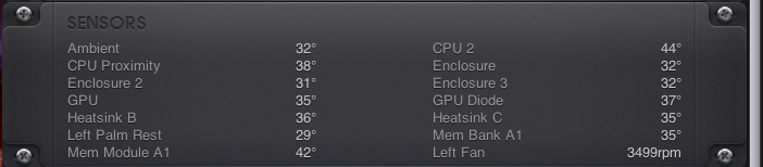

Hi i have recently ordered and received my new MacBook Pro 15" MD103A.
My problem is, that since yesterday my FAN is always at 3500RPM no matter what i do. I is kind of disturbing.
What i did so far:
1) Installed new Memory: 16GB Corsair Venegance + Memtest
2) Copied over some old files from my old MBA
3) Installed a some software.
To make some "Performance" test ive installed Valves-Steam and HalfLife2 and ran it at maximum settings. No Crash No Problems Loud Fan ^^.
And i feel like since i did that my Mac is always loud.

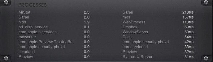

MiStat currently says that all temp. sensors are below 40°C but the Fans are at 3500RPM.
I already did a SMC Reset.
Attached are some MiStat Statistics.
What should i do?

The problem has been solved.
I have had a fully day of research and talks to others.
This is a post now for all those who might have a similar issue:
"My Fan is loud" / "My Fan is always at a high RPM" / "Fan behaves strange"
First of all it might have been some "Tool" that has or had an influence to your SMC.
In my case i have no idea what caused it but here is the procedure.
Get MiStat or any other Tool providing CPU Temperature and Fan-RPM.
If your CPU is at a high load, but you think you are IDLE do the following:
1) Check all your Active Processes with the Activity Monitor - "all processes"
and remove potential cpu heavy processes causing a high load.
2) Check your Agents, Deamons and StartUpItems: (Finder - GoTo)
/Library/StartupItems
/Library/LaunchDaemons
/Library/LaunchAgents
~/Library/LaunchAgents
~/Library/StartupItems
~/Library/LaunchDaemons
and see if theres anything performance heavy to sort out
3) Perform a SMC Reset.
4) Do a hardware diagnostic
If nothing helped or your are at the point where your CPU is below 50°C but the RPM is higher than 2000, something is wrong.
Something must have interfered with your minimum RPM settings.
5) Download : smcFanControl 2.4 or higher (http://www.eidac.de)
Check how low you can set your RPM. If that is anything higher than 2000 go ahead.
6) Download : fanControl 1.2 or higher (http://www.lobotomo.com/products/FanControl/)
here you can set (re-set) the BASE-SPEED to what you need or want.
Your Mac will not allow or accept a lower speed than the one intended by apple.
Try to set it to 2000RPM and check on MiStat if your Fan goes down.
(might take a minute)
That solved it for me! :apple:
