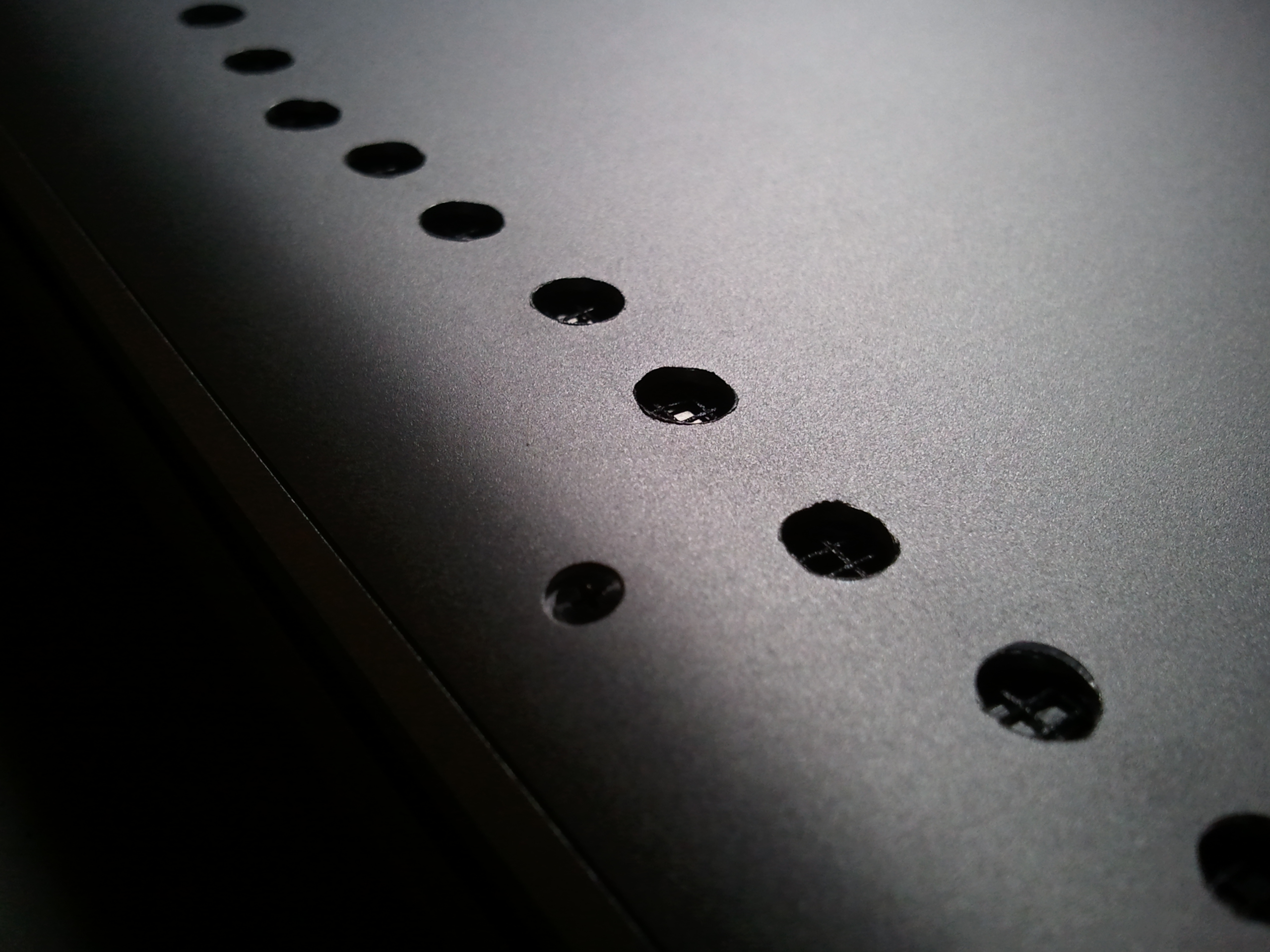

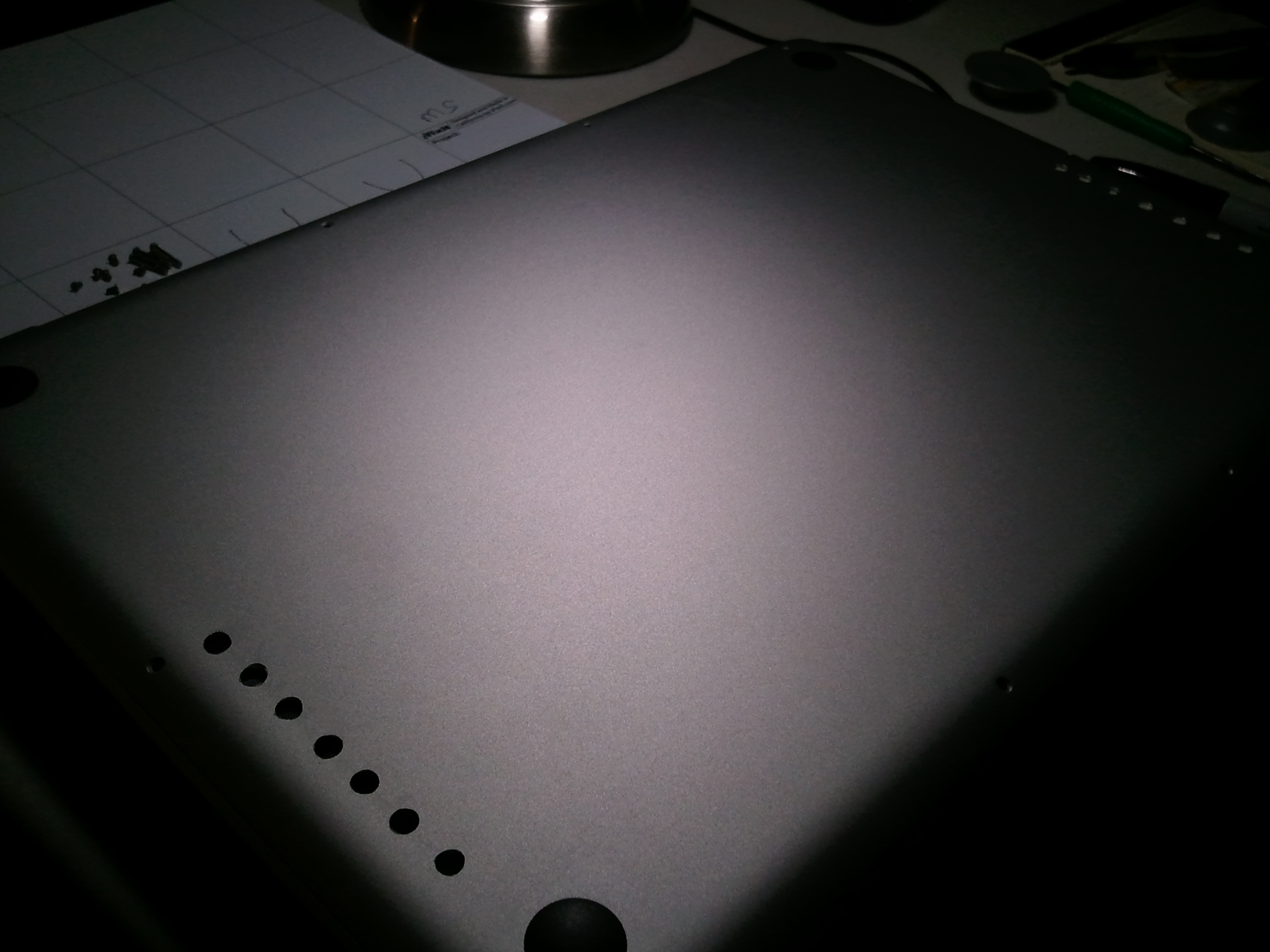

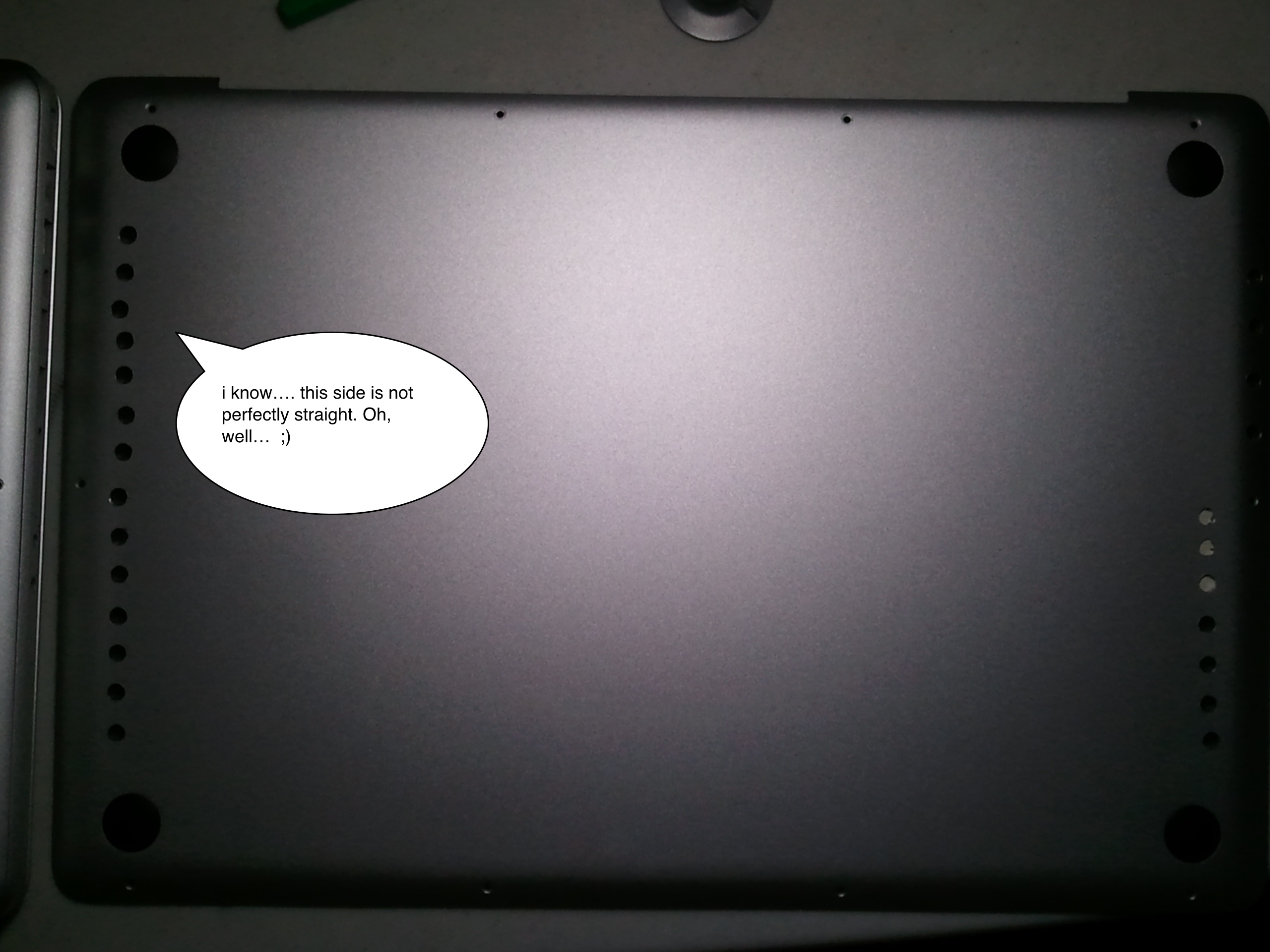

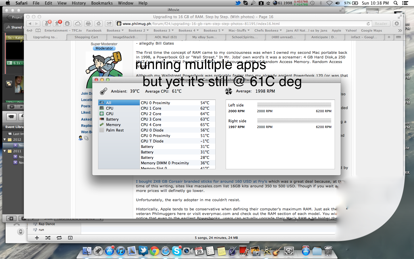

A case mod to lower the temp of my MacBook Pro.

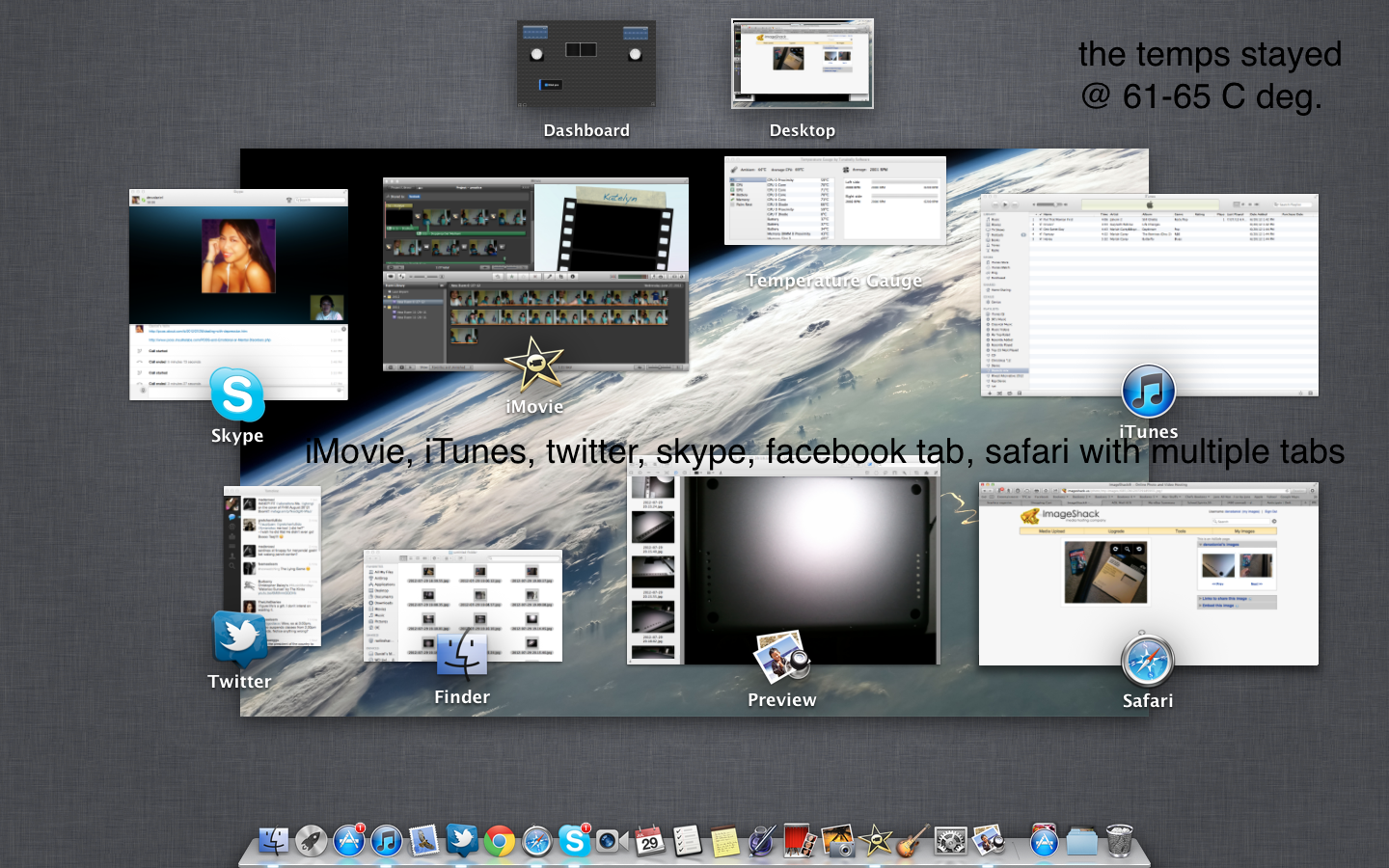

This picture is when just running Facebook tab & Growl!
The results where amazing!!!

Uh...I can open all those apps and unless I'm exporting video or running flash in full screen my non-modded MBP stays at between 59-62* too.

Whenever I see a job like this, and I've done my share, I always say, I wish I had a drill press so the holes would be precisely aligned.

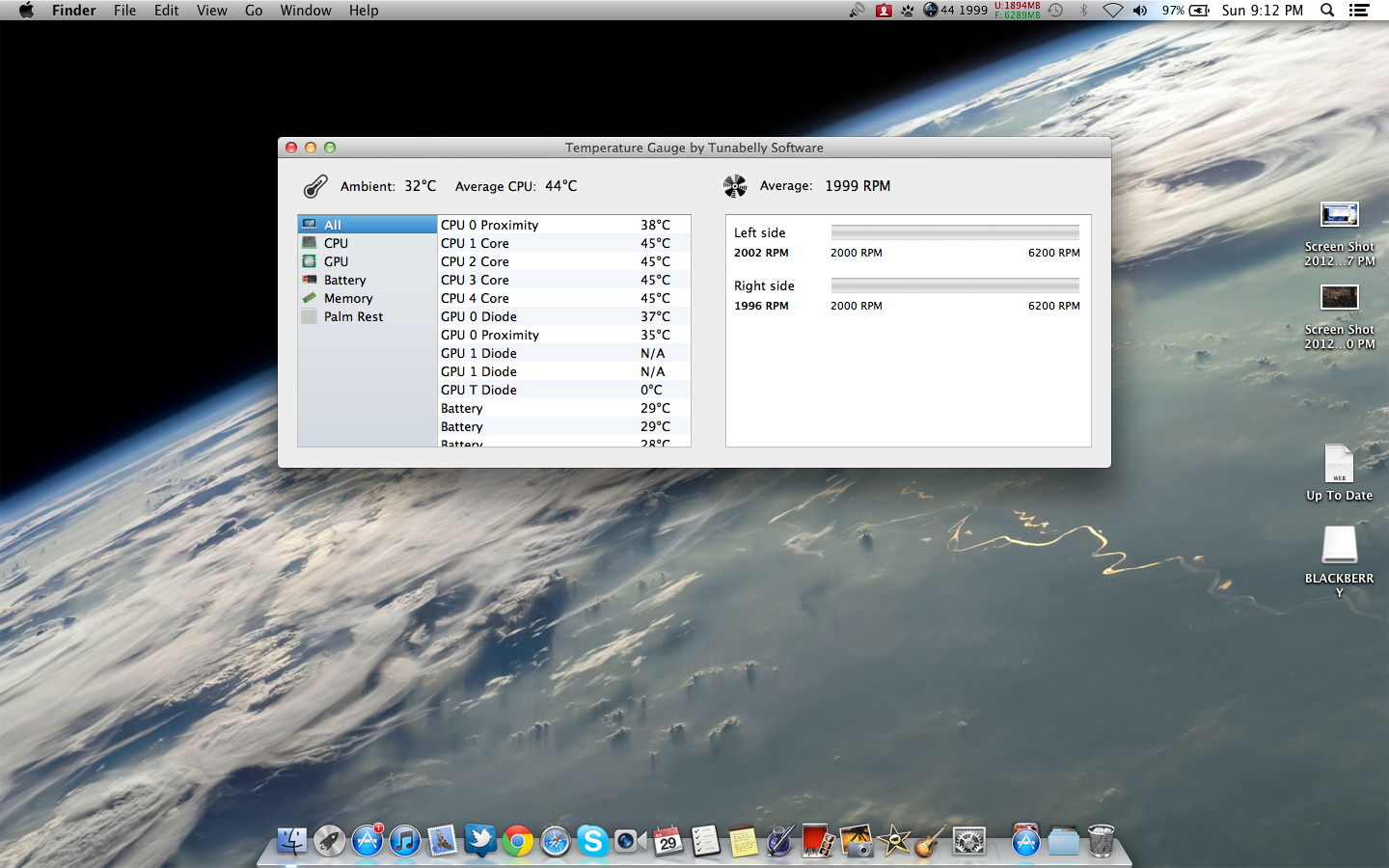

My take is had the OP posted before and after numbers this post would be of far more value, not to denigrate his efforts. You can achieve the same if not better with a software solution by increasing fan RPM`s, at the cost of some noise intrusion, to the point of reducing temp by as much as 20C. Punching holes in the bottom case is something i need to think about, first thing would be a second base plate as the original carries the machines serial number, and would effect resale.
As for the fans they are basically pulling air, the exhaust is sealed so in theory a ventilated base place should make a difference as we see in the Retina, albeit a more engineered solution. A fair start would be calculating the area of the Retina`s air intakes, and as for the vent holes any local machine shop will be able to "mill" out any shape you want at a moderate cost, taking a hand drill to one of my Mac`s is just not my style 😛

FYI! That's an extra case I ordered from Ebay, so no worries about the resale value. 🙂
And about the apps that are running... Did you see how many multiple tabs that are opened in Chrome? youtube were open and few more with flash that time.
Also, Skype is in-call and was running...
Can you run those with the temps I have?

With just surfing safari I get 53 celsius at 2500 rpm. Just add Skype video chat I am at 78 celsius.
