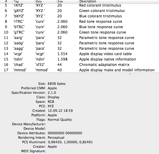

Hello there,
I have a Mid2012 15" MBP with Anti-Glare-Screen and also got an LP154WE3-TLB2 with it. I´m not very happy about this screen, for me its to blueish and the black is to bright for me (to much backlight?!).
So, I would like to get some more informations on my screen and maybe on possibilities to fix it or to get replacement.
After installing the color-profiles of one member of this forum, it got much better. Now I could almost live with it, but I would like to know where to get this version-number. A good friend of mine just got his MBP2012 and essentially its the same computer, it has even the same displaynumber: LP154WE3-TLB2 but the display isn´t blueish at all. Its really pleasant, as I expect it from a high-end-laptop.
BTW, in "About this Mac" its written 13-inch... under "Displays" its written: 17-inch, but its a 15-inch... so,... maybe some bug? But what I find somehow strange is that his display seems to me so much better... I will take my computer to him to check it side by side.
Thanks a lot for any information how to know where to get this info about A005 or A004.
In any case here some screenshots:
