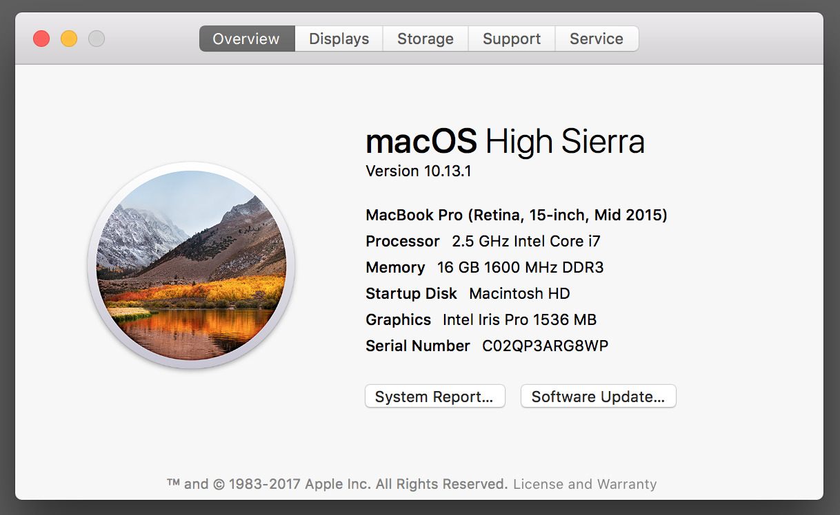

Hello,
I am a news and sports photographer, using Macs since 1996, and had strange situation few days ago:
I covered soccer match on open pitch, temperature was near 0 Celzius (32 Fahrenheit) and was wet and foggy, but not rain or snow.
I used my MacBook Pro 15" for approx 30 minutes (before that was in backpack) and everything was OK. After next half-time of 45 minutes, at the end of the match I tried to start it up, after about 30 seconds, it went off completely dead, showing red battery on zero. I forgot charger at home, and when I got it back home, connected charger, laptop started immediately and battery level was 67-68 %.
Strange to me that latest hi-end MBP doesn't work on not really very cold weather. It's reasonable to reduce battery life on cold, but this happened to few other colleagues wit Macs too.
Any idea, what is the problem and how to solve ?
Thanks,
