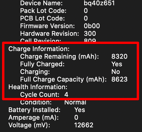

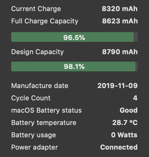

I've bought a brand new MacBook Pro 16" 2019 about 3 weeks ago.
I use the laptop with power adapter connected but battery capacity has been decreasing on a daily basis very fast.
Code:
Full Charge Capacity (mAh):    8623
Health Information:
  Cycle Count:    4
The initial capacity of bq40z651 battery is 8790 mAh but I have 8623 mAh after 4 cycles only.
The capacity was 8638 yesterday. I've disconnected power adaptor and went for a sleep. When I woke up the capacity was 8623. So the battery lost 15 mAh when the laptop was in sleep mode. I don't know what tf is going on.
Do you think this is the hardware problem? I do so.
I believe I should bring my laptop to Apple service but I've decided to ask an advice here first.
Thanks.

The MBP does not constantly charge the battery. If you install an app like Coconut battery, you will see if the battery is charging ir not. It will also show the true battery %. My MBP shows my battery % as being 100% when coconut battery says it is 98.5%. Keeping the MBP plugged in does not harm the battery on todays MBPs again because it does not constantly charge.

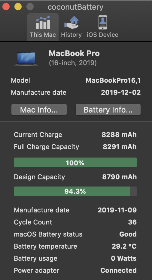

Well I gave it a chance and waited for a few months.
36 cycles only and 94% of initial capacity. I'm still sure that's not ok.
Can you guys share your current battery info (MBP 16" 2019 only) for comparison?
Thanks

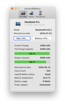

In 2 years I have gone from 5168mAh (101.5%) to 4480mAh (88.1%) in 252 cycles - design capacity is 5088mAh.
My usage pattern hasn't changed but the battery life is much worse than previous MBPs by this point in their lives. Looking around though and others have a similar decline on their MBPS. I guess it is what it is.
Thanks
If you are that eager to see how your system compares, why not use Compare online feature of Coconut Battery? Open History viewer and there is button to open web site.
Gives you comparison of your battery with same batteries from lot more cases than you can ever glean here. In time and in cycles. Really cool feedback.
I just checked and while my battery ages approximately average in time (months), it is worse when using cycles. That is kind of expected. Battery chemistry age with simple time and with cycles, it is combination of both. Simply put, even if you do not use it ever, it will die.

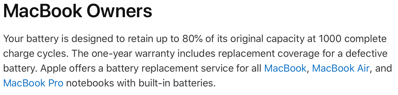

Battery health degrades, that is why Apples warranty is....

At this rate your MBP will be well outside any warranties before it meets the criteria for battery replacement due to it being defective.

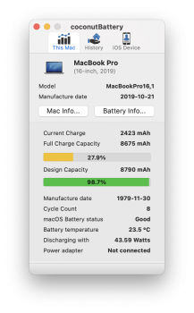

Ive had my 16 MacBook Pro for about 3 months, it has 23 cycles on the battery and its at 90% designed mah. Yes the capacity fluctuating is normal but not this much. In 15 years of owning 15 Mac's ive never seen a battery degrade this fast.
The 16 inch is kind of funky in terms of metrics, even more so if the battery health option is selected. I've seen the metrics on mine fluctuate and decline quite rapidly, but real-world performance hasn't degraded as one would expect based on the metrics. When I got the system new, capacity was 89%. It has jumped up to 100%, fell down to 90%, shot back up to around 100%, and then settled at 92% where it fluctuates up and down a bit. If that 92% was 92% on other Macs I've owned, at that point real-world runtimes would be noticeably lower. However, real-world runtimes are unchanged. It's very strange...I am not sure if it is a Catalina thing, related to new power management settings, or what, but I am not sure how much weight we can put on these metrics relative to the actual state of the battery.

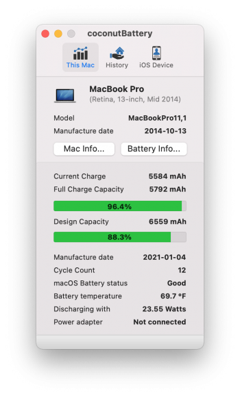

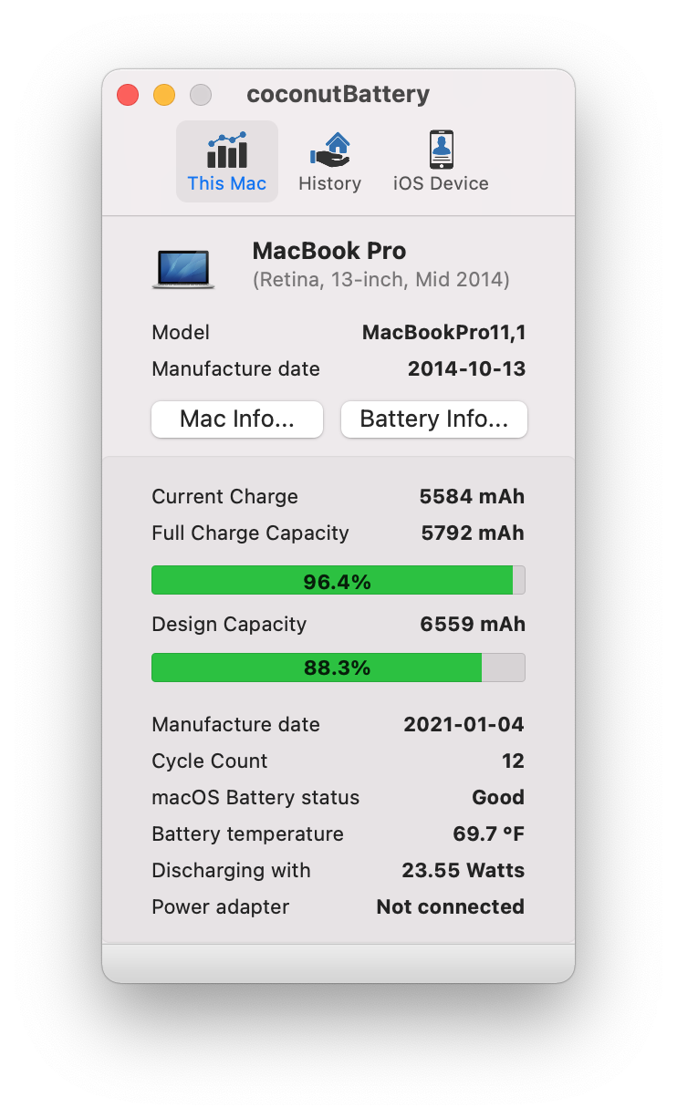

I am worried. 12 cycles and it has dropped almost 1,000 mAh in capacity. I still get about 6-7 hours of usage with it, which is what it was brand new. But what on Earth is going on
Your battery is seven years old. Woth very few cycles you have likely kept it connected and fully charged most of the time. Not the best approach for good battery health.

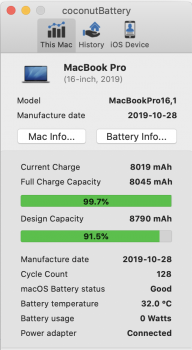

My 16" 2019 is a year old, and is plugged into an XDR almost all the time so it is forced to charge in that situation. My full charge capacity is 7921.
