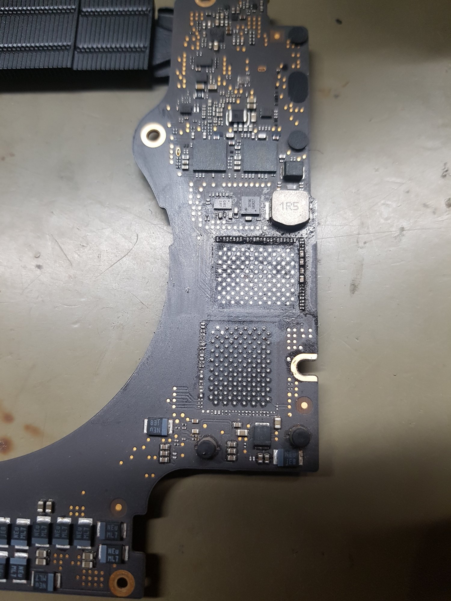

the macbook was not turning on.
had a burnt mark on u8600 near it's corner
it wouldn't go from 5v to 20v
I applied 8v to ppbus_g3h, after that the Mac went from 5v to 20v

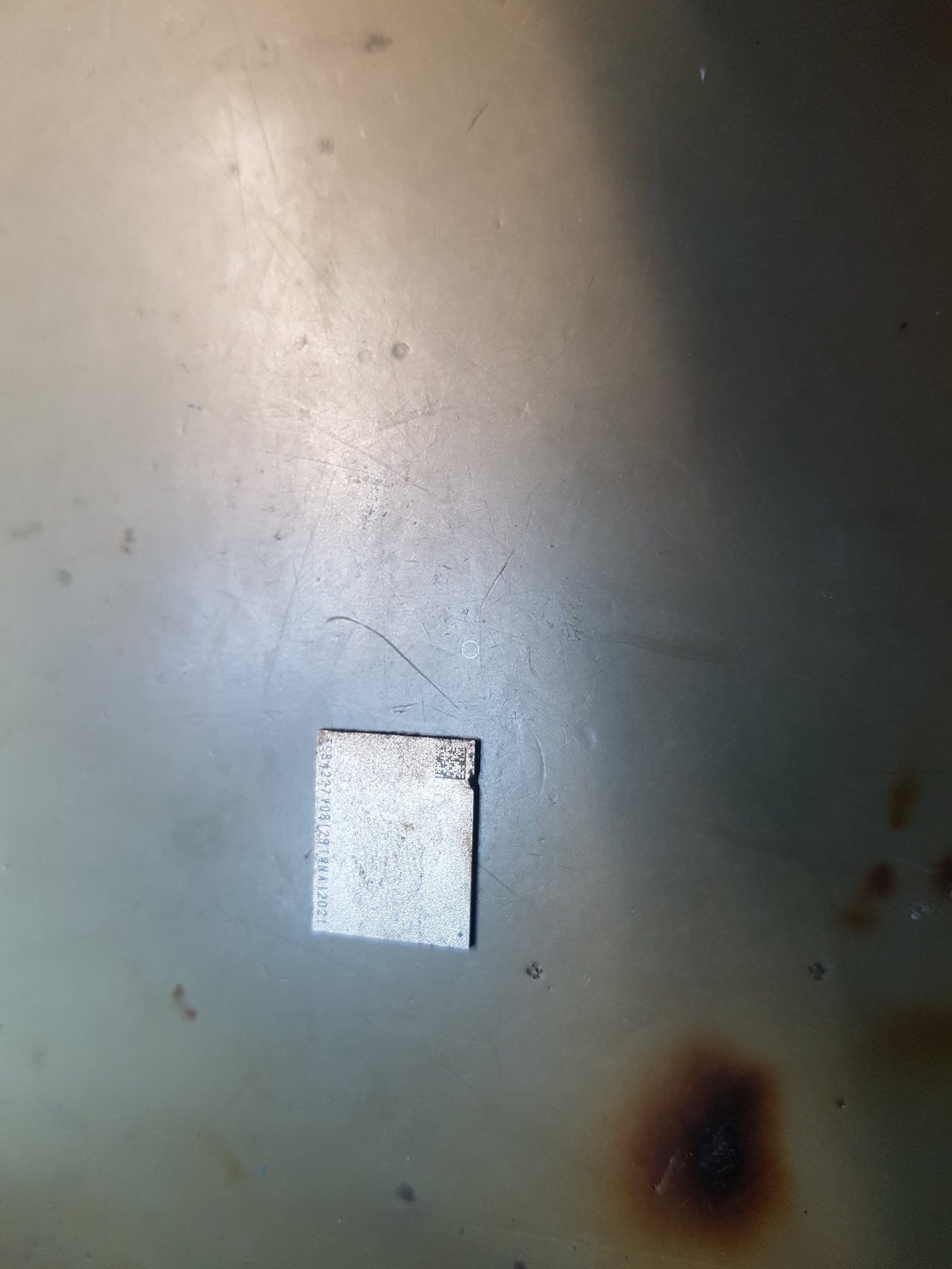

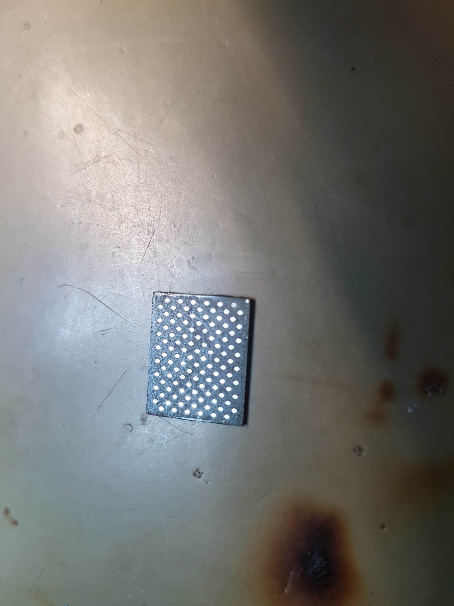

but u8600 was getting very hot, I took it out and tested it out this NAND has internal short to GND on PP1V8_SSD1. so bye bye DATA recovery.
but now the mac without the U8600 NAND is only has PP5V_G3S and PP3V3_G3H_T
no CPU or RAM voltages and current is at 0.070mA
should it boot normally to a blinking folder, without 1 of the NAND (like no SSD drive on the older models)?
did someone took a nand chip out like me, and knows how the Mac react missing 1 of the SSD NAND?
I just want to be sure, before buying a nand chip. that this is the way the board behave with a missing SSD NAND

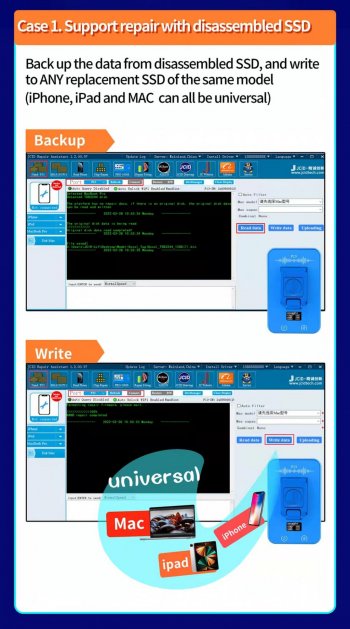

P13 added Mac series hard disk firmware repair
