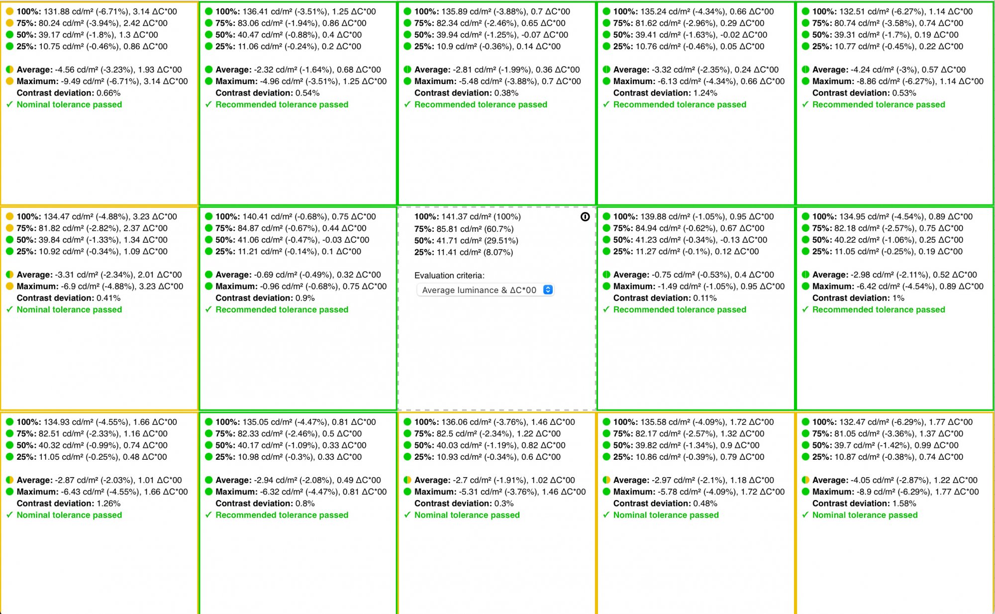

Hi, could folks with the new MBP16 and a calibration device be kind and post uniformity reports of their screen?
Here’s mine created with i1 Display Pro and DisplayCAL software.
This is my second MBP, returned the first one because of color uniformity issues (the right 1/3 of the display had a red tint). This one’s clearly better but not nearly perfect. There’s some green tint on the top left and red tint on the bottom right, visible to my eyes and also reflected on the report.
Now I’m debating whether to play the display lottery again or just keep it. Would be good to know how common good uniformity (ΔE / ΔC < 2 or even < 1) across the panel is with these displays…

All I know is my screen brightness uniformity and it is excellent in that regard. Maximum of 4.7% deviation. As the brightness goes down this number stays under 5%.
I have the 14".
Yes, brightness uniformity seems to be good with these displays, though I’ve read reports of occasional banding artifacts due to poorly calibrated minileds, but those are probably too small to measure on a 5x5 or 5x3 grid.
However color uniformity is what I’m more concerned about, as having color tints on a white background is really annoying when doing design/illustration work. Having a 3% tint towards green on the left and 2% towards red on the right creates a 5% difference accross the screen which is quite noticeable.
Unfortunately none of the reviewers seem to measure color uniformity, notebookcheck for example only measures brightness. Or then uniformity is measured as delta E which combines brightness and color variations, as that seems to be the default reporting setting for most software - for example in DisplayCAL you have to change the criteria setting in the report manually to see the results separated as luminance and delta C.

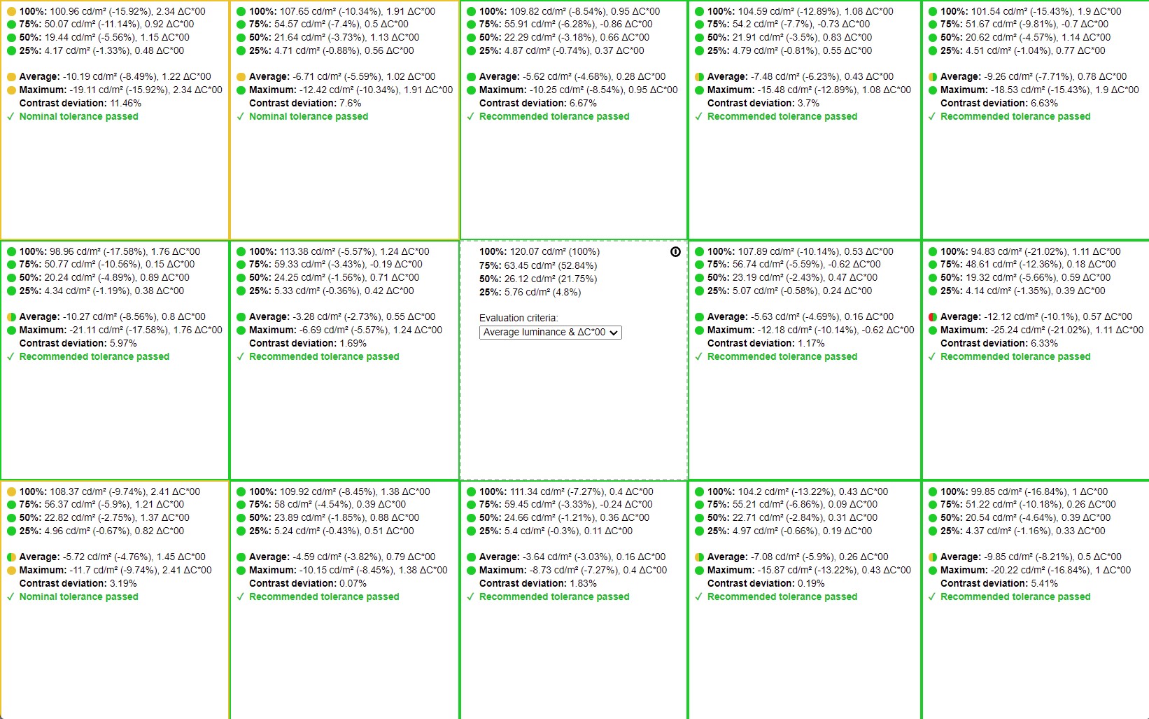

Just to compare I measured some of my other screens. Here’s my Huawei Matebook Pro X:
As you can see from the numbers, worse brightness uniformity as typical for an edge-lit lcd, but way better color uniformity. Also no tint when viewed from an angle, vs. the MBP which tints heavily towards green/magenta when viewed from the sides.

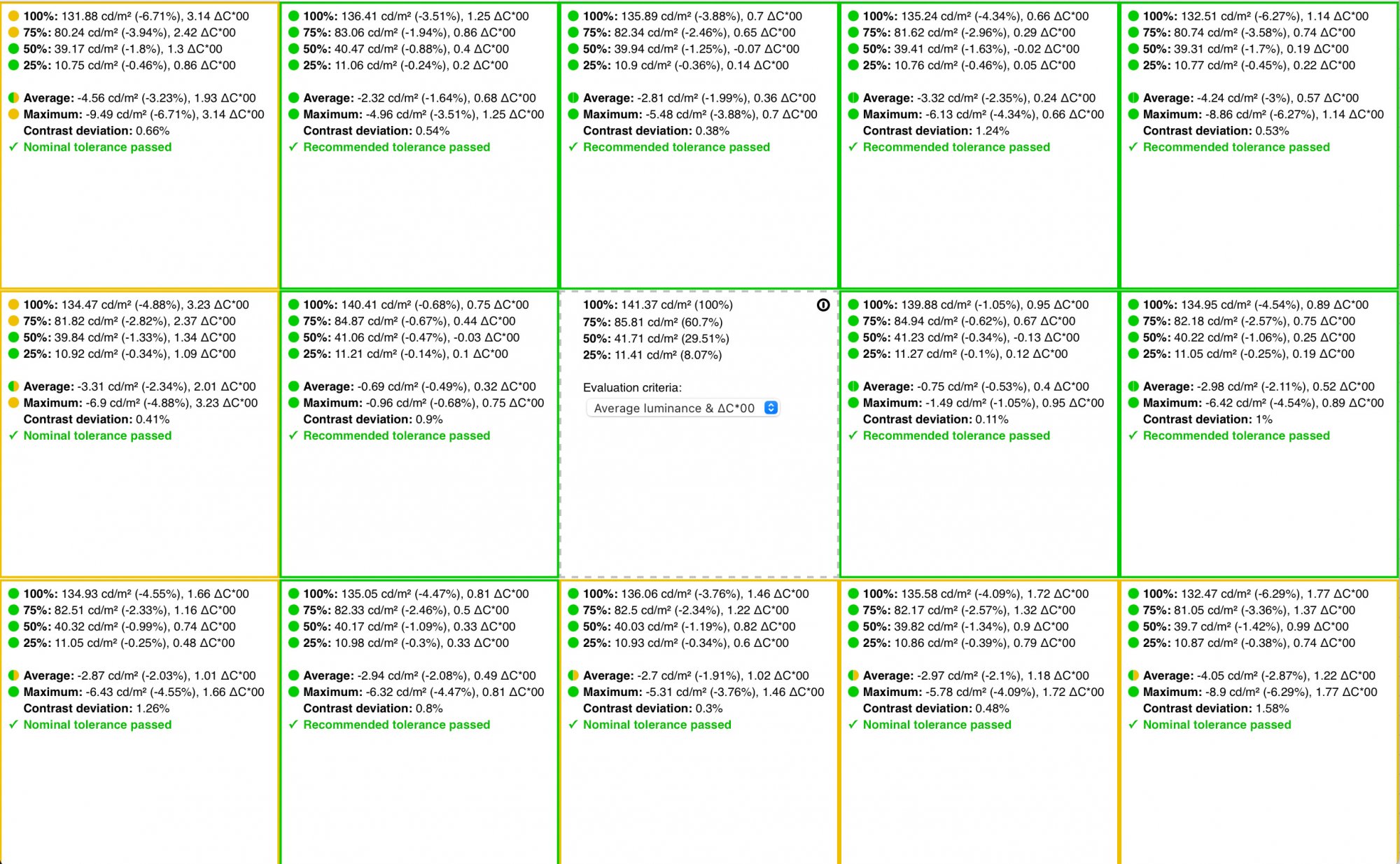

And here’a my BenQ PD 3200U:
Again, worse brightness uniformity but better color though the numbers are closer. However this is a 32” screen and more of a low end model so wouldn’t expect any better.
