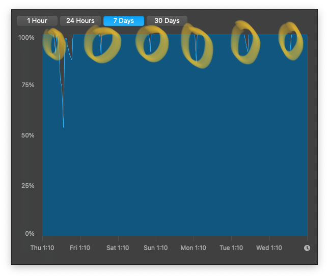

Over the past two weeks, my MBP 16 inch would discharge its battery down to about 90% then recharges back to 100% all by itself, with the power adapter plugged in the whole time. It's happening roughly once a day at random hours. Anyone else running into the issues and/or has any advice on how to diagnose this issue?

That's not an issue. That's battery health optimisation. It's doing this to maintain longevity of the battery because it would not be healthy for the battery to stay at 100% without getting a little exercise now and then.

Thanks I thought that might be what's happening, but my expectation – since the system is plugged in pretty much constantly – is for the machine to drop charge level to 80% and hold there. Instead, the machine is discharging to 90% only and immediately charging back up, increasing charge cycles. I've also disabled Optimized Battery Charging, so this behavior is little bewildering...

Hm. I did think this would be tied to the optimised battery charging setting so that is a bit odd. Possibly a bug that it continues to do it even with the setting off.
I will say though that "keeping it at 80%" would also increase the cycle count because if you let it drop to 80% and then just run it off of the power adapter, the battery will still discharge naturally - slowly, but it will. And so to keep it at 80% it would need to throw power at it every now and then or a tiny bit continually. This might be better for the battery, but I think Apple also wants to reach a compromise of battery health optimisation and keeping it where you can pull it out the charger at any point and go out with it and not go "why is it at only 79%? I had it charging this whole time"

Reading Apple's support documents, it does appear that "Optimize Battery Charging" and "Battery Health Management" are two different things on Apple Silicon Macs. On M1, only the former can be disabled; On intel Macs, both can be disabled. So it's possible that it's indeed BHM doing its work. Still, I find it a little troubling that it's doing this on a daily basis...

There are two stages to battery health management. The first is the daily bounce between 80% to 100%. If the system determines that you indeed rarely use the battery, it will move to stage two. It will hold the charge around 70-80% and cycle once in while.

I don’t believe so, although there’s no Apple Support documentation on any of this. Optimized battery charging wouldn’t discharge your battery at all. It only waits for the best time before charging to 100%.
Right now, you’re in the first stage as your MacBook isn’t sure if you’re always plugged in. So it continues to shallow cycle the battery. If you wait a few more days or weeks, it will determine that you rarely use battery. It will drop to 70% or 80% and hold it there without going back up.
