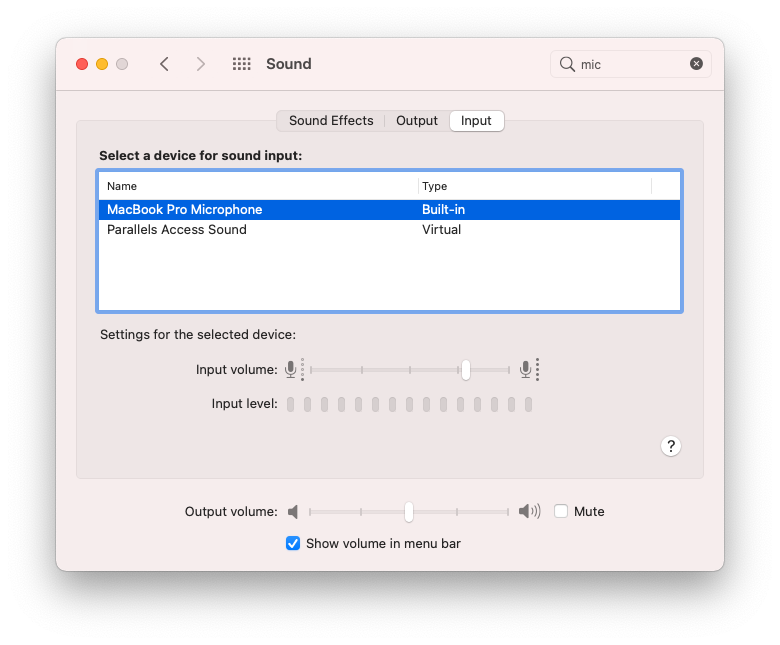

Anyone else having trouble using the 16" MacBook Pro's internal microphone when the computer lid is closed (clamshell)? Sound is not recognized at all when I am. Yes, I have checked system preferences.

I'm looking at sound settings and there's no option to re-enable it with the lid closed, in fact it doesn't mention the lid at all anywhere that I'm seeing in settings, it just says it's selected but the input volume bar doesn't move. If I open the lid or plug in headphones, it works again.

@mavidaru no, it physically disconnects when the lid is closed so there is no software way around it (that’s the point, it’s for security purposes). It’s a minor annoyance if you want to use the built in mic in clamshell mode but I guess the answer has to be the open the computer or get and external mic to plug in.
