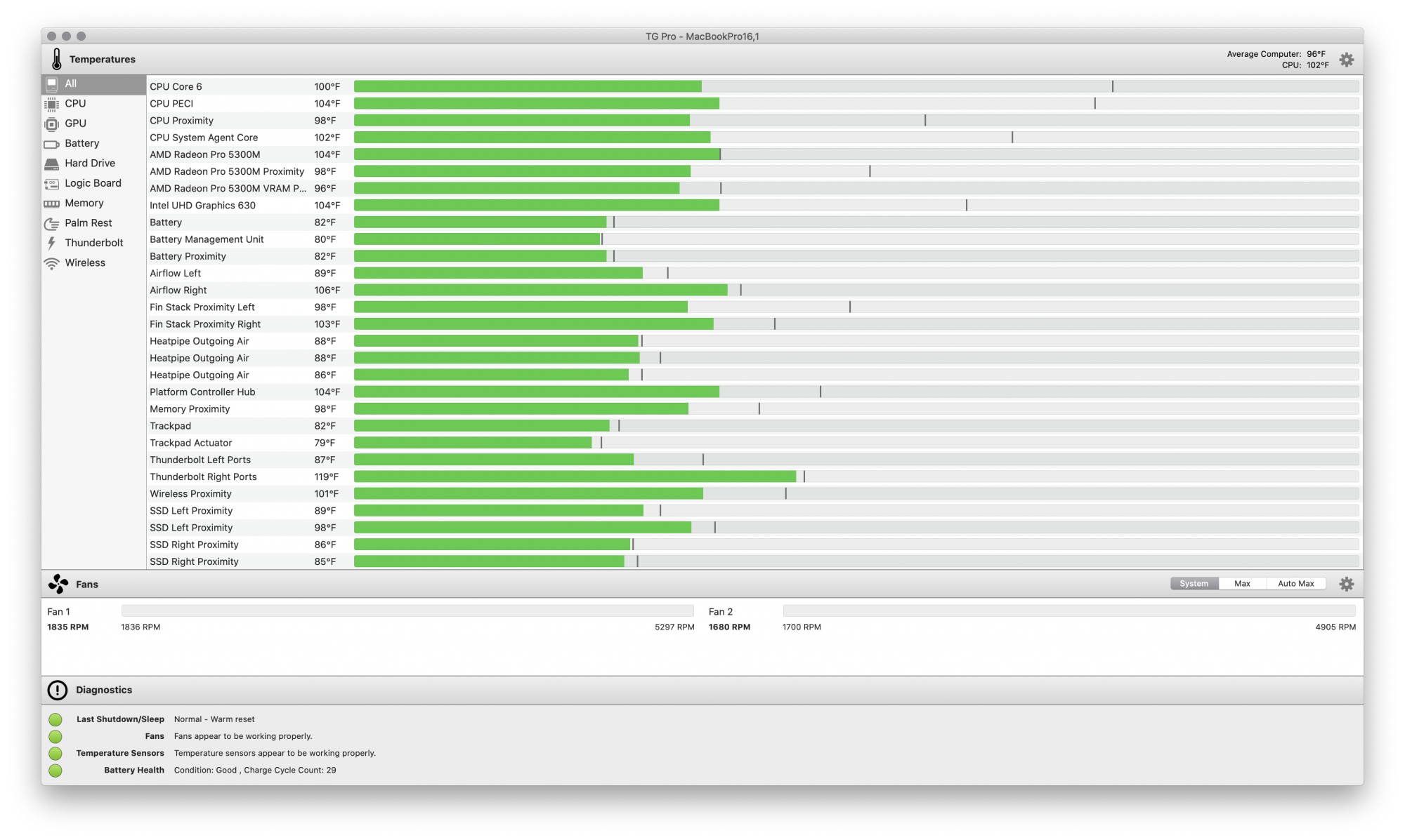

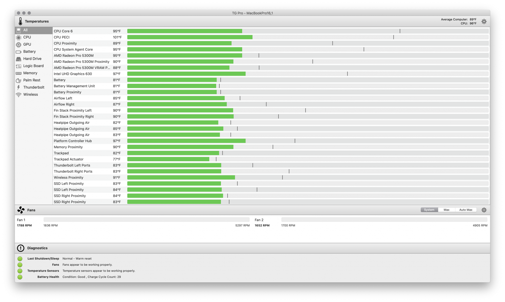

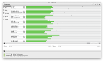

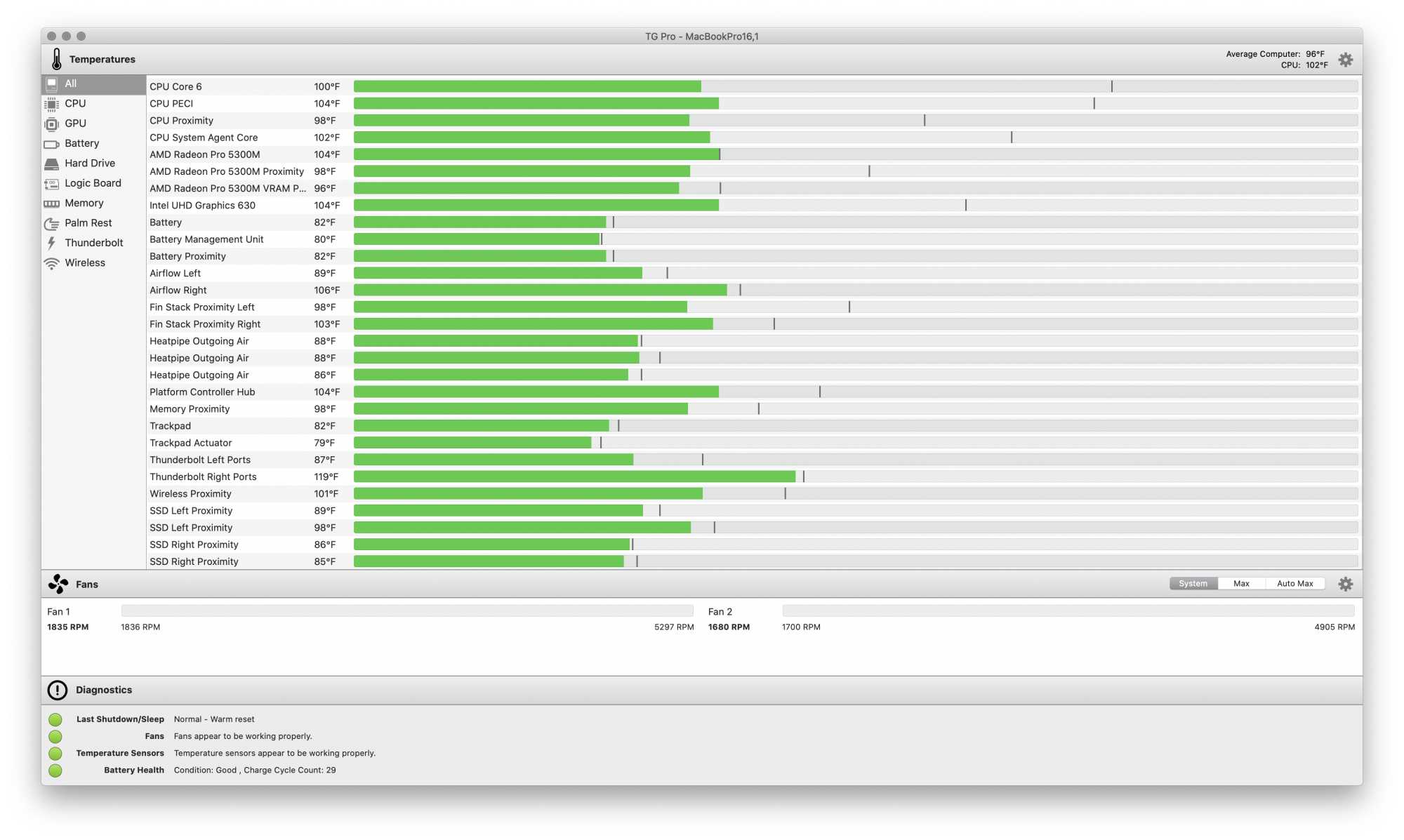

Screenshots below of temperatures with the TS3 vs Apple charger. These were taken right after waking up from sleep with the battery at 100% and no peripherals plugged in.
You can see the higher temps on the TS3, especially on the right thunderbolt port where the chargers were plugged in.

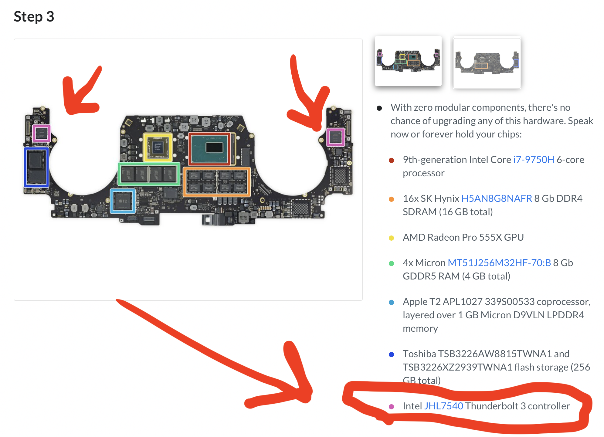

I have MacBook Pro 15 (2019) + CalDigit TS3 Plus.
And it get hot same as your Macbook Pro, because both side have a Thunderbolt controller.
Simple - when you use a Thunderbolt, Thunderbolt controller will be little hot. I don't see the problem.
