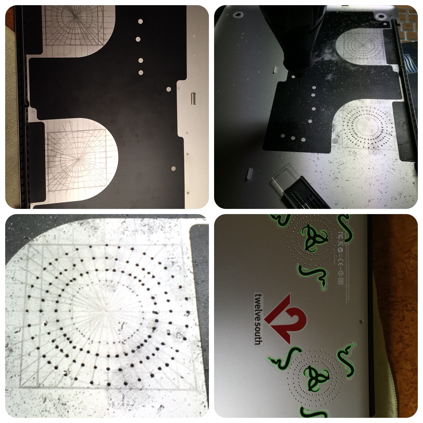

Since Apple, -after hefty legal pressure, admits that their MBP's are poorly designed from an cooling / engineering point of view, I wanted to share my cooling mod to mitigate this problem. Its not perfect, but it works and lowers working temperature for the chips significantly.

Wow! This is the best execution of the cooling mod that I've seen yet. Really tempting to buy another bottom plate to try this. How difficult was drilling the plate? Was it easy to stay in place and get a really precise hole?
my drilling experience..

Two things I would do different after this first experience:
1. The square for penciling in the marks for the holes was a bad idea. You should use a circle to mark it, - not a square. With a square you end up having narrower spaces between the holes in the corners, and wider spaces between corners.
2. A spiral design might be cooler and easier to do.
What worked out well:
Most important to use a bigger drill for removing the chips after drilling. The material was easy to drill and rather soft. There might be no need for piercing it before drilling as I did. That saves time, depending what drill you use.
A 0,5mm drill worked out well. I thought I might break one, but I did not.
The temperatur at heavy workload dropped at least 20°. That is a lot and it really does make a difference. With a good sticker, you can improve the result from a "so so DIY job" to "almost super".

I have PM'd you befor I read the actual post here. As we all know, the 2019 is a very hot running device. It might be a different story in your case, the mod might help more than in my 2010 MBP. What I would do different for such a new device considering your investment with all this External GPU of yours, see to find a machine shop with a water jet machine and get that baseplate drilled by a CNC machine or something of that sort. You would not belive how some people can produce a way better job than I did with just a little laser machine or something like this.
Here is an example what I mean.
See and find someone close to your location that can machine/drill thin Alu sheets and you will have a lot more pleasure with that mod of yours and it would not impact the resale value so much on a 2019 machine.
