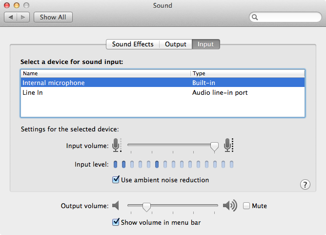

Just to be sure, in the sound preferances is the "Internal microphone" selected? Next up if it is do you see any change in the input level?

It selected. No changes at all, I also tried various frequencies for the mic. using the Audio Midi app that comes with the OS.

Could be a few things here, they did replace your logic board so it could be a problem with the new one, it could be that the mic cable didn't get reconnected, or your mic has died. In either case, getting to the mic connector of your Mac is a heck of a lot of work (you have to completely remove the logic board).
If I were you I would go back to the Apple Store and demand they fix it. I know that doesn't sound appealing but they have returned your MBP in a non-functional manner thus they should be made aware that the problem occurred and they should be making this situation right!
