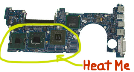

no i didnt heat the battery.. 🙂🙂🙂 however, top cover removed, and now i can actually physically see the harddrive shutting down. but where exactly is the logic board, is it the whole thing? the big green circuit board? it looks to be in great shape, nothing looks burnt, disconnected or damaged in anyway. this is really trial and error..
This photo is the logic board. Circled area is where I concentrate the heat (first time, I heated everywhere...not necessary).
There is a good guide in the Internet on how to remove the logic board (which I can't locate at this time).
You need:
T-6 Torx screw driver
#0 Phillips screw driver
and a "pudger" or small flathead screwdriver to lift/flip out wires.
there are approx. 19 screws to remove (not counting the outside case).
And 8 or more wire connectors.
**Keep track of where the screws came from and where the wires connect, so you can get it back together properly.
And probably a good idea to reapply some fresh heat paste (google it).
Try to find the logic board removal guide on the Internet...

thx for the info!!! i´ll see if i give it a try or suck it up and go to apple. i just found out we have a law here in sweden that you as consumer have a 3 year warranty on these products, and if i can prove that this is the manufacturers fault, bad components etc. they have to repair or replace free of charge. so im gonna try my luck with that one. but if that fails i guess its off to by a heat gun and have fun. think im gonna buy a new mbp anyway, so it´ll be fun to experiment on this one. i´ll keep you posted! and again thanx so much for helping out!!
ok. i baked the logic board in the oven, put it back in, and screen lits up!!!! chime!!! then dies again. at one point i actually saw the apple logo just before it died. should i bake it again? its crazy but this works!! sort of.. im baffled. btw i didnt have any thermal paste, and it was nearly all gone, maybe thats why it dies? like a safety overheat thing?
edit
ITS WORKING!!!!!!!!!!!!! I CANT BELIEVE IT!!!!!!! BUT it shuts down when it gets too hot. i guess thats the missing thermal paste. putt putt if ure ever in stockholm ill buy u a beer. !!!!!!
So thermal paste applied. everything is running perfect. im typing this on the former dead macbook pro. baked logic board and new paste. and a proper dust off... im crazy happy!
