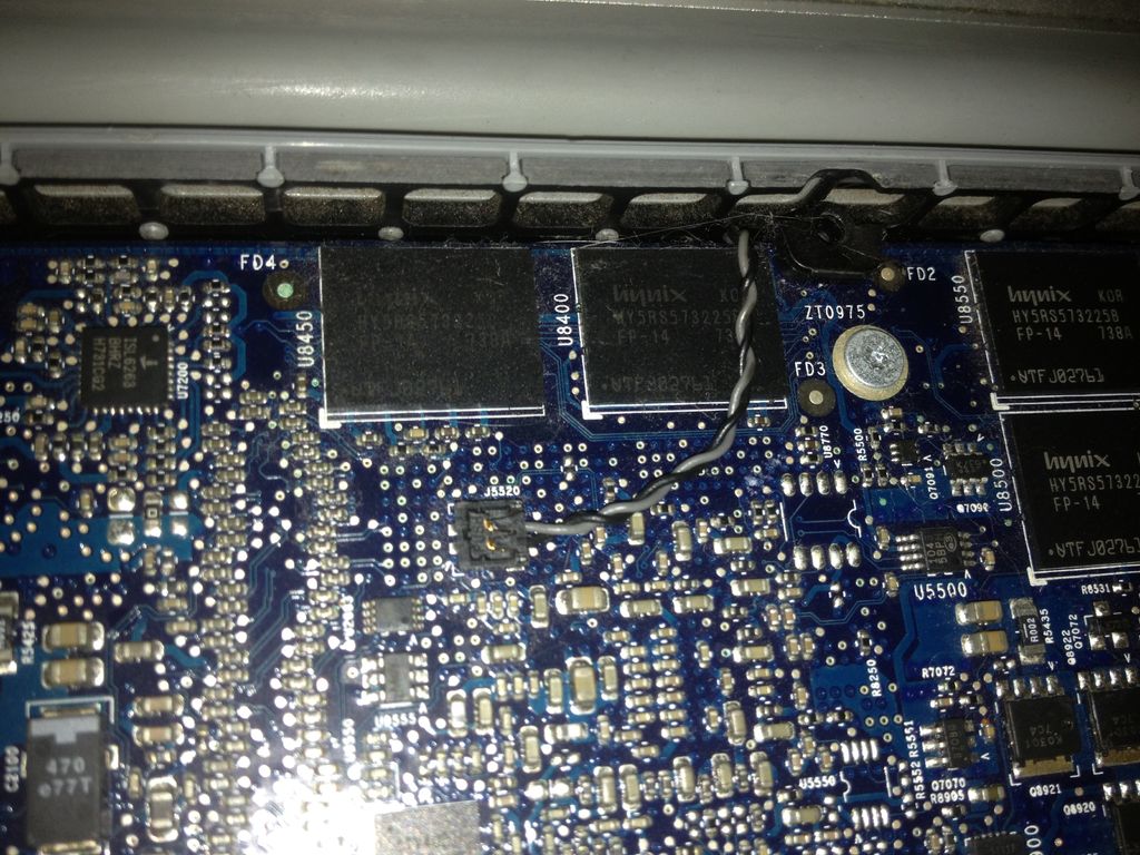

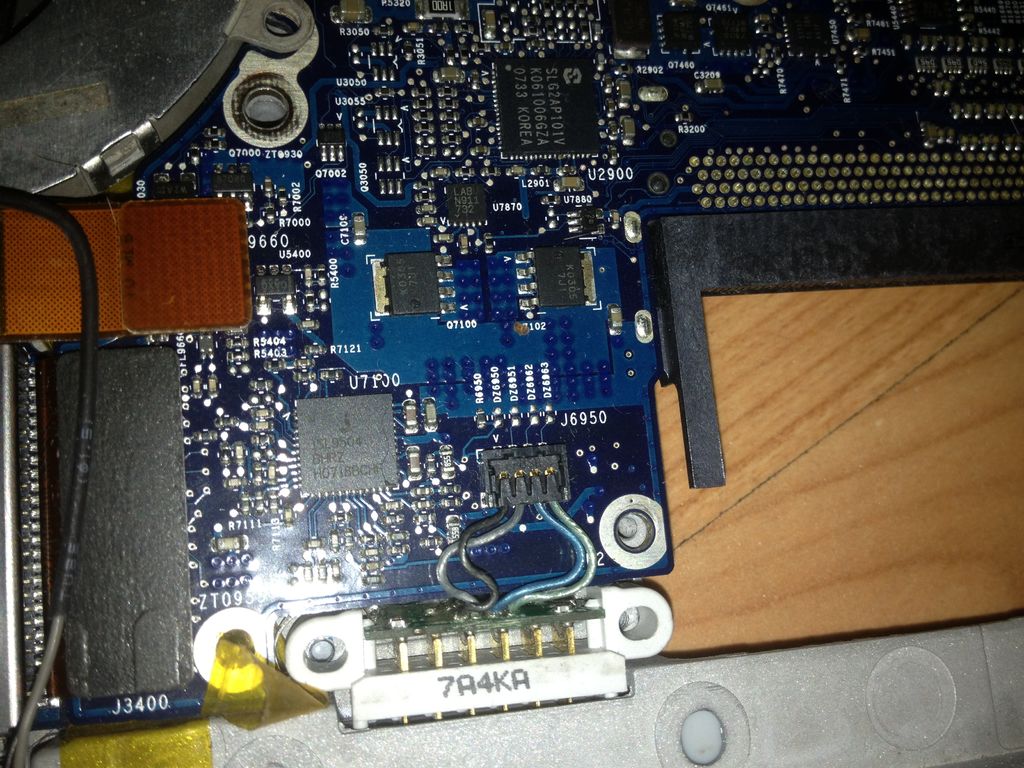

Are you very sure you connected the sensors? and also the battery connector (White or black in color depending on model)?
EDIT: I took out one of my scrap/spare part MacBook Pro to take a pic to show you.
This is responsible for thermal management. fan goes full blown if this is not connected
This is the battery terminal connector. Battery not detected if this is not plugged in.
Yes. That sensor at the center of the board measures temperature from copper ad there's two more below both fans.. if one of them is off both fans will run at 4000rpm...
battery connector also ok.. It's something else that i can't understand yet 😀
