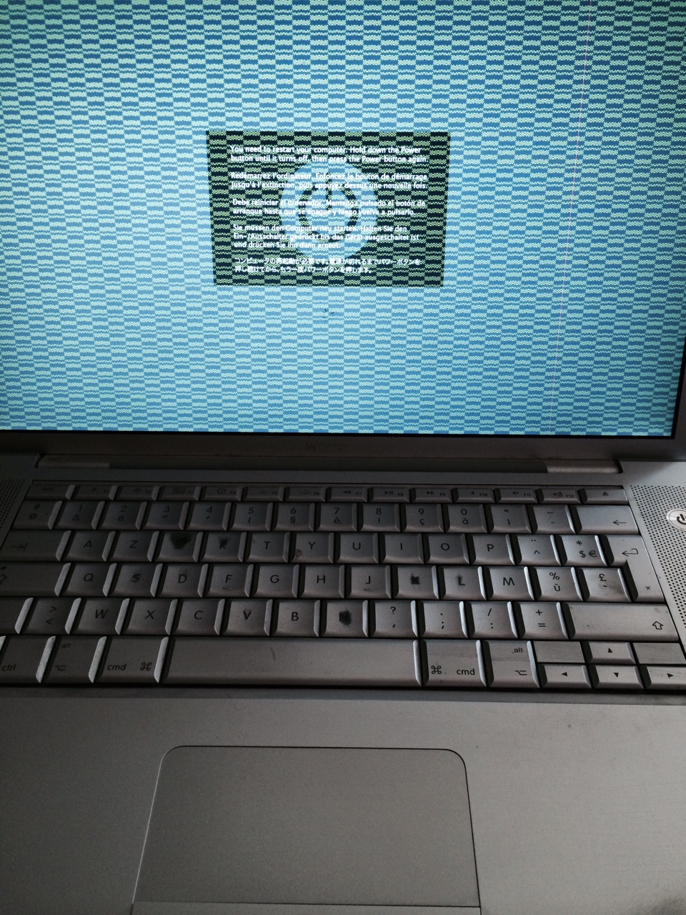

After 50 restarts I got a good working computer for a few minutes.
Is this a problem with the video card and how to solve it?
GPU is dying - nothing can be done except replace the logic board, which is not an inexpensive proposition 🙁
what I tried :
PR reset : nothing changed
safe mode : green lines have disapeared for 2 minutes when loading but now are back. after starting I was able to use this computer only has a small red line in the screen.
Now my question, how style is my laptop?🙁

on the bright side, your data is fine. You can use target disk mode or take out the hard drive and get your data.

Your GPU is likely dying. Your data's safe, but it's not likely to get any better.
Your computer is 7 years old, that's quite a bit. Most laptops don't last that long.
IMO, it's not worth repairing due to its age, but that's me.
I along with every single other person who was unfortunate enough to own a 2007 MacBook Pro seems to have been affected by this problem.
Essentially yes, the motherboard is dead.
My recommendation would be to replace the MacBook but if you don't mind taking a screwdriver and a lot of patience to it you can often find replacement motherboards for it on eBay for a fairly reasonable amount. Just do keep in mind it's a known issue with this model and it'll almost certainly reappear given enough time.

Isnt there some trick around?
Like putting the logic board in a heat oven?
i already used 2 macbooks after this one but now I"m active here on macrumors I want to try and fix this old one
Some folks have baked their logic boards to revive them but it seems to be a temporary solution.
Personally, if be shopping for a replacement.
I had the same problem with the same machine a few years ago. It was a known problem, Apple replaced my logic board, and everything went back to normal.
Unfortunately, the extended replacement period is over now, so you're looking at an expensive logic board replacement, or a new machine. Even the lowest end MBA will be much faster than this machine, and potentially cheaper than the logic board replacement, so I would recommend the latter.
There's the "baking the logic board" solution, which may work, but I know that this machine, without an SSD is slow as hell, and I wouldn't wish it on anybody. It's what I'm using right now between selling my iMac and buying a new rMBP and it can't really even handle Netflix.
Baking method actually worked! me happy 😀
Baking the board will only work for a few times. Each time it will work less longer than before. Soon it won't fix it at all. You'll get about one more year out of it with additional bakings before it is completely dead.
