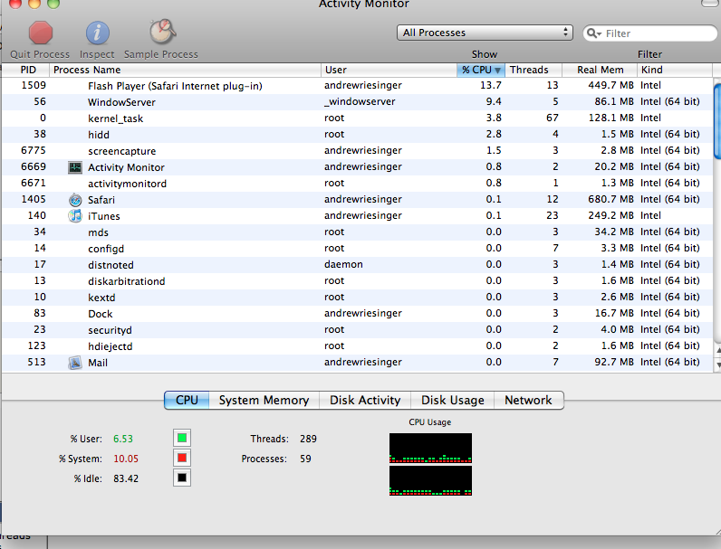

hold on ill redo it ignore the pic below
yes i have calibrated it. Ill do the other stuff after the Apple appt, do I need to back up anything in case I get it replaced? no idea how to do that but ill ask the apple guy too
Thanks, that screenshot is alright, but as I said before, the CPU does not seem to be the culprit, as only 16% of it are used. Thus again: SMC reset? Calibration? Did or didn't you do that, and if you did calibrate your battery, how often did you do it?

I am just going to take a guess but the reason you have poor battery life is that flash player is using 13% of your CPU while it should probably be idle.
I mean if you are just viewing the activity manager and everything else in the background is idle, your CPU usage should be no higher than 1-2%.
Kill the flash plug in and calibrate your battery and you will be fine.
I have a 2009 17" MBP and when I use it on battery, I get up to six hours of use out of it, even when the CPU is used between 10 - 20% (both cores).
17% CPU usage (both cores) should not affect battery life that much, as the Flash plugin only uses 13% of one core, so it's only 38% out of the 17% used on both cores.
Well this is about a 13" which does not have as big of a battery, and then at least on my 13", if the laptop is anything more than idle, the battery life indicator drops dramatically.
I have seen it with the backlight dimmed say 10+ hours, and as soon as I touched the trackpad, it would drop to 5-7.
While this is the extreme, it seems to be typical that any use of the CPU dramatically alters the battery life.
All I am saying is that the thread starter should at least try killing the flash process and see if battery life improves.

i quit the flash player...what happens now? will i not be able to watch flash videos?
Flash is a CPU hog and of course will kill the battery's charge. This is well documented. And maybe you should kill it now because you are diagnosing a problem. You can restart it later.
