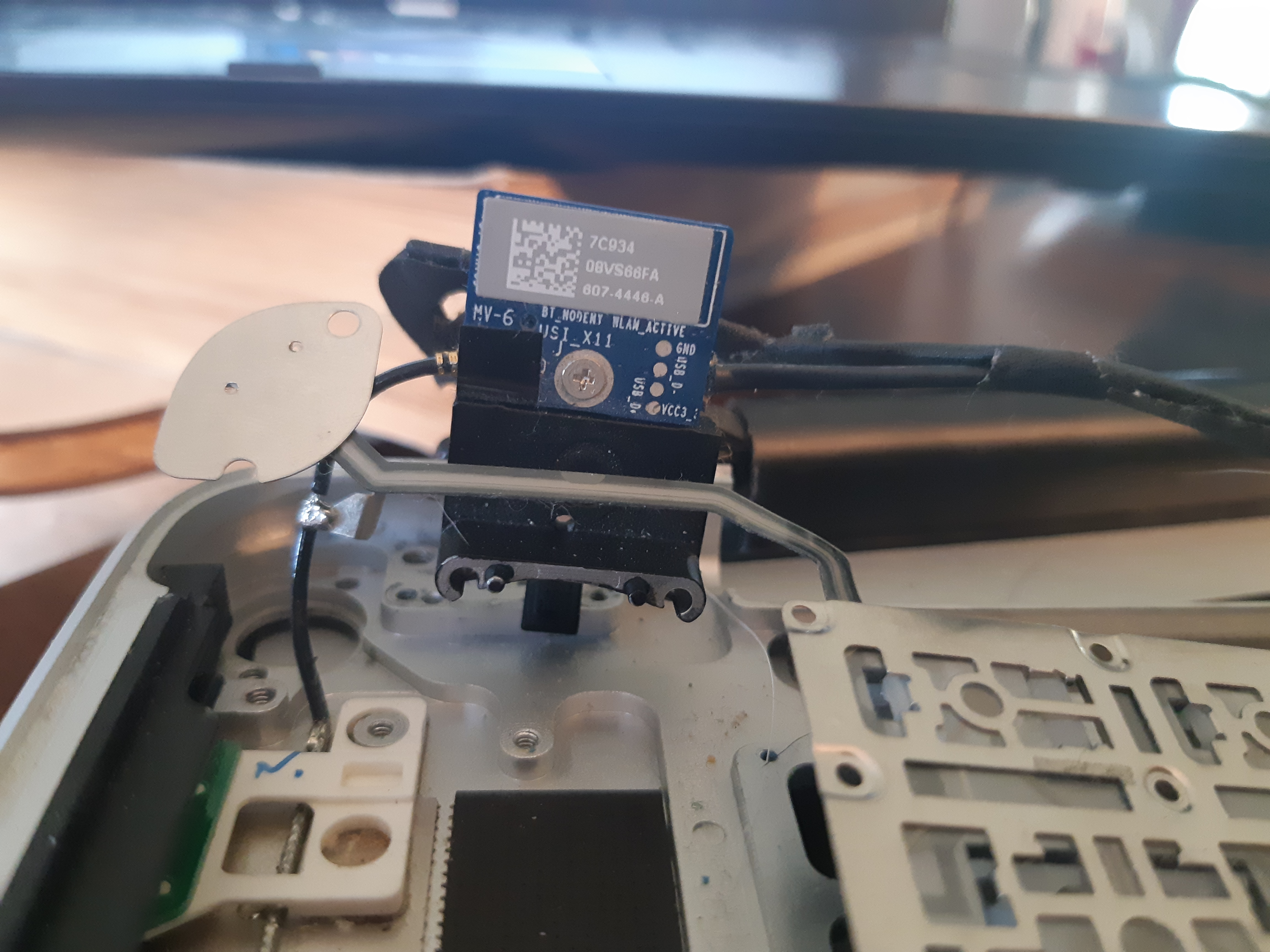

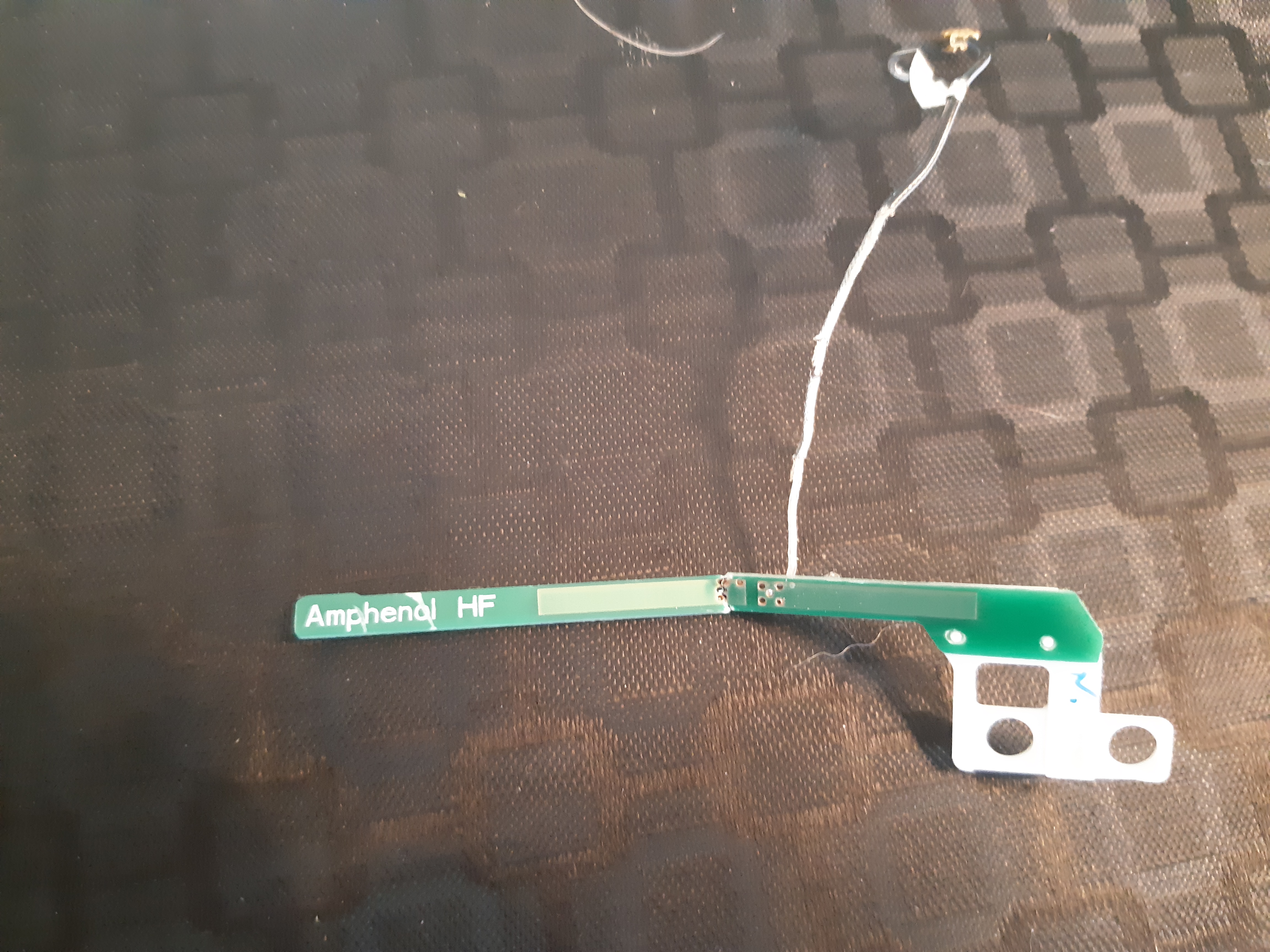

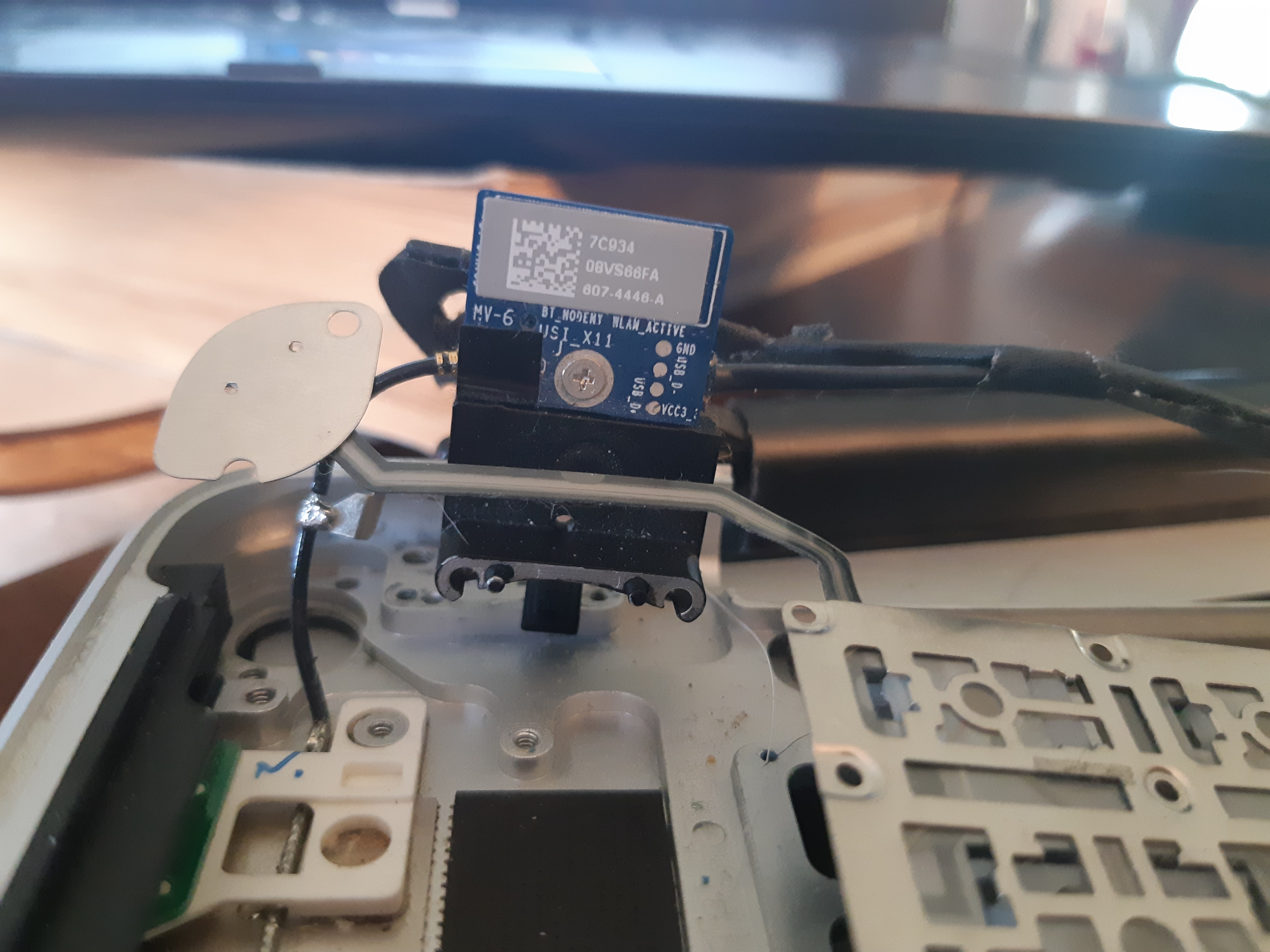

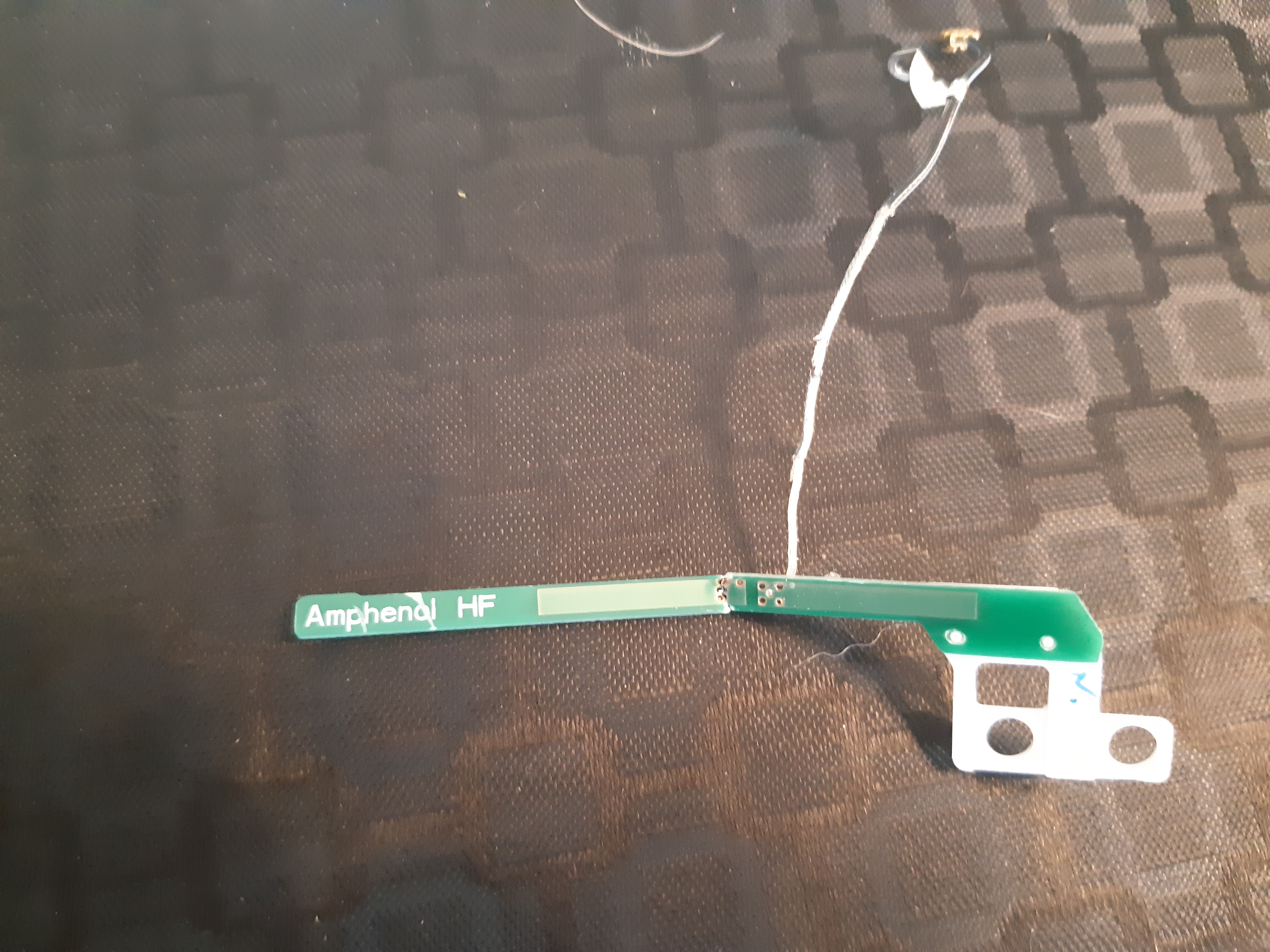

Anyhoo I am currently changing out parts, and I broke the Broke this part below and says AMPHENOL HF and on the left of the BT and Wifi card. This green board is just under the DVD drive and connected to the BT card
Does anyone recognize it and know a part number, or is it needed if I don't care about Bluetooth. I seen one on Ebay in the UK but it is not quite the same, but at least that one has a Part # on it. Mine doesn't

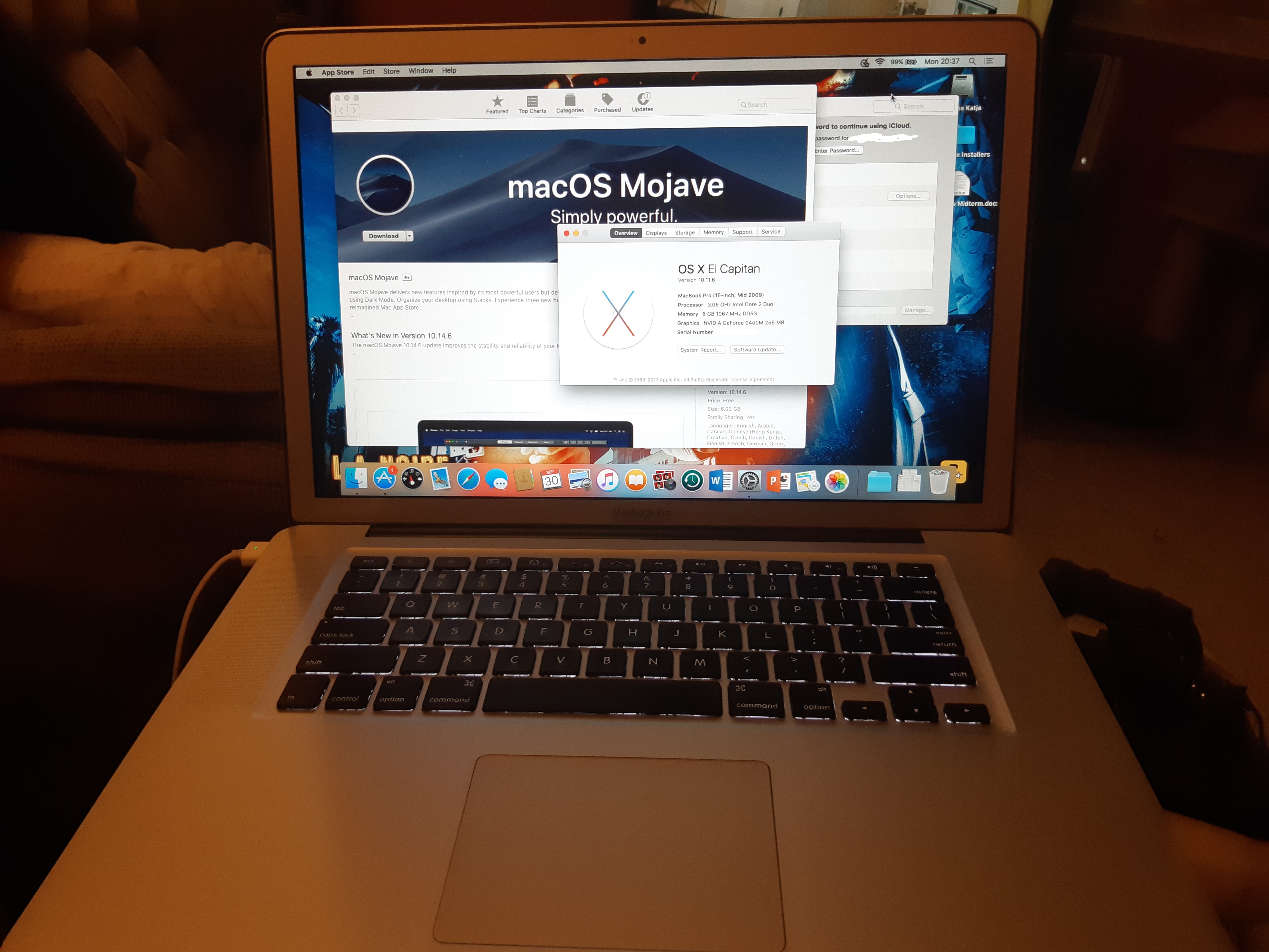

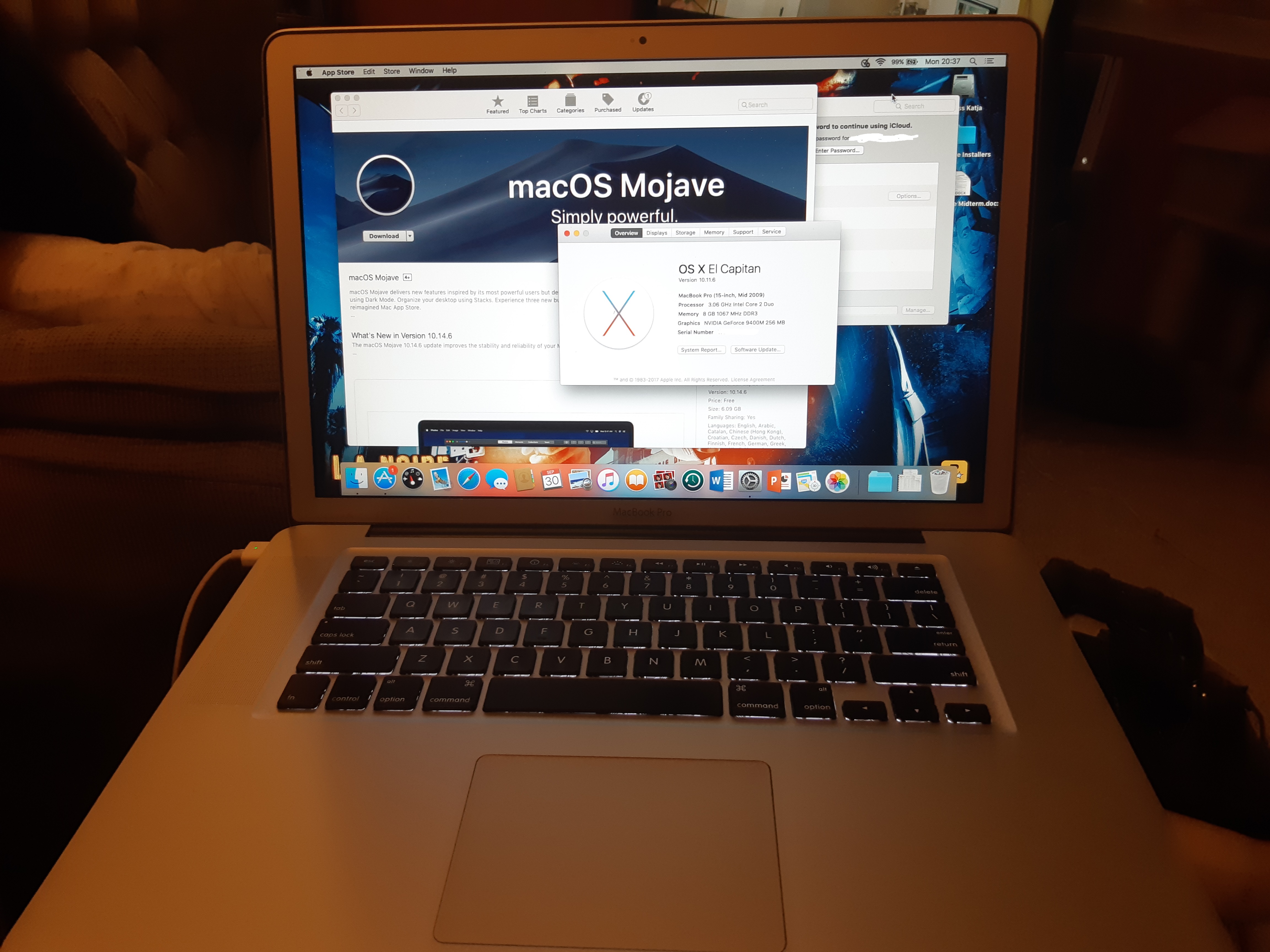

Well I finally had some time this past weekend to get this laptop up and running. I did also buy the the BT Antenna as well
Thanks for your advice and help on this. Pretty much a new laptop now. I am happy with it
