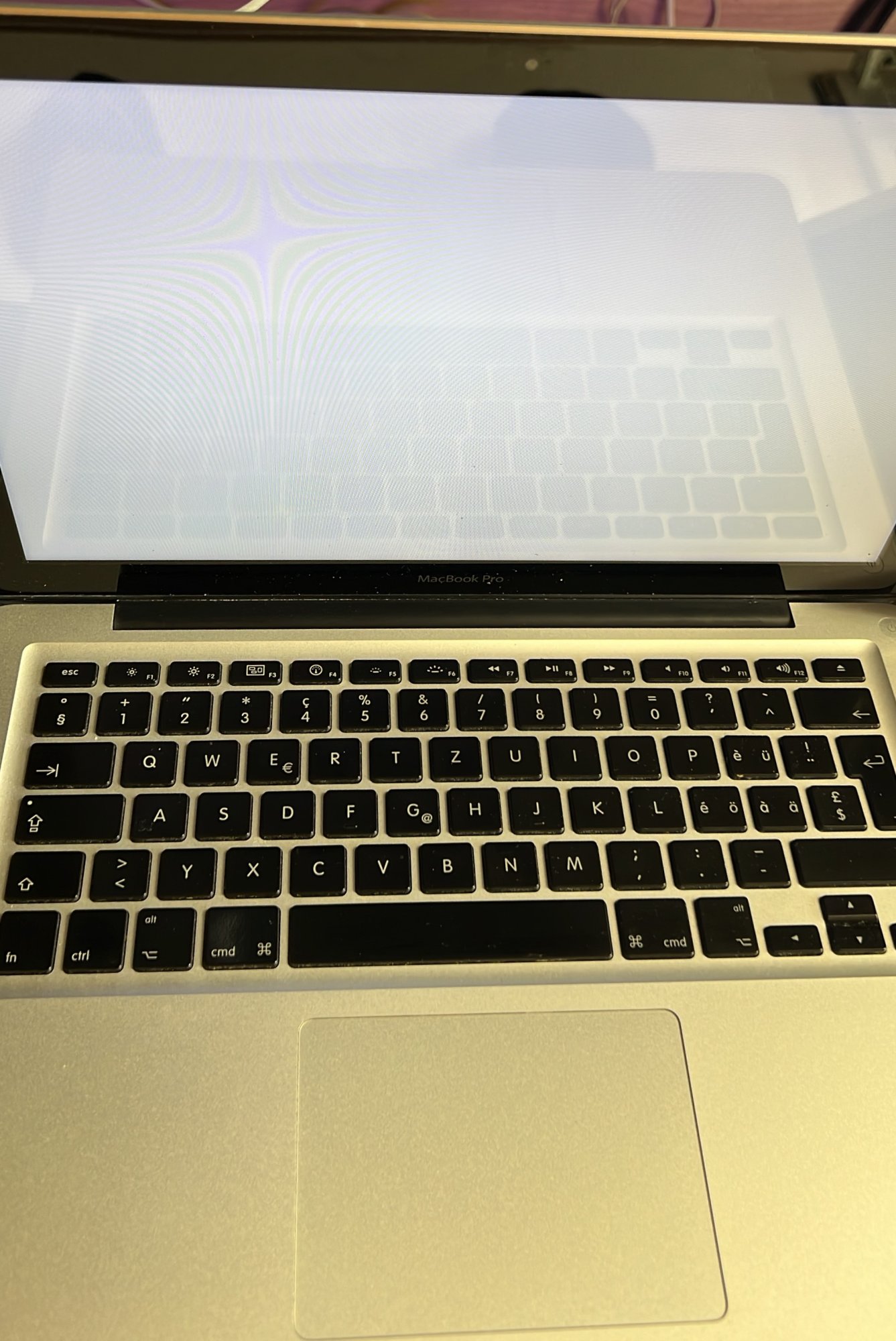

Hello
Sorry for my bad english, i'm swiss 🙂
My MacBook Pro 2010 suddenly got a whitescreen after formatting the HD, access to the bootloader is not possible (ALT), no Apple logo, no folder icon, nothing.
The internal SSD was formatted by the previous owner. But to boot from the USB, I have to press the ALT key... and it doesn't respond, no matter if external keyboard or internal.
I have installed Mac OS via an external Sata adapter on my MacBook Air, but he also does not want....
No idea which MacOS was on it before, I only know that Windows 7 was on it. I think but the High Sierra on it. MacOS Sierra is supposed to be on it.
The Mac does not react to any keyboard input, so when I press T nothing happens, when I press ALT nothing reacts.
I left the Mac without doing anything, with the USB stick in it, but nothing happened, only a white screen.
The startup sound comes.
Previously never apart until this error, only an SSD was installed nothing more.
I installed MacOS Sierra via this USB stick with the SATA adapter via my Macbook Air.
What I also noticed is that the Mac also does not want to boot from the original Snow Leopard? CD will boot.
I hope someone can help me, specs are
C2D 2.4ghz
8GB Ram
250GB Samsung SSD
BJ. mid 2010
LG Astarana2007
