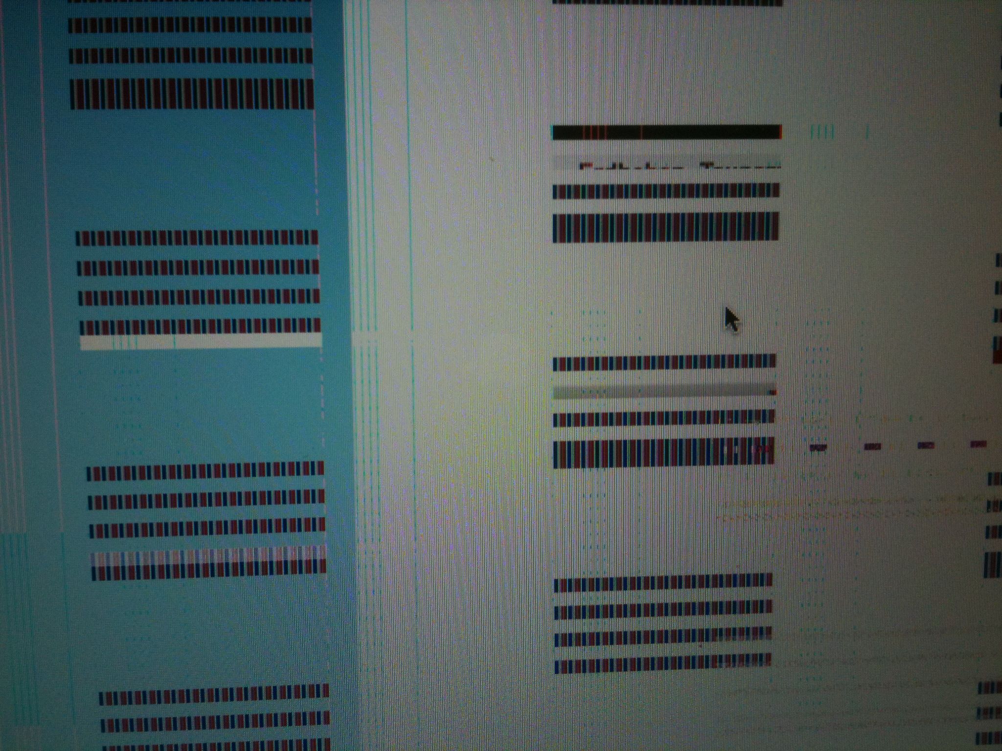

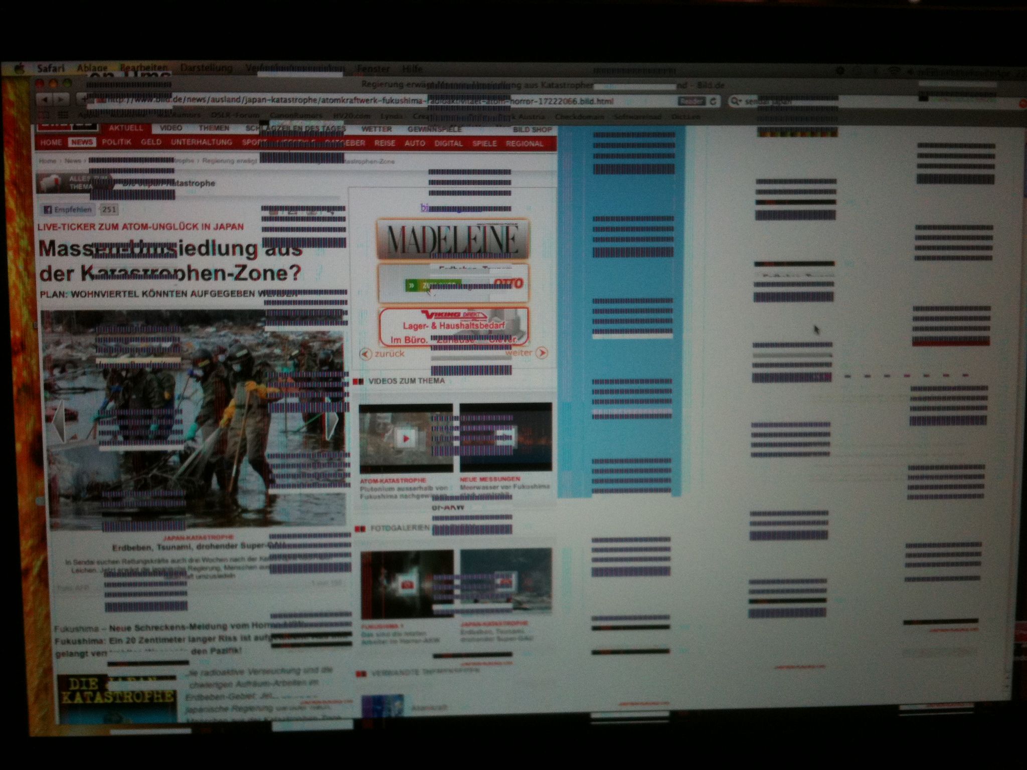

hi,
i experienced very strange behaviour of my macbook pro 2.2 i7 lately. its one month old and it freezed the first time after two weeks, then second time about one week later. impotant to say, one time it was under heavy load and second time it was just safari.... however what happened two days before i never experienced before! my macbook pro suddenly freezed accompanied with an awful (unbelievable) loud sound! only comparison i have is the sound of a fax machine but much much louder and defenitely much worse! i had to do a hard reset, then restart after 5 minutes same issue again and again. i was pretty sure this has to be a hardware issue..... and was preparing for sending it back to apple.
however i did a (save) restart holding down the shift key and repaired the disk preferences and since two days the mac is running without any issues... even under heavy load. so now i think maybe its a software issue again ?! what do you think?
i have installed 10.6.7....
do you think its possible a bad ram modul can cause somthing like that? i've installed 8gb 3rd party ram because i use the 4gb apple ram for my wifes macbook.
here are two pix how my screen looked after freezing.....
best regards

Ouch. Run the hardware test to see. (hold D on boot). It very well could be the RAM, videocard, or something else.
I had the same problem with my new 2011 i7 2.3 and apple told me it was the video card, was replaced no questions asked!
when i spoke to applecare they told me they already heard there maybe a video card error!
My replacement MBP is fine!
Wirelessly posted (Mozilla/5.0 (iPhone; U; CPU iPhone OS 4_3_1 like Mac OS X; en-us) AppleWebKit/533.17.9 (KHTML, like Gecko) Version/5.0.2 Mobile/8G4 Safari/6533.18.5)
My old 2007 MBP would freeze and make the terrible noise I think you're talking about. It had one of the faulty 8600m chips so you may very well have a bad gpu. I would get it repaired or replaced if I were you.

thanks for the info hammie and viper, i guess thats what i will do.... 🙁
no not beeping it was a really heavy noise, its just hard to discribe. i didnt even know that any notebook can produce such noise without external speakers. it was (at least felt) much much louder than the built in speakers.
