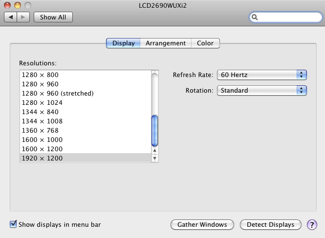

You must go into the Display in System Preferences and set the resolution for that monitor. Once done it should use that setting every time you plug in that monitor - using a mini-display to DVI connector. I have a 26" NEC monitor with 1920 x 1200 so I use that setting.
yes on that screen, i dont see 1920x1080 as an option (which is the max res for my 24" monitor)
