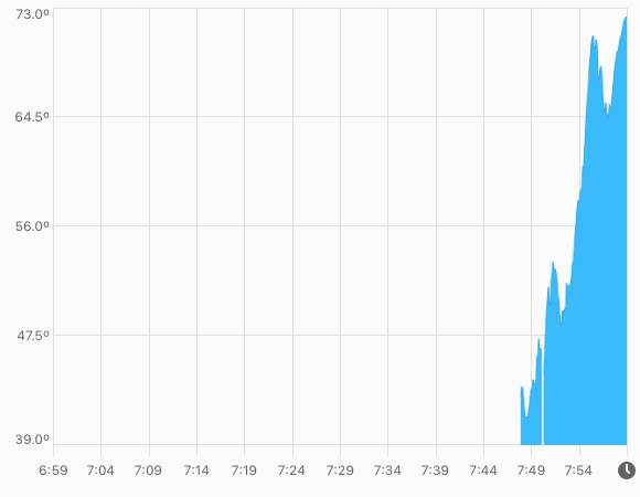

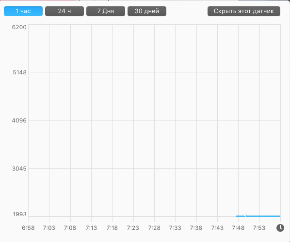

it keeps it on 2000 even on 90 C (checked it with iStats)

Yeah, 2000rpm isn’t normal. The fans can go upwards of 6000rpm but after I changed my thermal paste, mine hit about 4500rpm in the mid 90’s C.
If your CPU temp hits about 105 C it’ll start throttling. The computer won’t just turn off.
First thing I’d check is if the fan speed changes at all. Mine is about 1600rpm at idle and 4500rpm at load. If yours is constant at 2000rpm, personally I’d do an SMC reset, check the fan connector and check the fan is original, since you’ve had someone working on your machine.

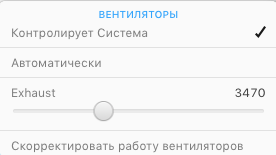

Question, do you happen to have the iStat set to keep the fans at 2000? I know there used to be the option to regulate the fan speed through that application.
Also, have you tried resetting the SMC?
