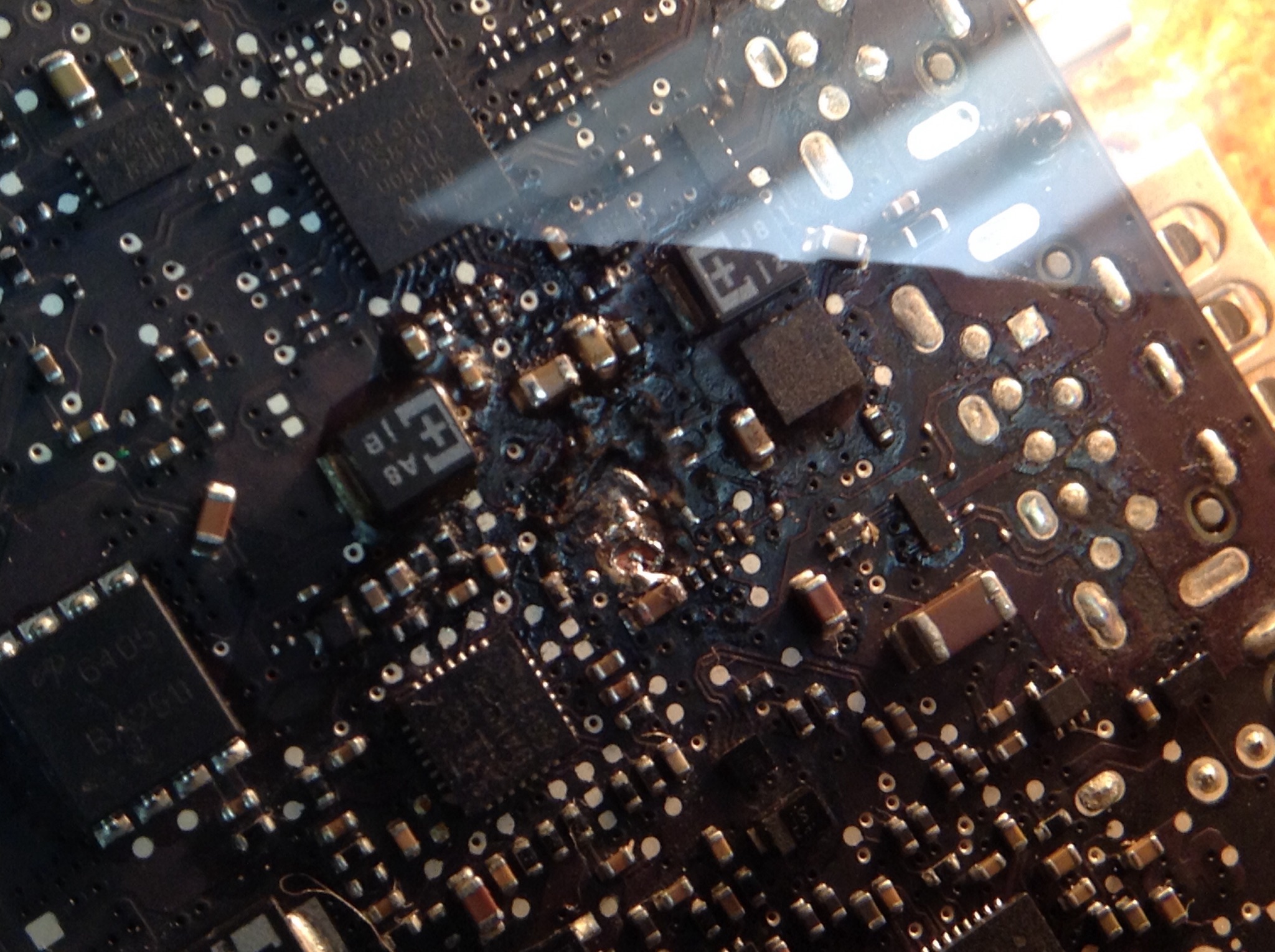

Can someone please help no power or green light I sent it out to be fixers the guy said it also had issue with SMC internal bad traces. that he wasn't experienced enough to to fix.

The green hazy substance around the chips in the center area of your picture really looks like corrosion damage from a liquid spill.
Or, the very center has a large mass of melted solder, which could mean overheating, or, again, damage caused as a result of trying to boot up when there has already been damage, again,probably caused by a liquid spill.
Yeah, I come back to that a lot, because of what it looks like - and the common damage that I see resulting from a variety of different substances.
Your choice for the fix?
Get the logic board replaced.
I don't think that anyone can repair that damage in the center of your picture.
Because of that, your choice is purchasing a replacement logic board.
Reactions: CoastalOR
Thank you for you're reply delta. the large solder ball was from a guy I sent it to repair it . Prior to sending it I removed the chip under the chip it had no solder a few of the traces and pads where burnt.
So I will get a used logic board thank you
