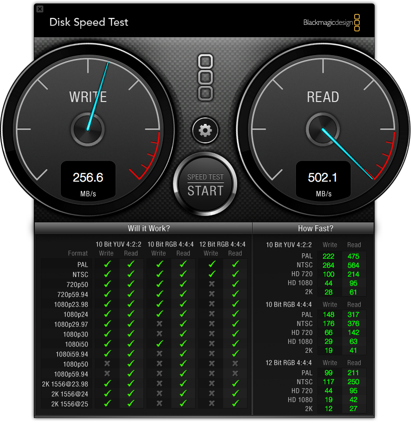

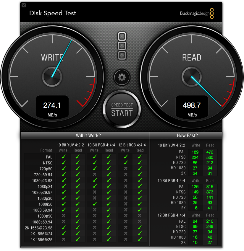

got the crucial m4 256 gb, am i good with those results?
