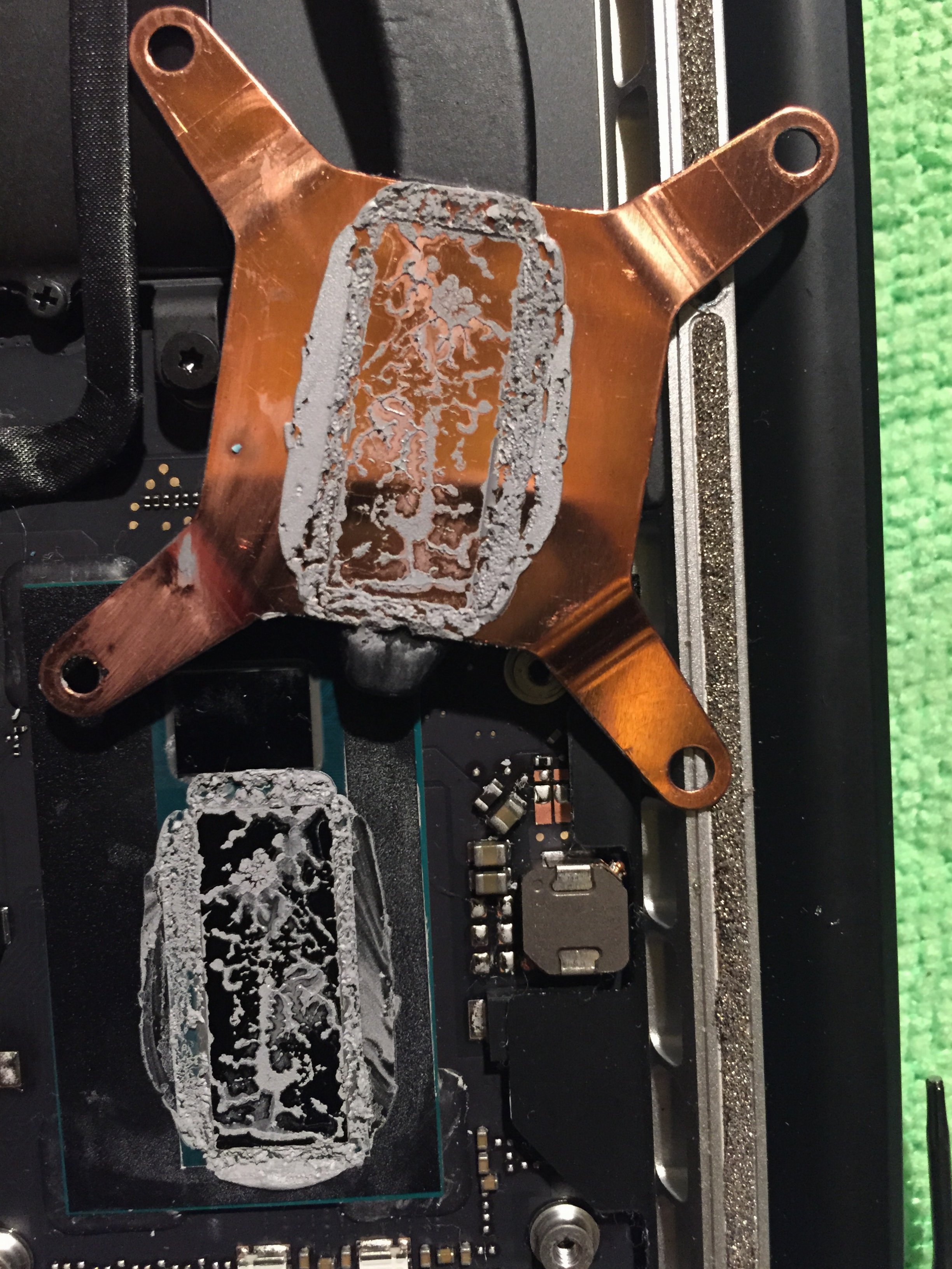

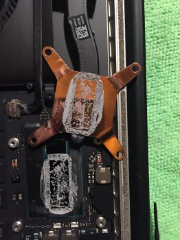

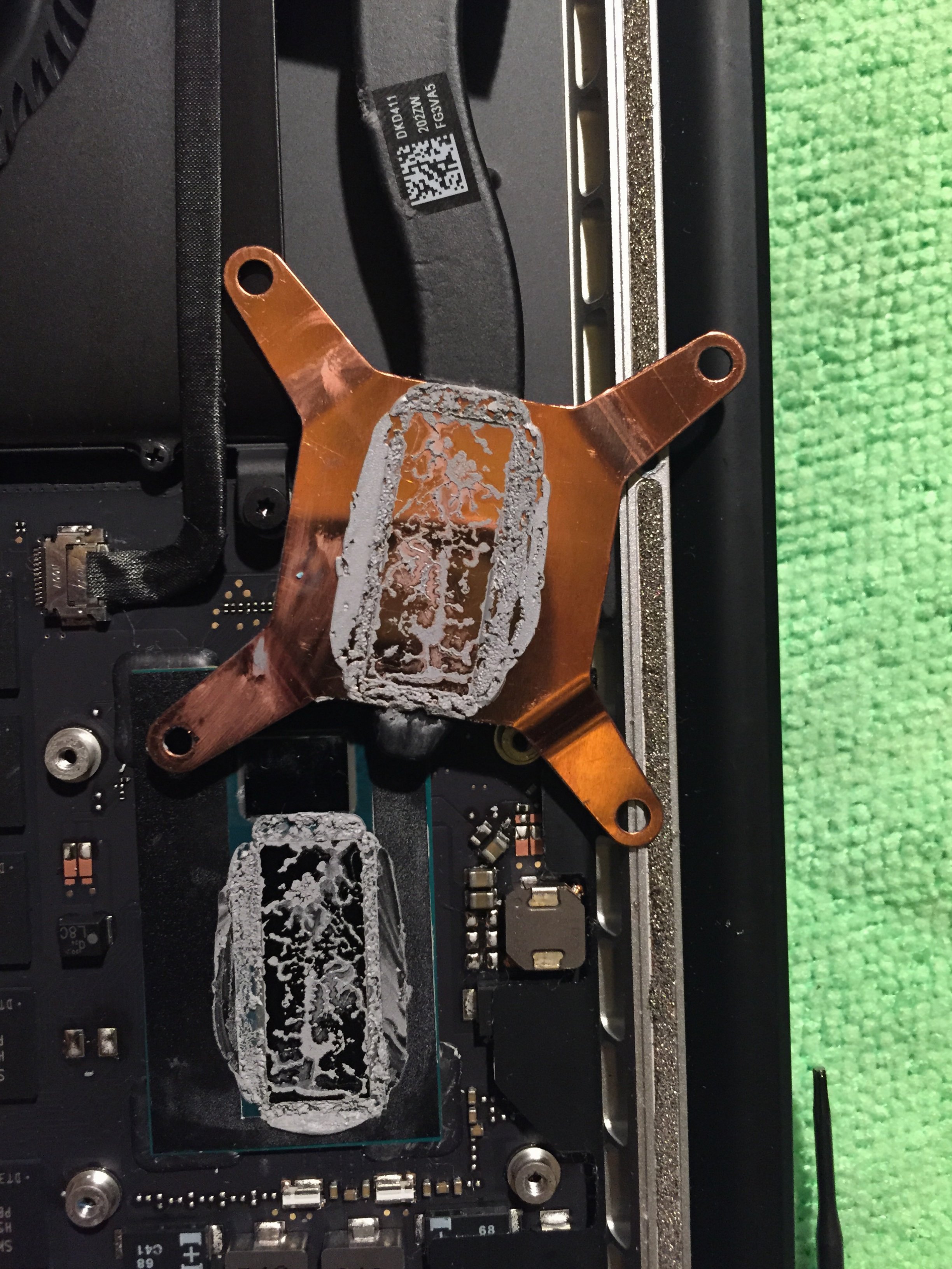

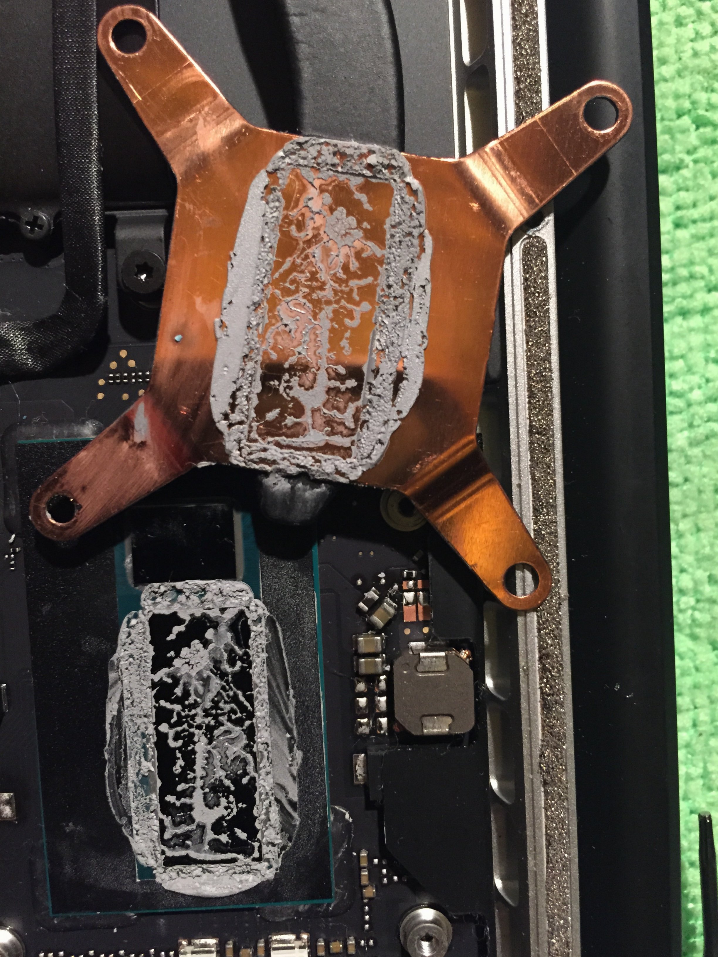

I would recommend replacing it. Apple uses too much TIM and too cheap. It dries out in less than a year. I have changed TIM on 5 different Macs. My late 2014 Mac Mini TIM was already dried out and running hot. The CPU proximity temp dropped by 20 C and the aluminum top of the Mini is no longer hot as a frying pan. The pictures are from a mid 2013 rMBP. Look how dried out the paste is already. It's running about 17 C cooler. I use Arctic MX-4 and love it. 2 hour cure time, temps on par with arctic silver 5 minus the 198 extra hours of "burn-in"
