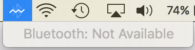

It says "bluetooth not available" when you click the bluetooth icon. I have tried all the "common fixes" for this problem.
That looks like a logic board issue.
If the antenna was loose or damaged, the Bluetooth and WiFi range would be low but available.
