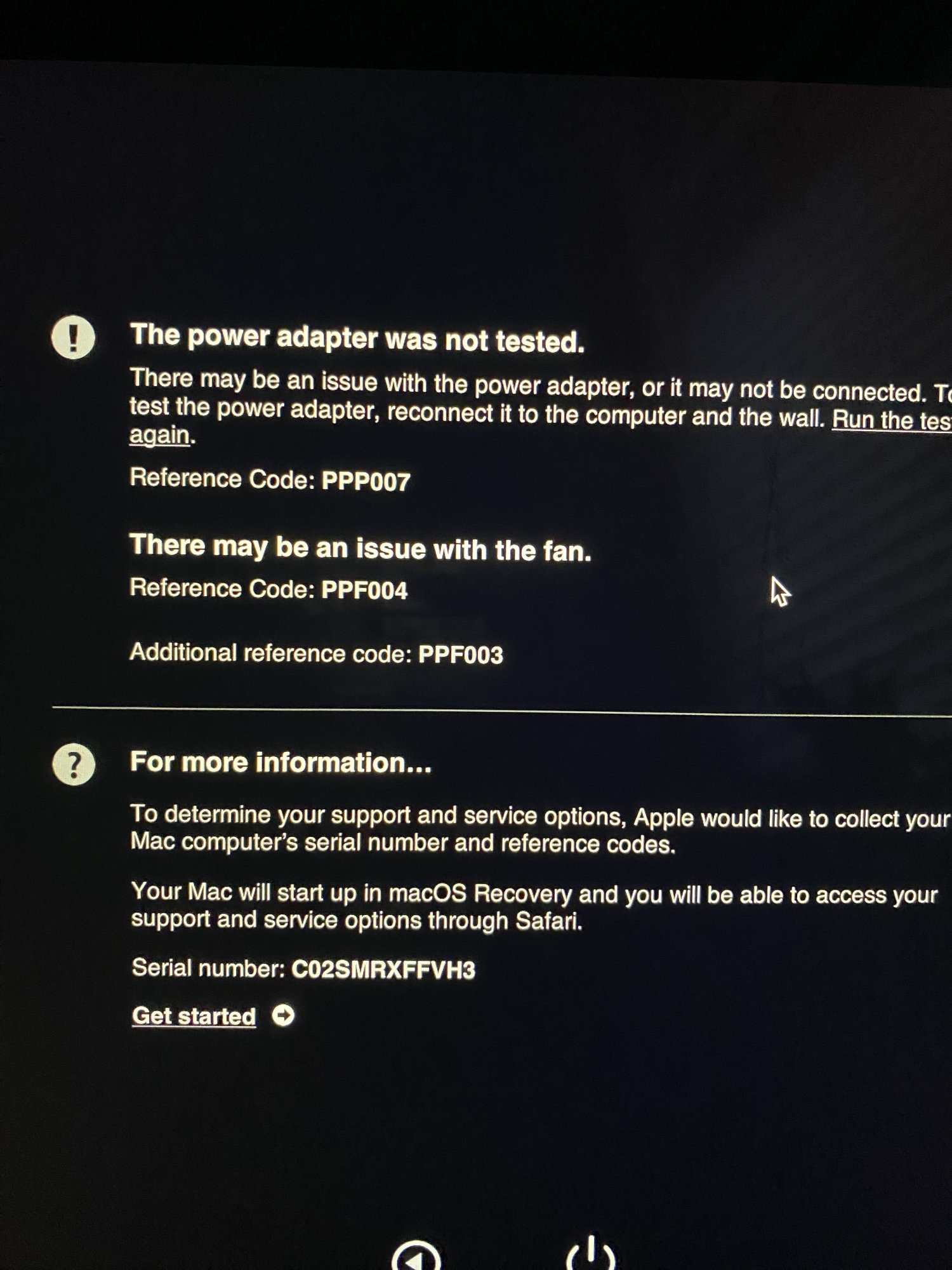

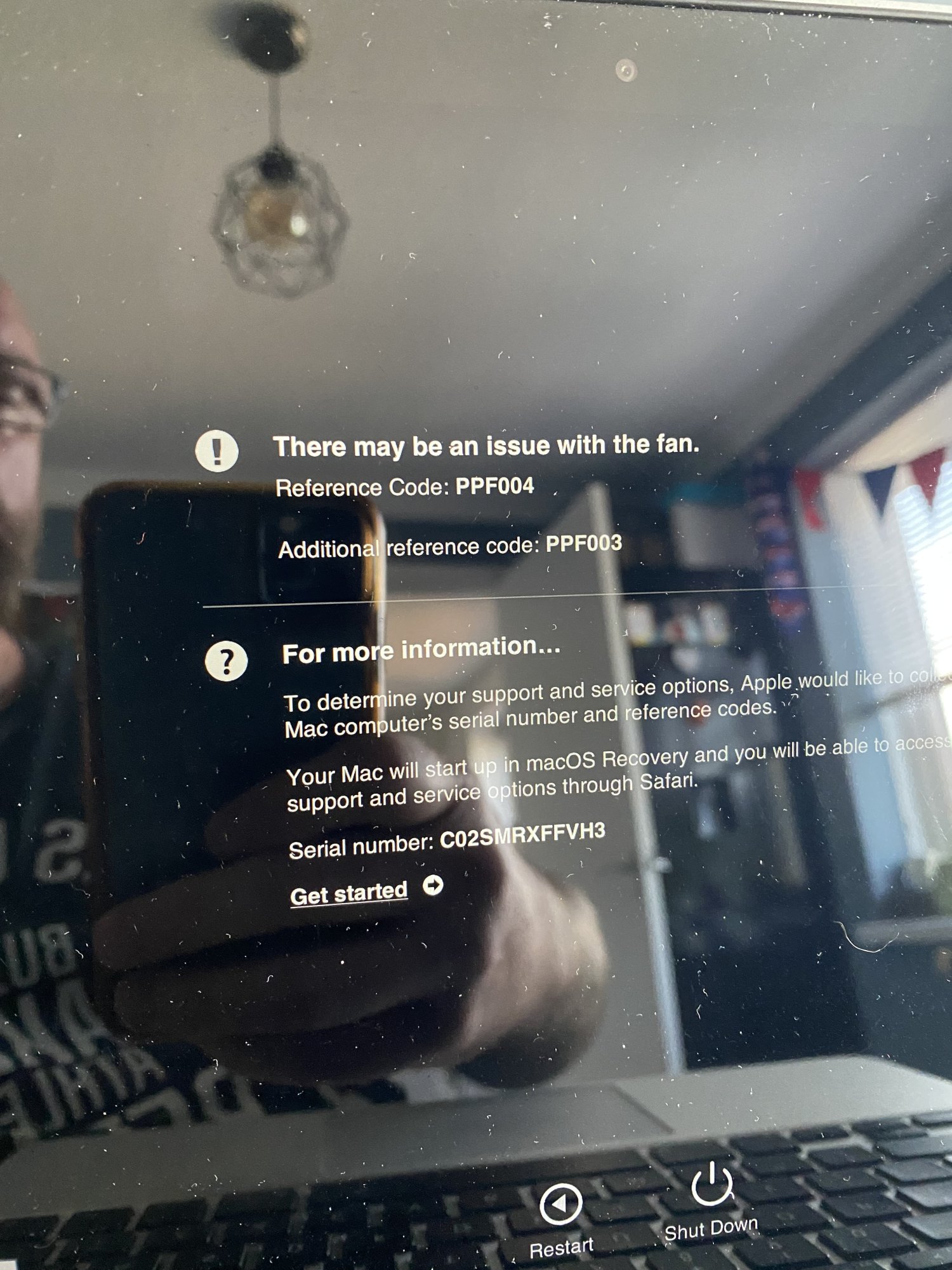

When I started MacBook up and hold down “D” it ran a diagnostic and came up with the following.
Sometimes diagnostics will spit out random error codes that can be ignored. Try the test from my previous post to confirm it's broken. The Mac has that safety shut off if it does overheat. If the fan really does not work, there are two possibilities, either a simple cheap fan replacement does fix it immediately - or the issue is actually with the logic board itself that has the logic/controller on it for turning the fan on. If that is the case, the fan replacement won't help, but you won't know until you have tried that. Sadly that model only has a single fan, in models with two fans you could just swap the fans around (Edit, actually that is not entirely true, the fan connectors aren't always the same and could prevent swapping).
