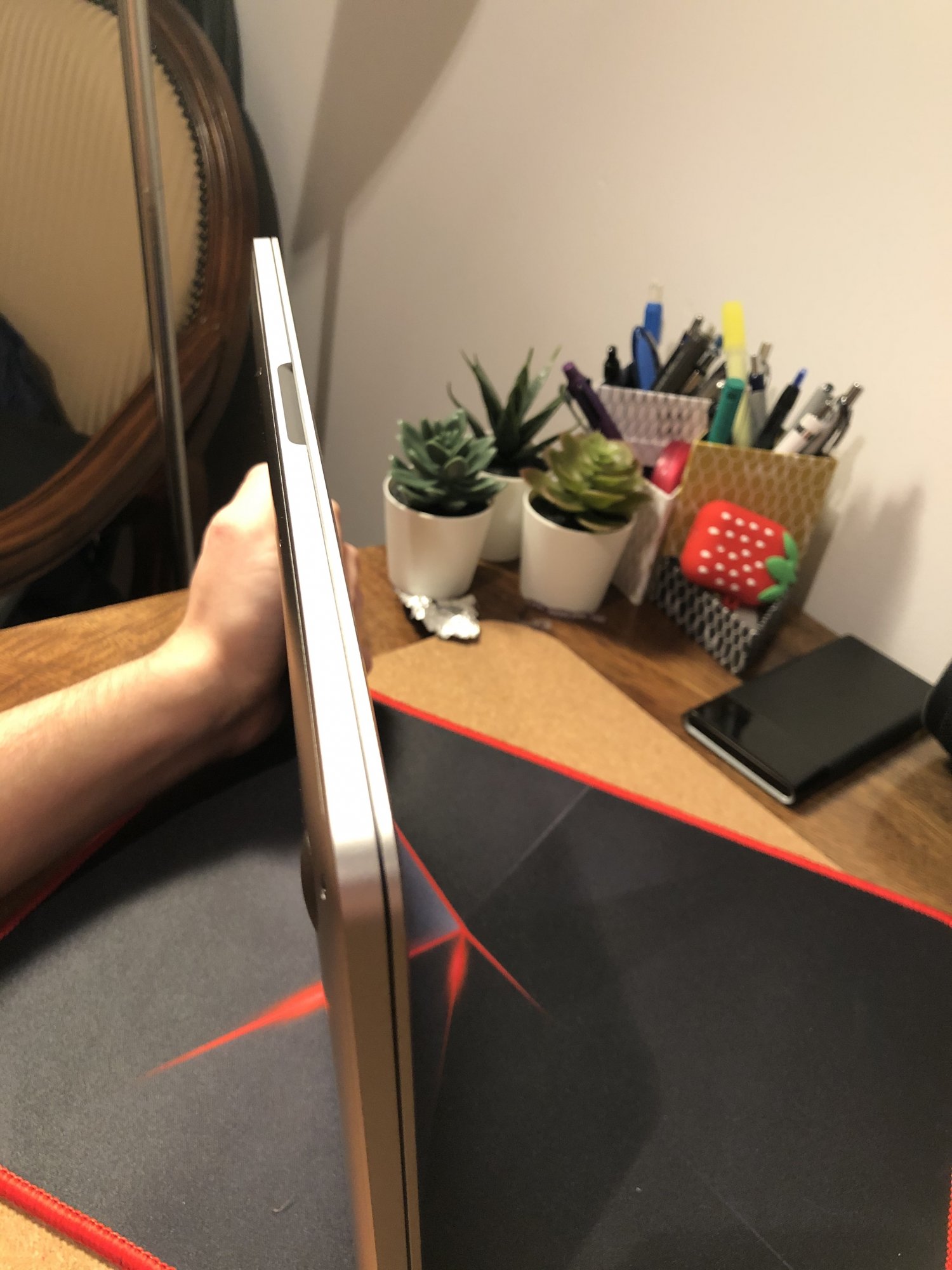

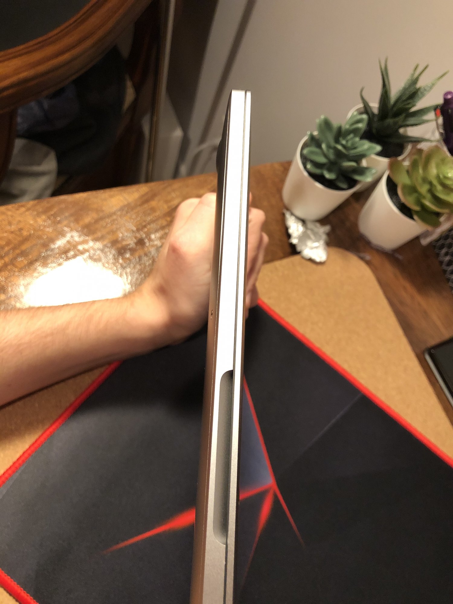

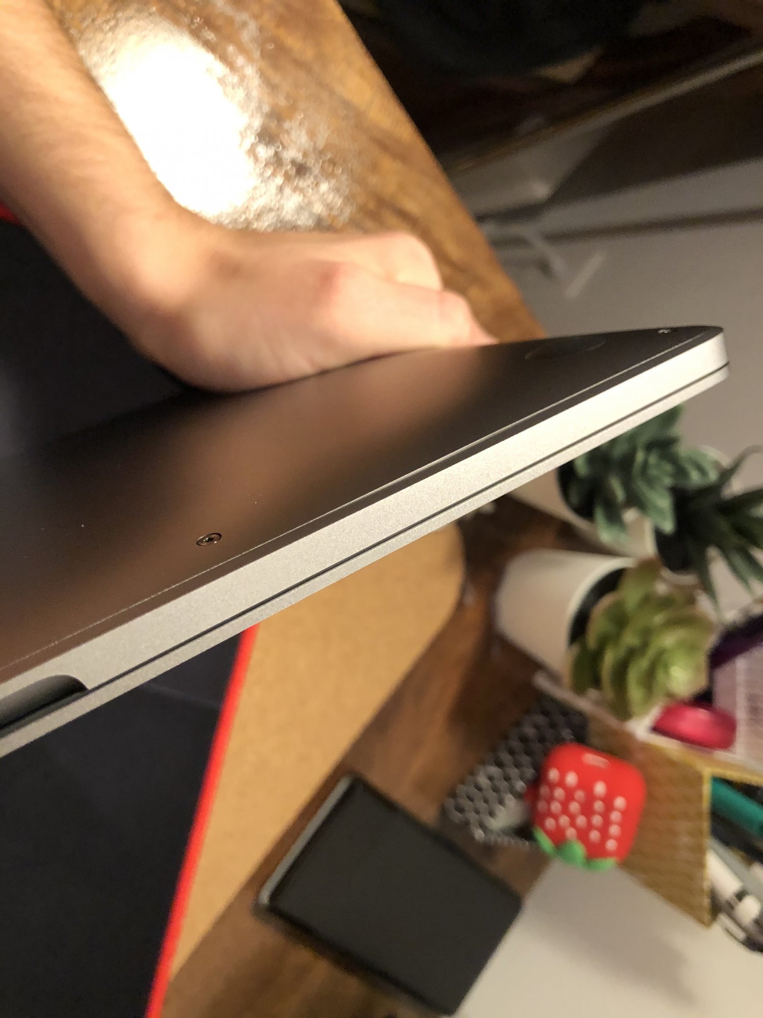

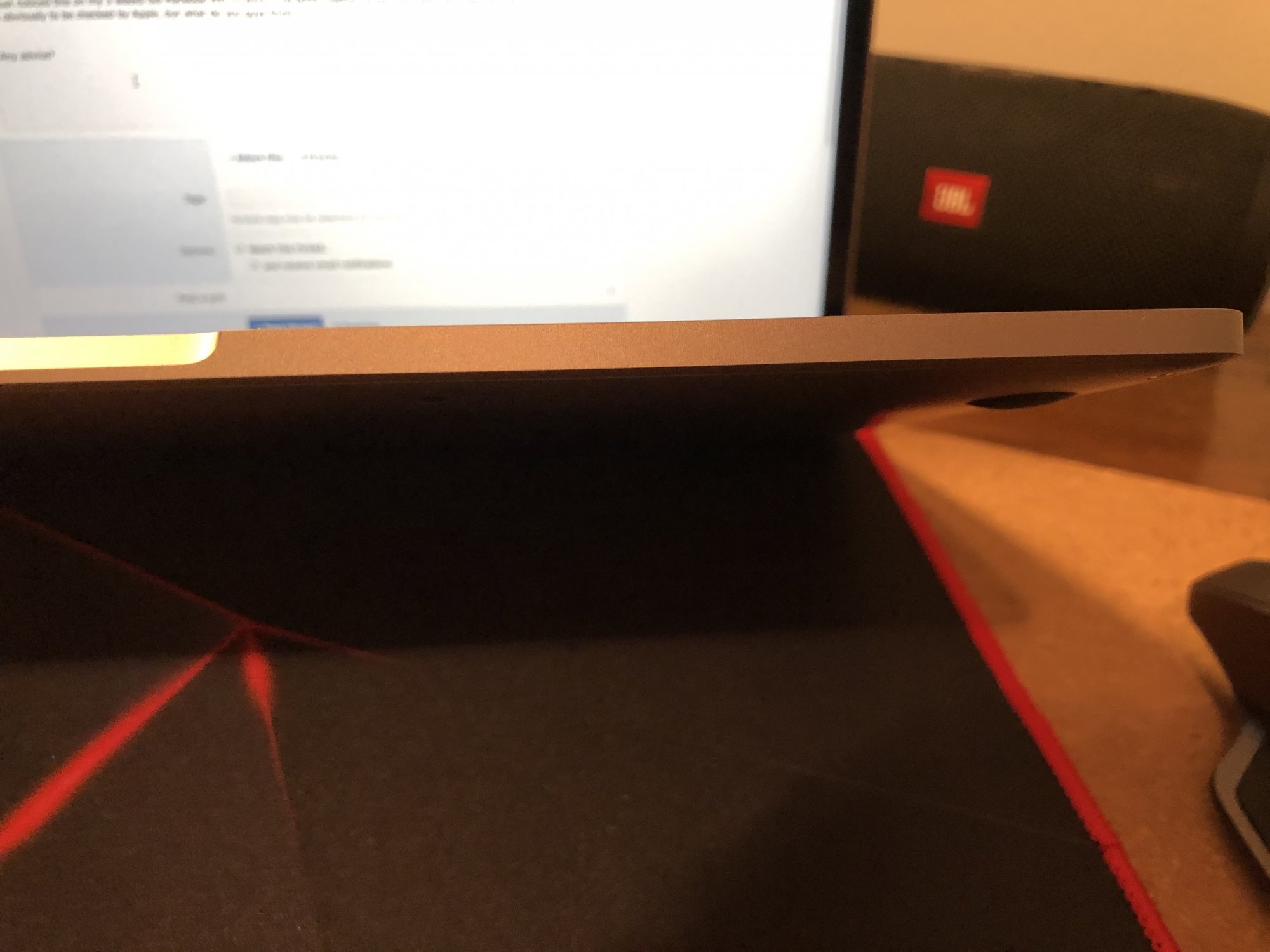

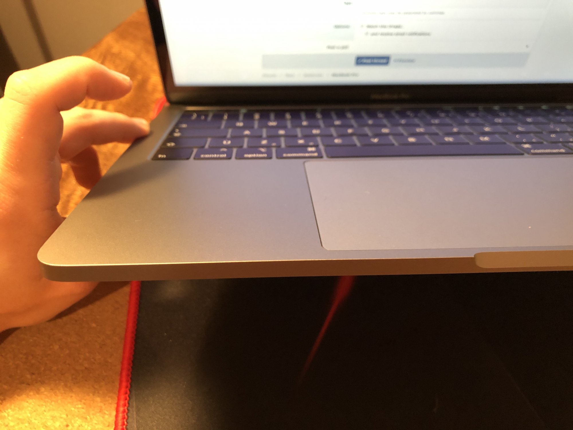

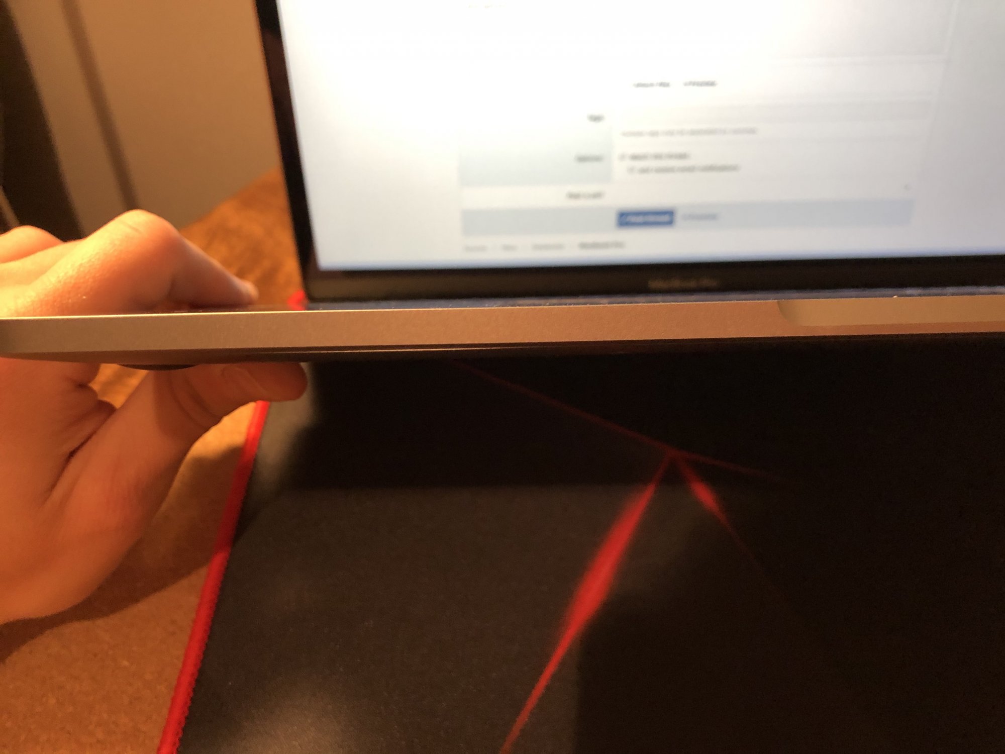

Hi,
I just noticed this on my 3 weeks old MacBook Pro 13 2019 2 TB ports. Seems to me this might be a swollen battery. I will bring it in obviously to be checked by Apple, but what do you guys think ?
The computer has been making little creaking noise coming from the top/bottom case while it's being handled open.
Any advice?

Be polite about this and speak to the Manager of the store. They could give you a new one being that this is only three weeks old.

Looks like battery has aged pretty fast, if I understand correctly, it was not like that new?
Have you noticed any other warning signs of battery problems like low battery run time, battery getting hot, uneven trackpad (is the height difference to chassis even in all edges) or palm rest area bulging? What does battery health say? Is it Simplo or DSY battery (CoconutBattery app shows battery brand)? I bet it is the first one.
I noticed with my MBP 2019 (2TB) that battery is aging pretty fast because run times on battery are already much lower but I have already 37 charge cycles. I haven't noticed any bottom plate swelling yet, but my trackpad is uneven (but it was like that when it was new, so must be installed wrong or perhaps battery was tiny bit malformed on the upper side when it was installed).
I doubt it's the battery, it's just poor fitment/seating of the lower case. Sometimes they don't sit perfectly flush for no real reason other than manufacturing variability, being mass produced.

I don't think it was, I am a bit mental with this thing. So it is something that I would have noticed out of the box. It seems it developed in 1 or 2 days. The laptop is not getting hot when used, but the top case does get hot while charging. Charging Time is quite short, akin to fast charging. No bulge on the top case, trackpad etc..
