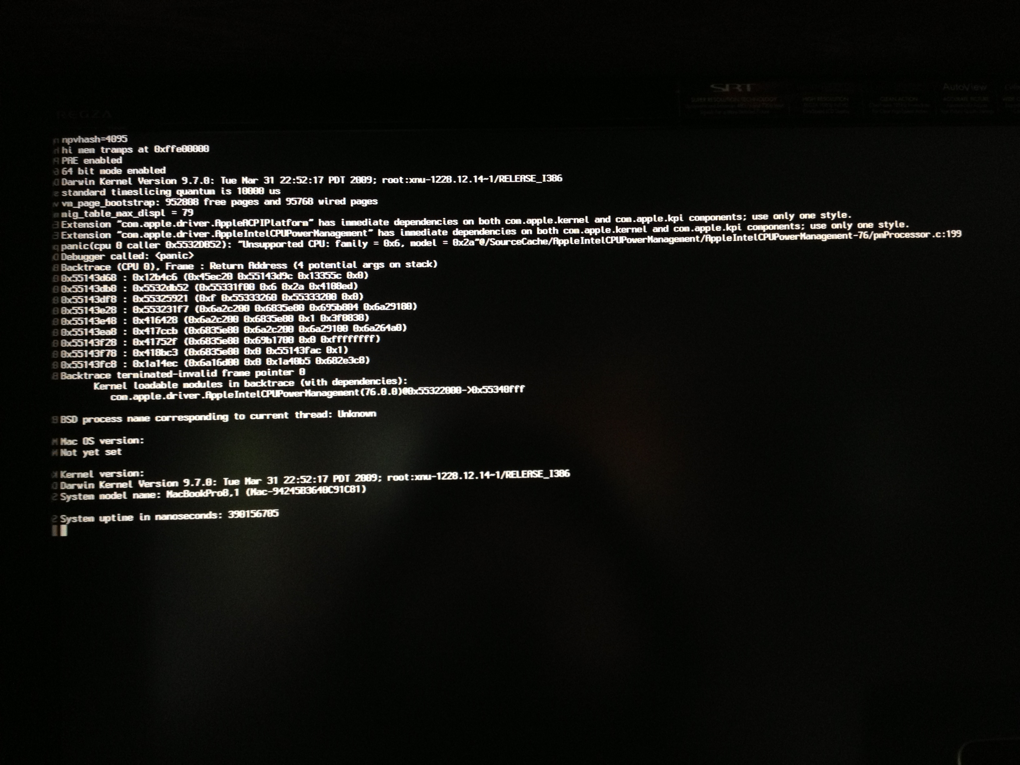

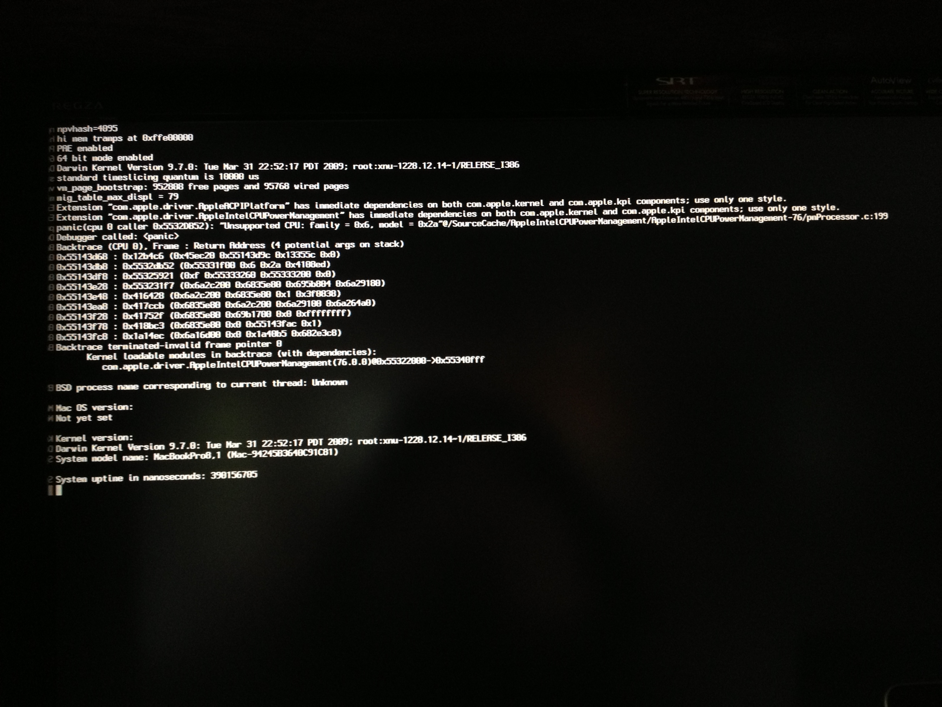

I think something is wrong with my LCD - it works intermittently. Anyway, I plugged the macbook back into the external display and for funsies - I reset the pram/smc again. NOW, I still get the boot chime and white screen BUT, if I try and boot into the (replaced) HDD, I get an error (see the first picture I attached). If I hold Option and try to boot into the Install USB (the partition chooser does come up to select Macbook HDD or USB), I get a kernel panic (see second picture). Edited: second picture didn't upload - here's an imgur link instead: http://i.imgur.com/wKMXrPz.jpg
I think part of the reason is that this new HDD was actually from my old Macbook which was a 32-bit architecture running leopard. So I'm sure the first image error has to deal with that "Unsupported CPU Family...". But the Install USB - I don't know why that would be crashing.

Analyzing Mac's boot sequence and signals, no progress after chime means it
can't find boot.efi, otherwise you'd see the bitten apple on that white screen.
http://support.apple.com/kb/HT2674
It appears you're right. Thanks for that link. However, I've gotten a little further with this issue (I'm just going to copy/paste my response from my previous comment):

The attached picture (black screen) is what happens when I boot into the HDD - Which wasn't faulty when I replaced it but DID come from a macbook a1181 (leopard with 32-bit). But i'm not sure why I'm getting a kernel panic when booting from a SL install USB (image here http://i.imgur.com/wKMXrPz.jpg). I should be able to boot into that no problem and wipe/reformat the old HDD and install SL on it... I have my lion install esd, too, but would have to remake the USB key for it. Willing to try it, just at a loss right now!
Well, swapped HDD's again - this time to an HDD running ML that from a 64 bit macbook. This time, no panics. BUT, still went DING to a white screen. Tried running AHT (internet based). Starts loading, then I got "apple.com/support -5010D" Doing some googling looks like it's an internet problem. Popped her back open and it looks like the antenna to the wifi card is broken (the cable is still connected to the port, but the port is no longer on the board... FML.
